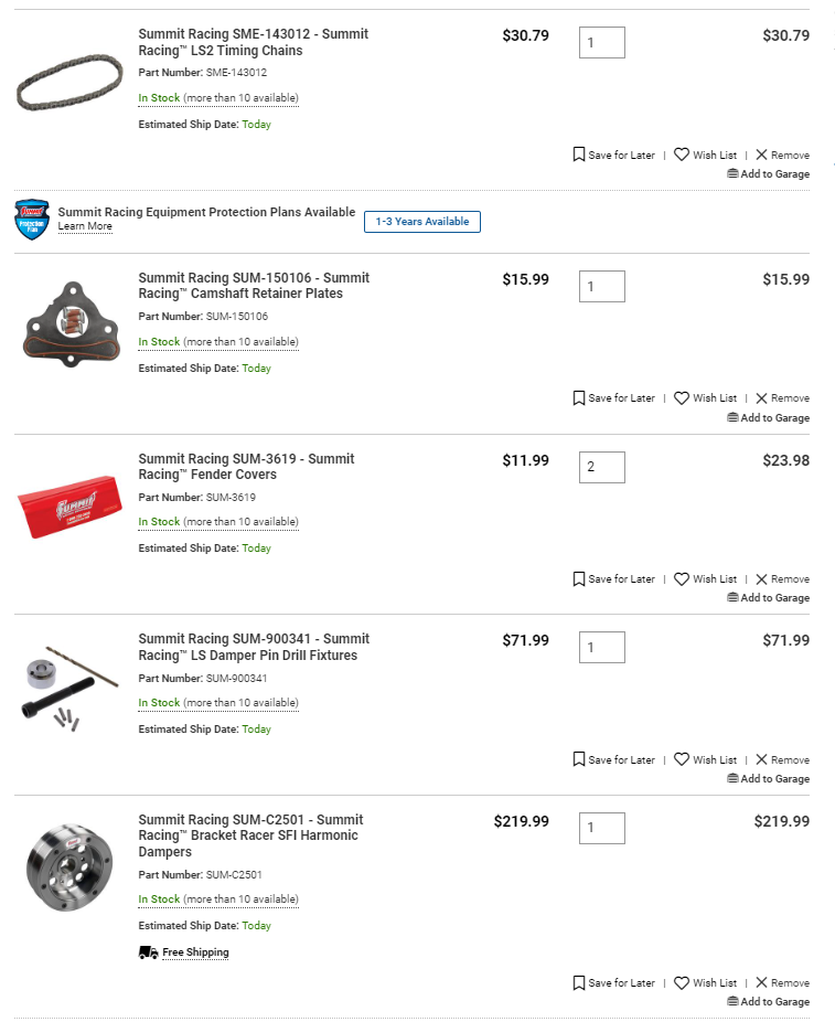

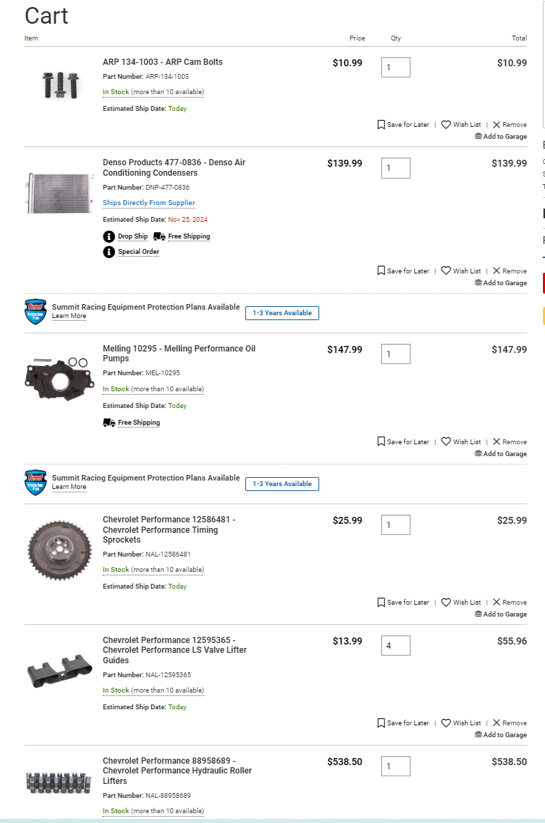

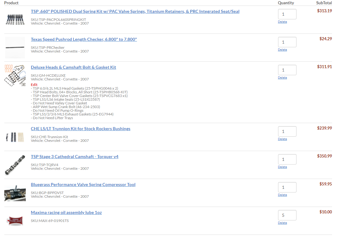

Thanks for the info, I will order the cam gear and just send it back if I don't need it. Here is my parts list, I will order the push rods once I take the measurement, I might also add the Mamo ported FAST 102 to it before I tow it 3.5 hours to SLC for the dyno. Currently has a Corsa CAI, Speed Engineering Headers and X pipe going to ATAK mufflers, and a Mamo ported LS2 throttle body.
I'm replacing the A/C condenser since it is leaking onto the ground.
I also don't know that I will need to pull the valley cover, is that something that needs to come off for this?

Looks like a good parts list.
Not a bad idea to add some water pump gaskets and front cover gasket just in case. Also, a good idea to replace the front cover balancer seal if that isn't in your list of parts.
Also, I am a big fan of the BTR shaft rocker system. I installed this on my LS3. They do make a version for the LS1/LS2 and it is not much more expensive than the CHE kits: BTR Shaft Rocker Kit

All of those gaskets and seals come standard with the TSP kit, and I added an AC Delco timing chain damper to my Summit cart, thank you for that. As for the BTR shaft rocker kit, I will look into that more but will likely wait until next year to do it, if the motor is still happy after next summer I will most likely send my heads to TSP for a port job and throw an A&A kit on it, I will probably wait until then to do the intake too since that is nearly as much as I'm spending for all the parts I'm about to put into it..
Can you tell me if I will need to pull the valley cover? I saw the option for a new gasket for that in the TSP kit but I thought that was only if you had DOD and were deleting it.

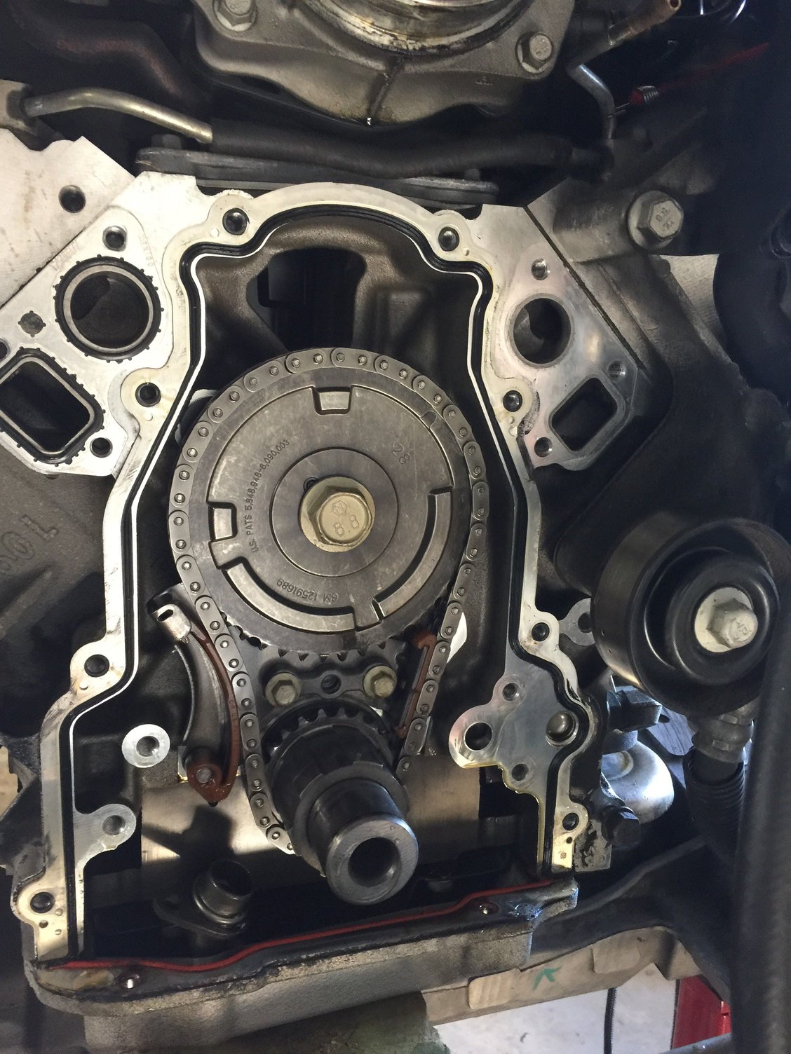

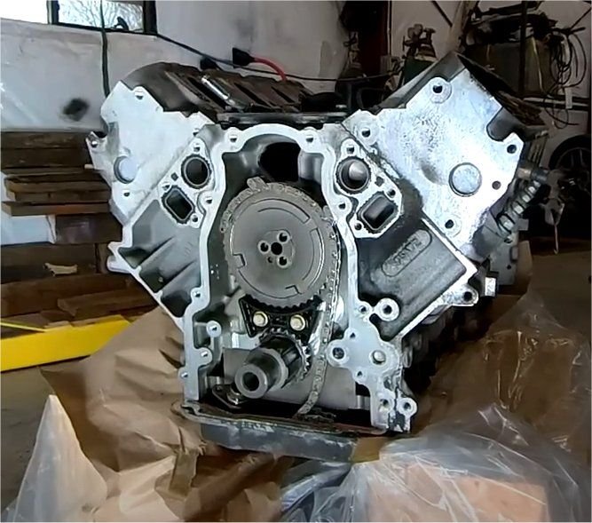

a clients 2006 had 3 bolt, my 2007 had 1 bolt. Both had the 4x sprocket. The 2006 had the simple 1-piece belt tensioner, my 2007 had the wonky ratchety design.
I have this documented so I'm 100% sure

2007 Manual LS2
2006 Manual LS2

I would recommend then to also order the LS2 style of dampener just in case you have the LS3 style of tensioner which being a 2007, you likely do. The LS3 style of tensioner is not as robust as the LS2 dampener.
Also, seeing the oil pick up tube in the above picture, I would also recommend the Improved Racing Oil Pickup Tube brace: LS Engine Oil Pump Pickup Tube Brace / Clamp

My 07 Manual had a 1 bolt as well. I was confused about this issue and just waited until I got the timing cover off before ordering a chain and gear during a cam swap.
Thanks for this, I have the one piece damper in my Summit cart now. The one piece should be a direct bolt up without any adaptors correct?
2007 Manual LS2
2006 Manual LS2
Thank you for these photos, this helps a lot!
