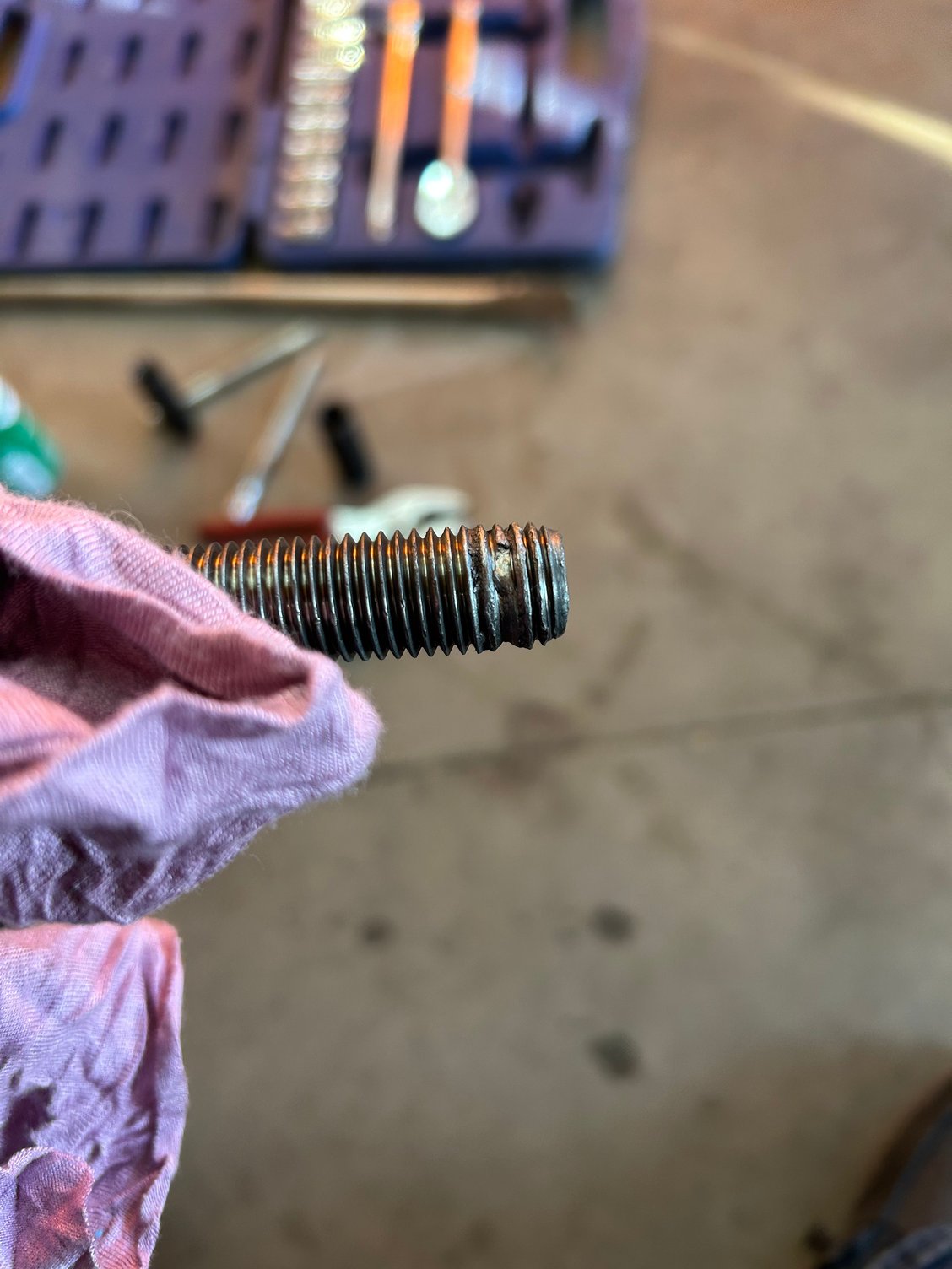

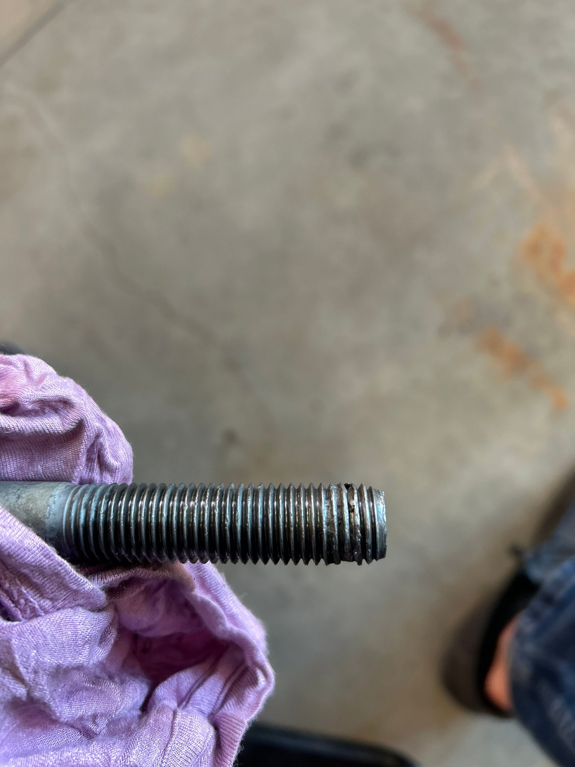

Hey everyone, using a weighted 24mm socket and a battery impact I got it to turn 2-3 revolutions and then it locks up. I feel it might be lock tight but I’m worried about breaking the bolt.

If you got it to turn out 2 to 3 turns, you could try turning it back in all the way and then turning it out again. Doing this a few times should free it up.
i
It’s galled to sh*t

Someone may have used that bolt to install the HB on that car, which is a no-no. A proper installation tool is required. I hope the threads in the crankshaft are still OK.

Get a thread chaser in there if you can. Maybe flush it out first then run a pen / telescoping magnet down there see if you can get a piece out first. Then run new bolt without balancer on it see if goes all the way in.
I bought a tap and die kit and cleaned them up, the new ARP bolt threaded in past where it will seat with the washer by hand.
I did all of that and everything is good.
