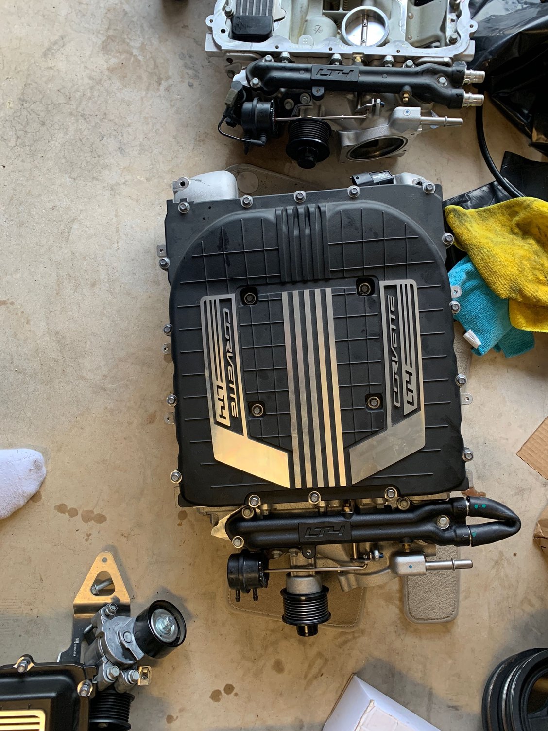

A good friend of mine is pulling his LT4 blower off his 2019 Camaro and I am buying it from him (he's going down the Magnuson path with his Camaro). Because it has a taller lid, what are the best option to modify the blower for the LT1 Stingray (wet sump)?
What have others done with this setup?
I am guessing I will pickup the new blower in a couple weeks and I already have one of the best Corvette mechanics on the planet here in St. Louis, so...should be ready to roll really soon. Truthfully, I think everything is taken care of already, I am just curious so that I can understand what we are getting into.

1. If I buy a 2019 LT4 blower from a Camaro, the taller lid doesn't really fit with the stock hood. What are people doing to address? Are they simply swapping to the shorter lid? Do you have to swap the bricks and the lid? How does it work?
2. Would it be better to keep the taller lid and simply do something else to make it fit?
3. Is it better to just get the shorter lid old style blower?

At this point, I am looking at what it will take to make the LT4 Camaro ZL1 blower work on the Stingray Corvette (also wet sump).
I have ave spoken to several people who say it canít work. Once I get everything together in the next week or two, I will go over the parts to see what it looks like.
1. I see the top blower pulley sticks out about an inch further than the Vette LT4 blower.
2. It seems like with the ATI damper, hub and supercharger pulleys combined, it might line up...but I need to get some pictures and play with the positioning.
if it looks too difficult, I suppose I would really just need to swap the ZL1 blower for the Z06 blower, but I am hoping it really can work out.
Has anyone installed the ZL1 blower on the Wet Sump Stingray?

Who is giving you this info. It's the same blower the bricks are angled are the only difference. The camaro had the exact same LT4 as the z06 there is nothing different besides the the car itself.

Look at the two blowers in the picture. You can see that the first blower has a pulley sticking out well past the intake where as the second does not. The Camaro pulley is just over an inch forward compared to Vette.
The question then is, what parts are needed to get the pulleys to lineup...if using the Camaro blower.
i assume thatís because the Camaro is wet sump vs the Z06 being dry sump?
its interesting, because I think there are several ways to make this work. I am just not certain the options are cost effective. The ATI pulley with a hub would allow the balancer, pulley, hub combo to move forward which might match up. But, I donít yet see how that gets accessories aligned.
It seems to me that the belt line is different between the two blowers.
I can see a custom pulley that gets the Camaro blower back to the Z06 belt line. I could also see the adjustments made on the lower pulley...

That pulley is clearly different. The blowers are the same. The snouts are the same. They fit the same engine. Cheap *** GM wouldn't order 2 separate blowers for the same motor. Again they are the same. The pulley maybe different but that's it. Get a stock pulley and take that one off

Thatís not accurate. You can see the arm leading to the pulley is different. The pulley is the same on these. The Camaro blower is extended just over an inch further forward than the Corvette blower.
Thia was confirmed by ADM, Weapon X and West Michigan...at the same time, I know it can work and I know someone who did it. The question is whether or not there are other ways to make it line up or if many others have done so.
The one I know about used a custom pulley to return to Camaro pulley to the Z06 belt line. I am trying to confirm, but I think he may have also had to modify the intake to accommodate. I am hoping there is an easier way.

Why mess with all that? Bottom line, the Camaro blower pulley spacing IS different and wonít work. Get the correct Z06 blower that lines up properly and move on.
