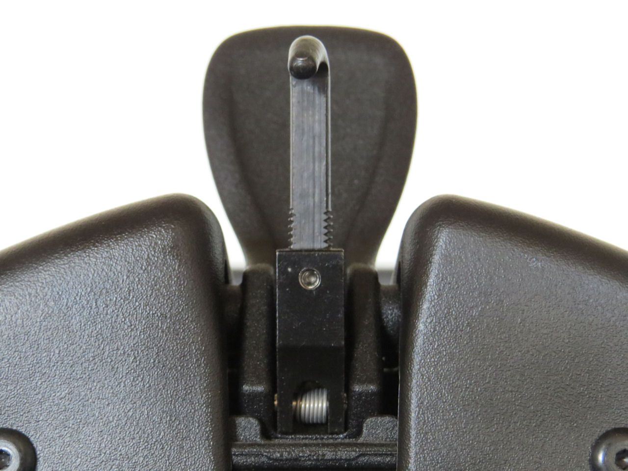

Mine has a very shiny set screw (which uses an allen wrench to tighten) in that slot, so yes you are missing it I would think. Here is a pic of mine...

I did fix my roof , tried some recommended fixes here but none worked, including greasing the pins, strikers and adding 0 rings. What I did find by taking some rubber bicycle inner tube , cutting a small 3/4" piece, then when closing the strikers on the roof together slipped the rubber between the two plastic parts as I closed them together. This binds the two pieces tightly and stops the slipping which leads to the creaking. The roof has not creaked or made any noise since, just finished a 1000km trip over bumpy roads, not a peep.

I had the TSB work completed on 10/20. No noise at all since the repair was completed...first time the roof has been silent in months...
Here are a few pics from the install. Thanks to Corvette specialist Chuck Metts from Coughlin Chevrolet for allowing me to watch the install.
-M
New latch!
New front pins!
Old latches
Paperwork!

I have an appointment next Tuesday to repair mine. The dealer ordered from the parts list I provided via email, that document came from this thread, no need to take the car in up front.
The rubber tubing placed between the two pieces of the striker catch has worked extremely well for me so if for some reason this doesn't fix it I will just go back to putting the rubber between the left and right catches. It's just a small piece of rubber but it seems to stop the slipping between the two pieces which generates the noise as it move and slides when going over bumps.
