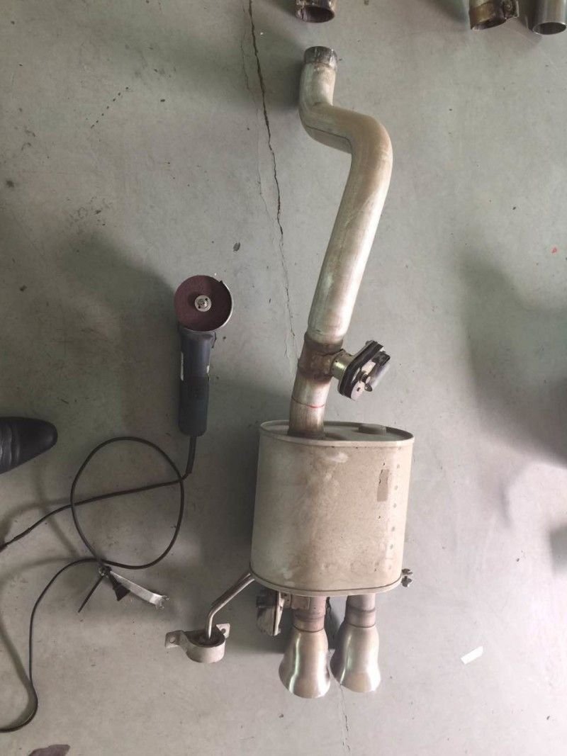

SO the muffler on the picture should comes from a With NPP System Corvette C7 right?
Yes, the pictured exhaust is an NPP exhaust. The valve on the upstream (engine) side is the AFM valve. The NPP valve is on the exhaust tip and when it is open it creates a more direct/less restricted path through the muffler.
