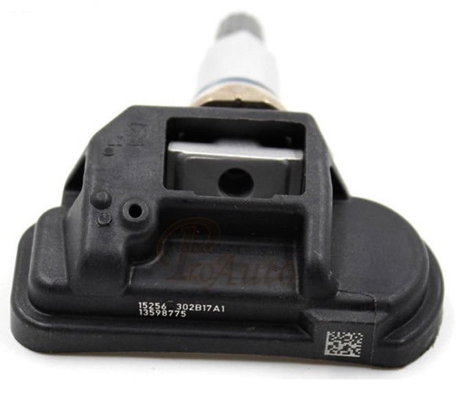

All you need to check before you install a new set of tire pressure sensors is to make sure they are the proper GM Part#.
For some reason the part# for the sensor was changed for 2016, but GM does that on a regular basis for lots of parts.
Either part# sensor will work perfectly in any model year C7.
Part# for the early sensor is 13581560 and it was superseded by 13598775
Either sensor will work and will auto-learn in all C7 model years - no TPMS tool is required.
You can see the part# is printed right on the sensor:
