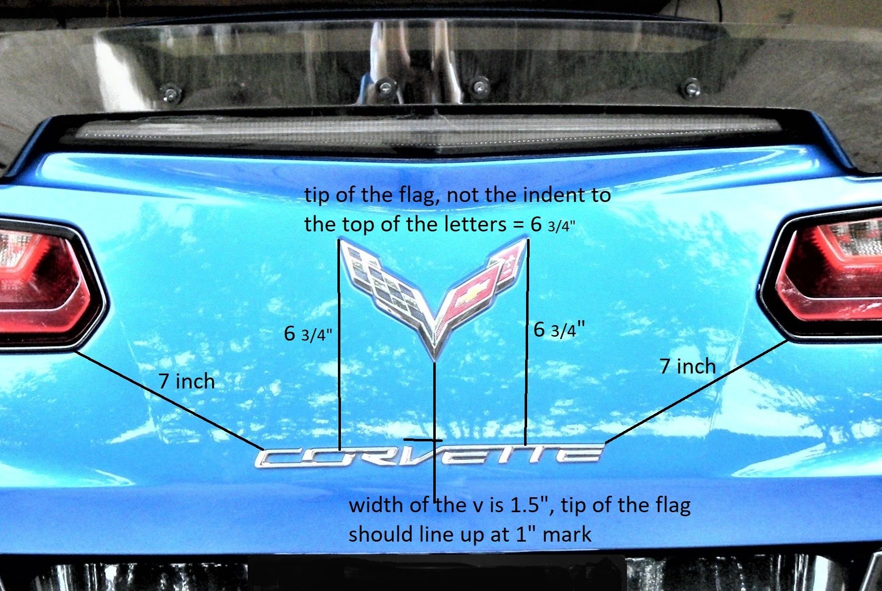

I tried searching but came up empty. When I got my 2015 C7, someone had already removed the rear Corvette script badge and nicked up the bumper in the process. I ordered a Carbon Flash one but want to put it in the factory location. Does anyone have a template or the specs of where it goes so I don't have to just "eyeball" it? TIA

Don't have a template but did a measurement. Hopes this helps...

Thanks for the measurements. Sure to help someone and I saved the pic just in case I have a future need.

I just used blue painters tape to mark the locations before I removed the originals when I swapped them out for carbon flash.
Blu-Beast - Great pic and measurements

Exactly what I was looking for- thank you!

I went to dealer lot and used paper to create one for mine.
