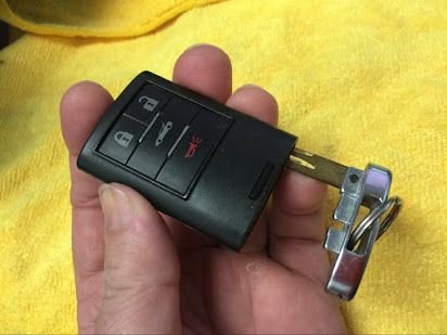

Key fob and the button and the rear button won’t open the trunk.

Use the key located inside the fob to open the trunk.

Thanks!!! I didn't realize that the key opens the trunk. Great to know!!!
