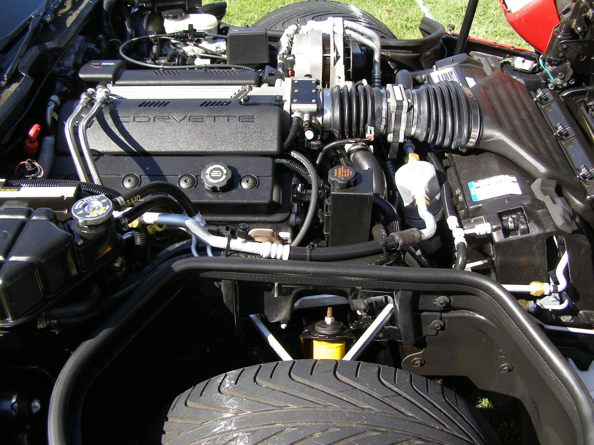

When, i got my C4 engine cleaned, I took it to the dealer. Mainly, because I did not want to take a chance with getting water into Optispark.
I figured, if they screwed anything up, they would have to make it right.
They did a great job and after that all I had to do was occasionally use a can of compressed air and a rag to get the dust off.
I got a lot of compliments at car shows on how clean the engine looked. Here it is at the Redline Corvette Car Show.
It took First Place! Not bad for a 1995 with 84,000 miles on it.

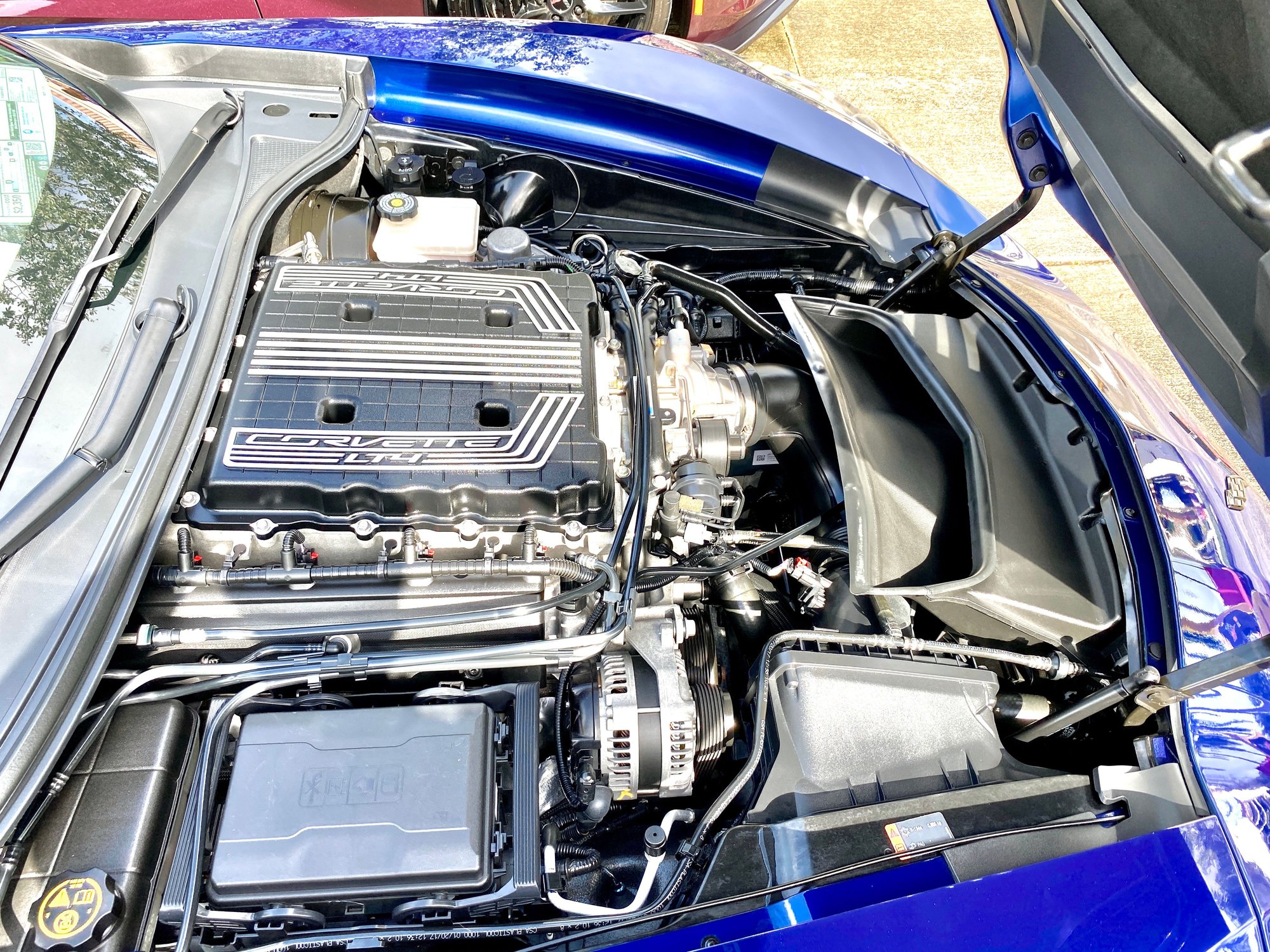

I have a C7Z. I cover the alternator with a plastic bag.
I use a pressure washer to blast all the contaminants before I start spraying chemicals. My Kranzle puts out about 1000 psi and 2 gallons per minute. Staying under 1500 psi is crucial. I have a mosmatic gun attachment and a 4.0 40 degree orifice to keep the pressure steady and focused Trick is to keep it moving. Don’t hover over a section for more than 10 seconds.
next Superclean at 3:1 with an array of detailing brushes- boars hair and even speed master wheel barrel brushes. Careful not to poke around too much and loosen hoses and fittings. You can also use Optimum Powerclean and CarPro Multi-X anywhere from 3 or 5 to 1
blast off with pressure washer again to remove Superclean.
while wet douce the entire compartment with megs hyper dressing at 5 or 4 or 3 to 1 depending on the amount of gloss you want
shut the hood, don’t drive until the next morning. Wake up, pop the hood, admire your handy work.

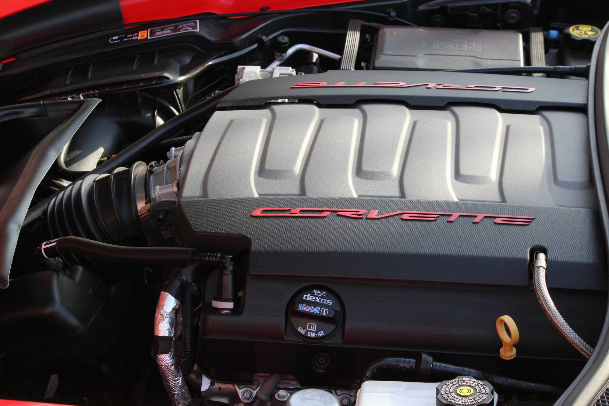

I use Adam waterless wash in small spray bottle and micro fabric cloth. Keep my engine bay clean always , a little OCD.

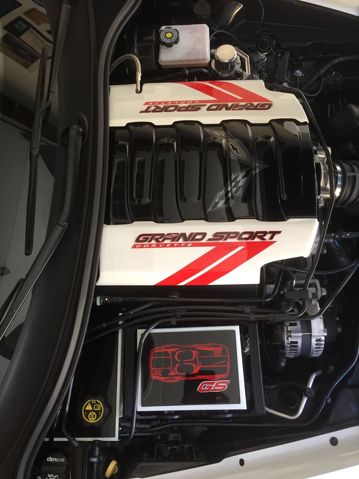

I find that they are more careful and neater when they open the hood and the engine is spotless. It only takes 15 - 20 minutes.
