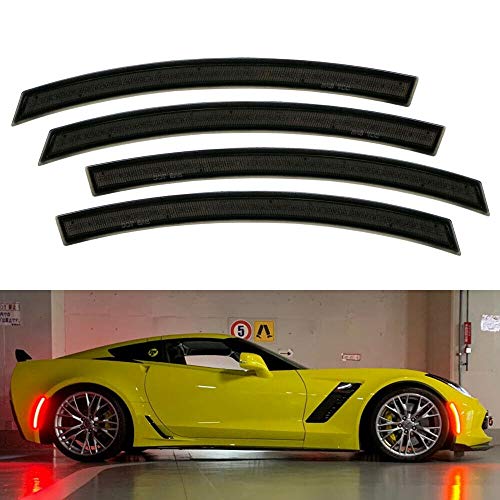

Has anyone installed this type of side marker lights? I saw a couple of cars at Carlisle and they looked real good.
LED Side Marker Lights Smoked Lens 192-SMD Amber Front Red Rear C7 Marker Lights Replace OEM Sidemarker Lamp
I was reading that you need to take the tires off to access the OEM lights. That seems like this is going tobe a pain in the *** install. Any advise would be welcomed.

I cannot tell from your post to what product you refer, but I expect others have installed these particular markers.
The install is easy and absolutely does not require removal of the wheels. There is plenty room in which to work. There are videos on YouTube which illustrate the process and they are here on the forum as well.

By the way, in the front there is a hole underneath the marker lights through which you can put your arm and reach the two bottom tabs of the lights. You can then push out the bottom of the marker and, with a bit of maneuvering, get the top tab to release as well. No tools needed. Then make the connection to the light and push the new one back in.
If you do this and cannot get the top tab to release, open up the front liner just enough to reach the top tab.
By the way, I have a yellow Z06. Replacing the markers makes a significant difference as the red and yellow markers really clash with the yellow. I also enjoy that the markers when on are much brighter than stock. It is a nice effect and I like being seen at night.

No need to remove the wheels to install the side marker lights - just take a few of the screws loose on the fender liners (and remove the splash guards on the rear) and gently pull the liners back to have access to the back of the markers. Three tabs on each marker need to be released and then the markers will pop out. You can then disconnect the electrical connection, reconnect it to the new lights, and pop the lights back in. Then just replace the screws for the fender liner and pop the splash guards back on.
Be aware that some owners have experienced some interference with the TPS system with the LED side markers installed. If you do, you can install some chokes next to the electrical connector - sometimes it works, sometimes not. I have them in mine and it still recently threw a code for the TPS. This only happens when the lights are on.

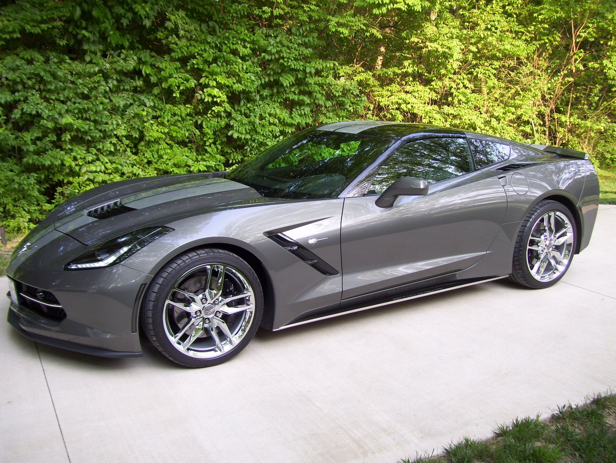

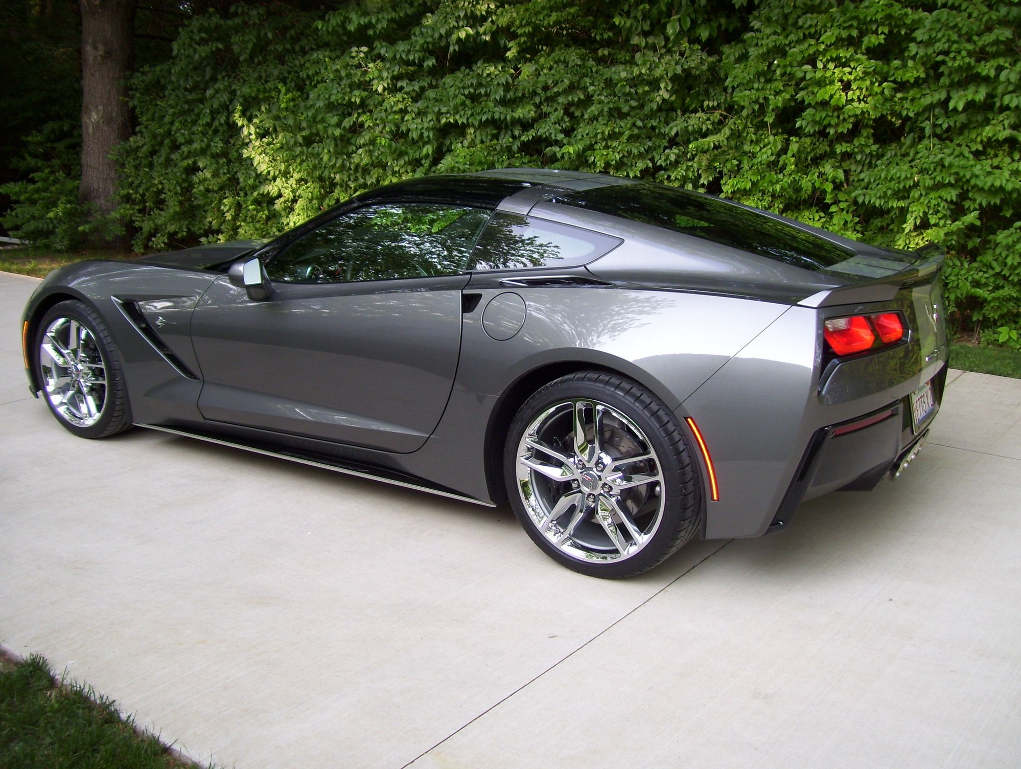

I got the Oracle Color-Matched LED ones and while you technically can do the swap without removing the wheels it's just a lot easier to do without the wheel in the way, unless you have little girly hands.
Old Nov 22, 2020 | 06:25 PM
FLEXjs's Avatar
FLEXjs
Joined: Sep 2018
Posts: 8,277
Likes: 691
Pics:
