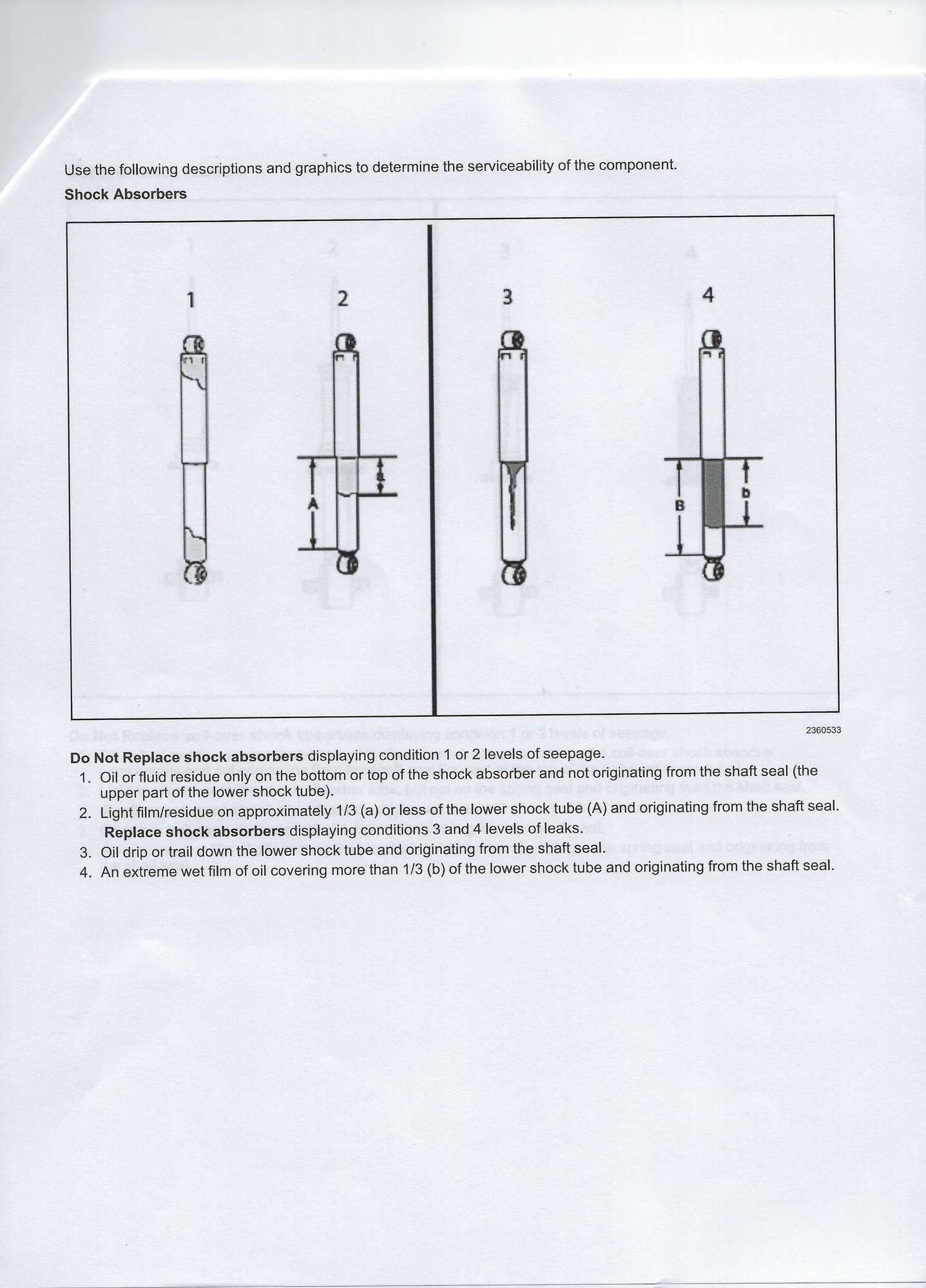

Do you have magnetic ride shocks or standard shocks big difference in price. Rock auto pricing is standard shock 75.00 magnetic ride 317.00. So I would agree to change all shocks at 75.00 but 317.00 I would think twice. That's a lot of money to spend on something that isn't bad. I would ask how he knows they are bad there is some leakage that GM says is acceptable. If it is a little wet at the top 1/4 of the shock that is fine if it is dripping down that is not. There is a picture GM uses I just can't find it. I am guessing with the age of the car and miles they probably are bad just double check with him.

Here's the GM paper about how to evaluate leaking shocks.
Our 2017 Z51 has Mag Ride shocks and all 4 were replaced under warranty at about 20k miles. Two were really bad, the other two were marginal.
(EDIT): These criteria apply to both standard shocks and mag ride shocks.

Seepage or slight staining around the top of the shock is considered normal. Depends on how bad yours are.
