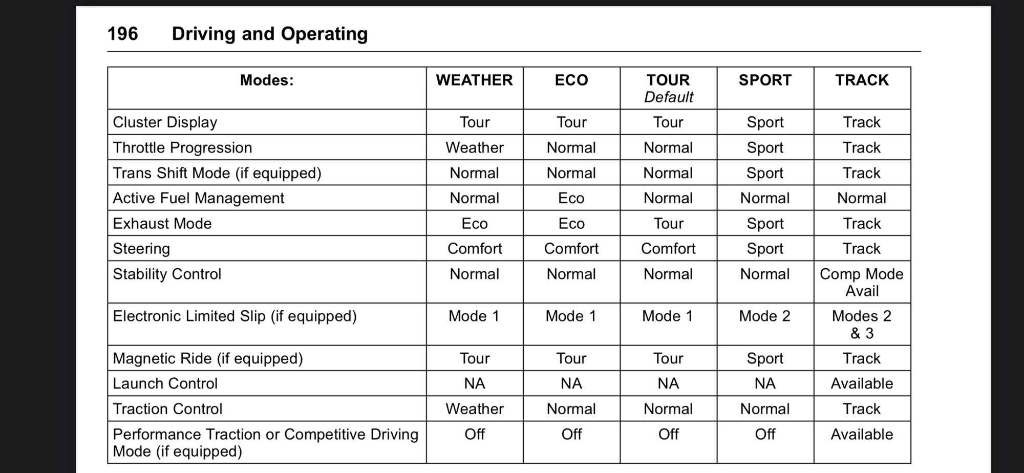

So on a C7, if you don't have NPP what is the selector **** for? Does it change the shift points in an automatic?

Here’s a list of the driving modes and categories they pertain to if you have that feature. Npp is controlled through sound management in the infotainment center, if you have that option.
