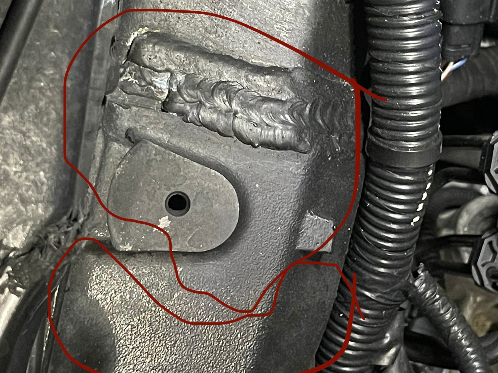

I made a rookie mistake with my purchase.
bought a 2019 corvette gs. I flew from Boston to Washington to buy what should’ve been my dream car.
it was raining and dark when I got to the dealer .They did disclose it was in a minor accident from moving cars around the lot but it was fixed (low speeds 5mph max) the car was in what looked like mint condition drove beautifully and nothing seemed off.

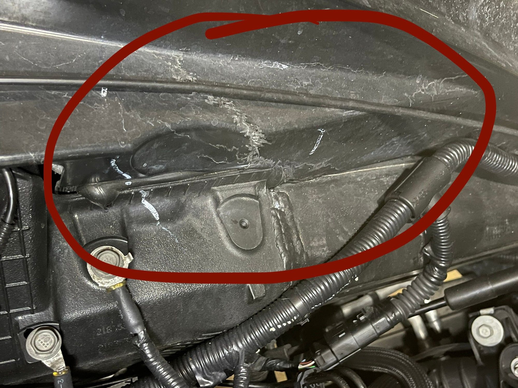

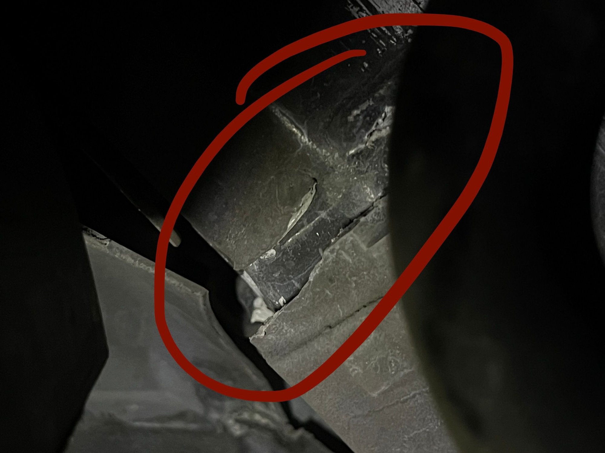

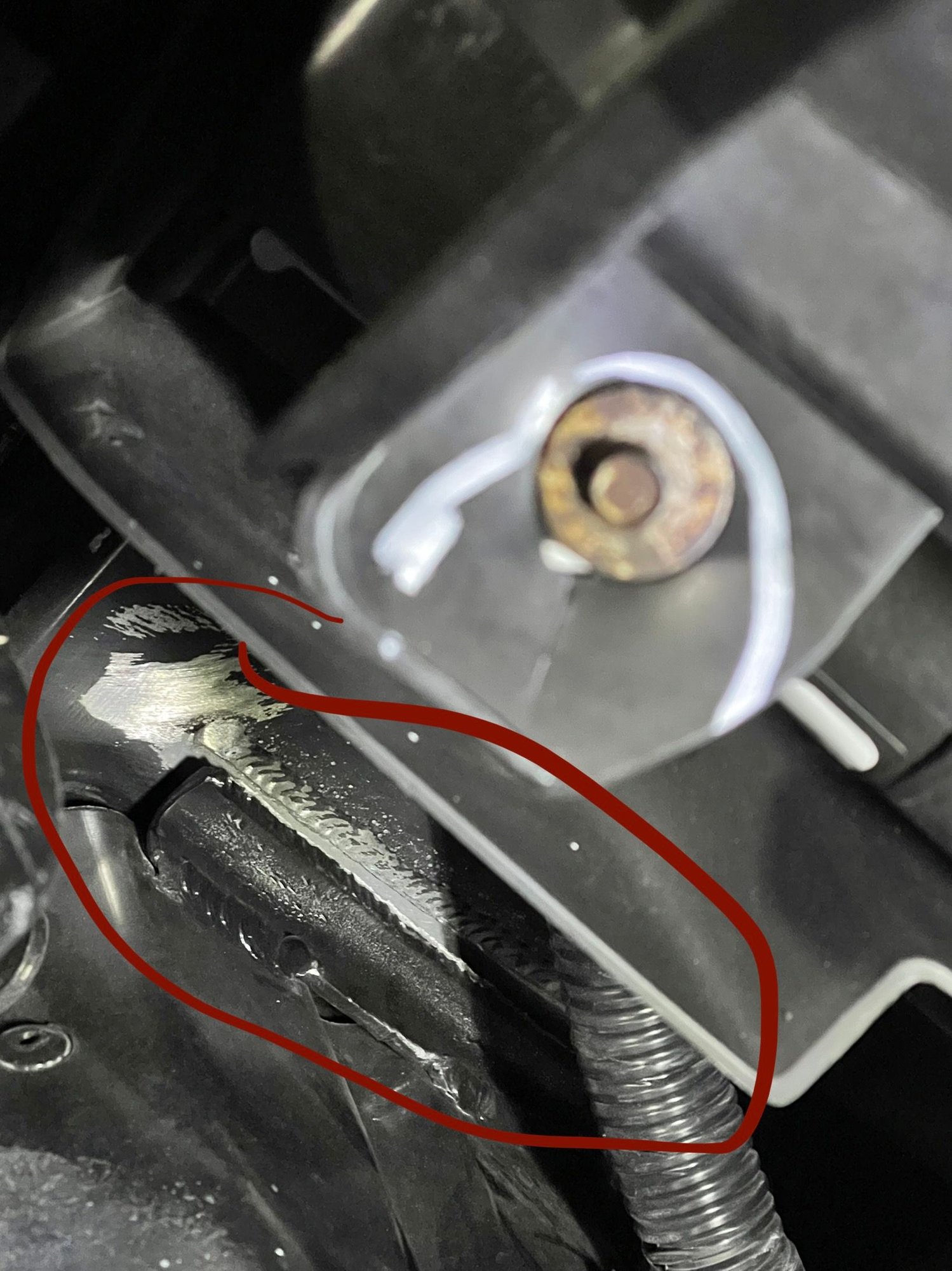

after a few days I notice there is some vibration take the car to get an alignment Chevy tells me the steering column is bad from possible accident. I called the dealer they say they can’t do anything about it so I take my loss and pay for it everything is fine.

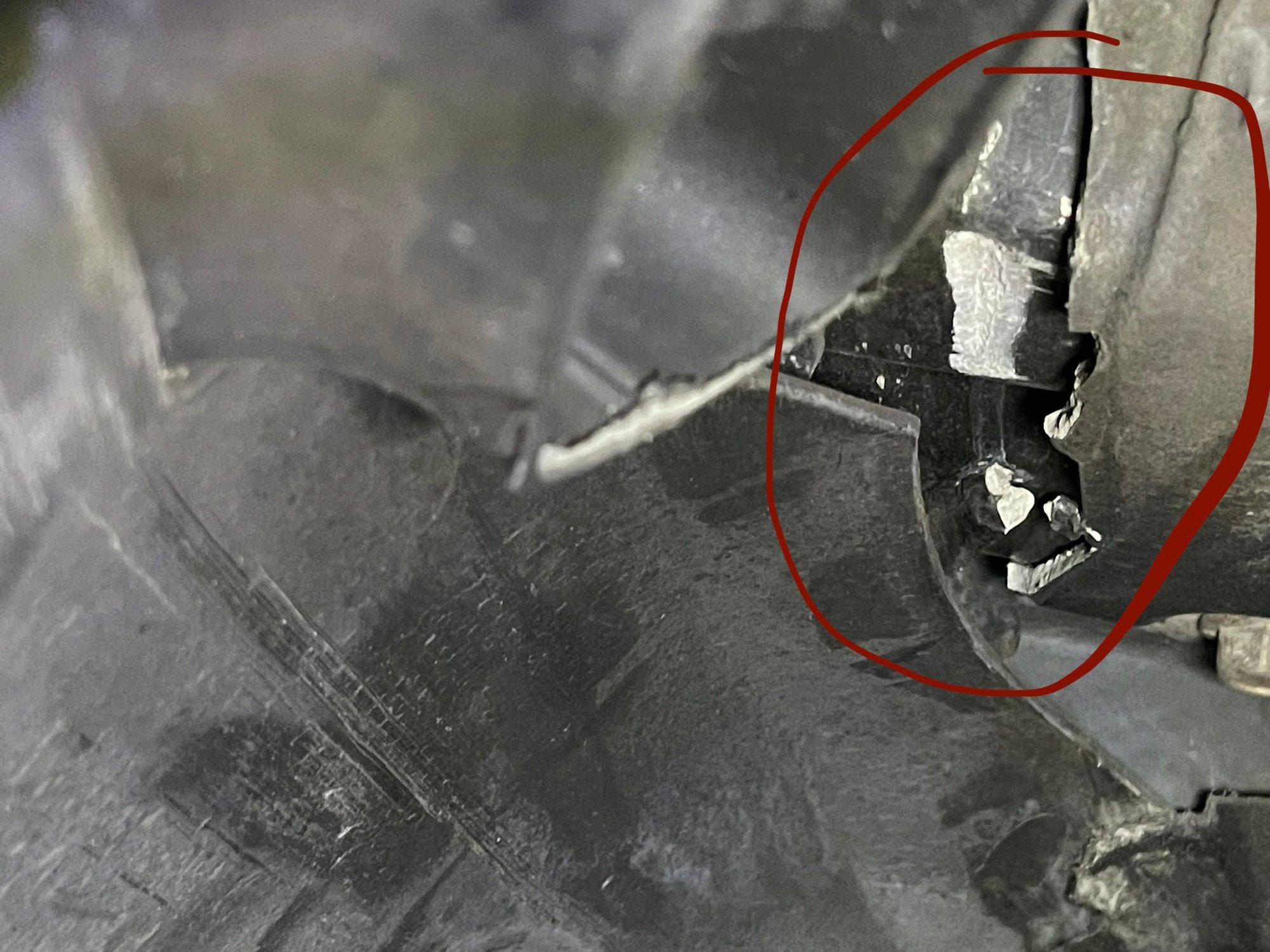

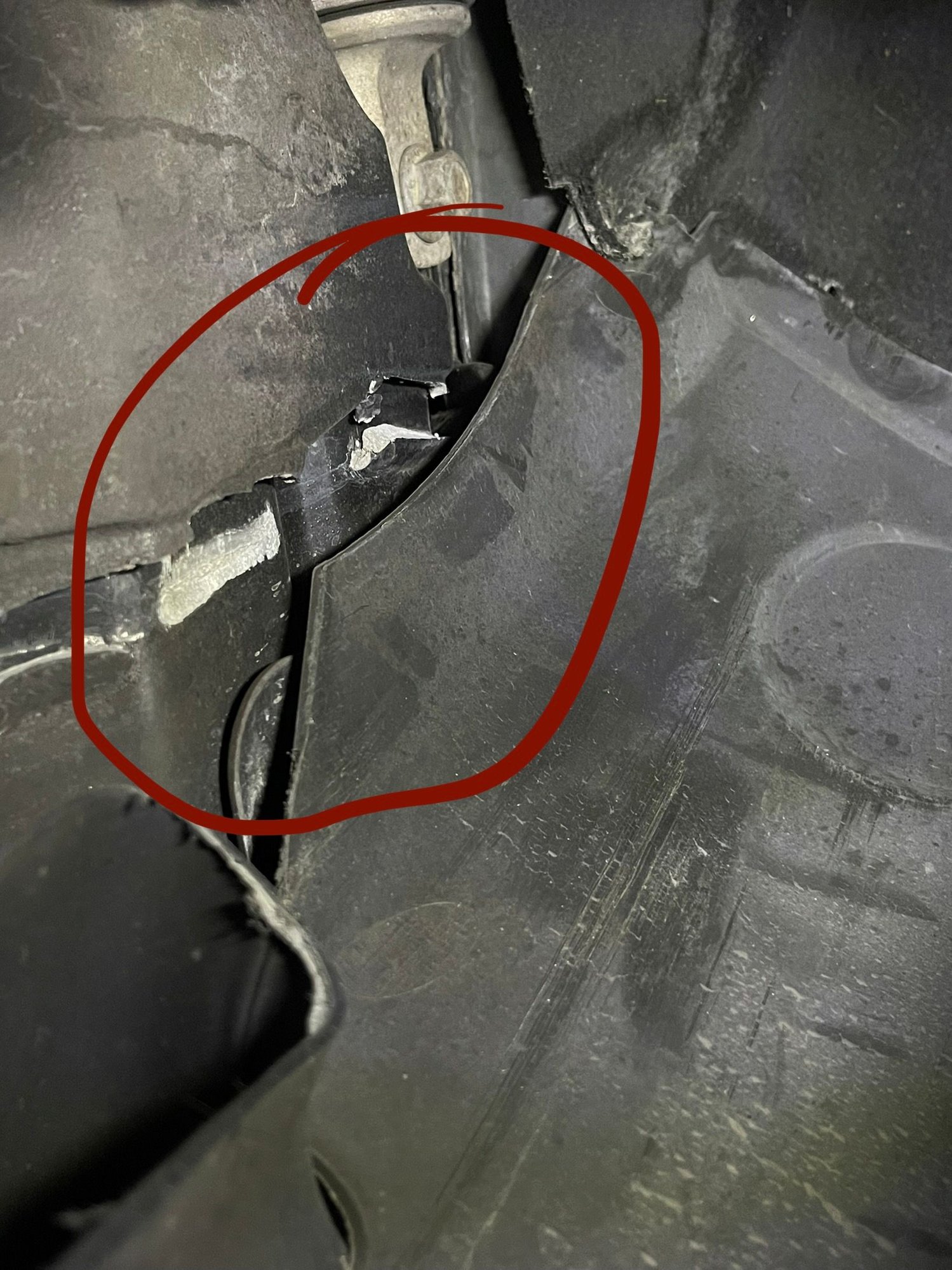

looking in the engine bay I noticed there is a crack on the frame or where there was a connection. Get under the car the crack on that connection goes all the way around on both sides of the frame in the front of the car.
i’m currently in the process of getting the dealership to fix all these problems also have a lawyer involved. But I wanna know if this is fixable I will attach pictures. All the body panels are straight the The bolts that connect the fenders and everything else do align with the holes on the frame everything seems pretty tight and solid besides the driver side front wheel is sticking out more than the passenger side and it is a line to factory specked at the moment.

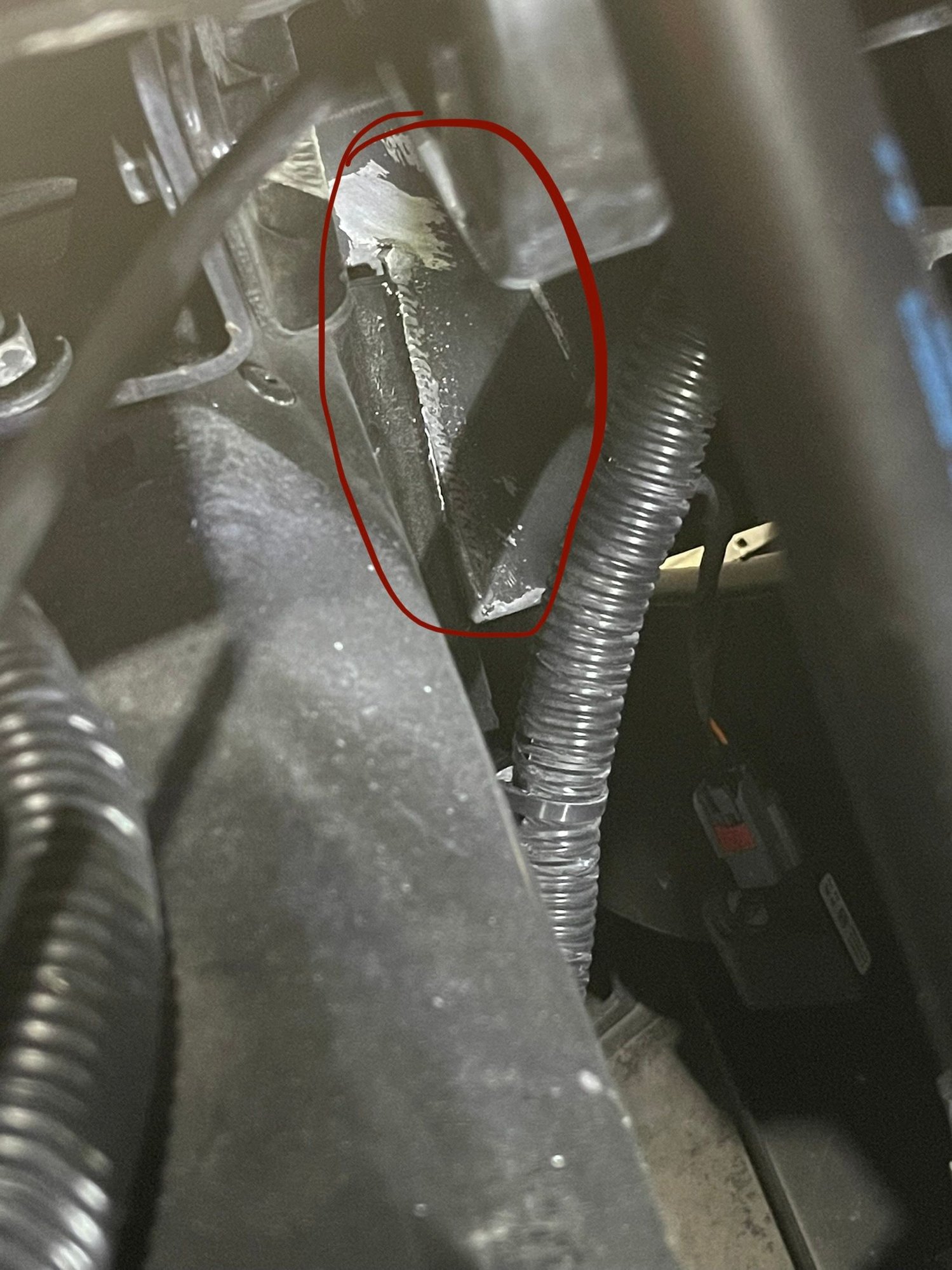

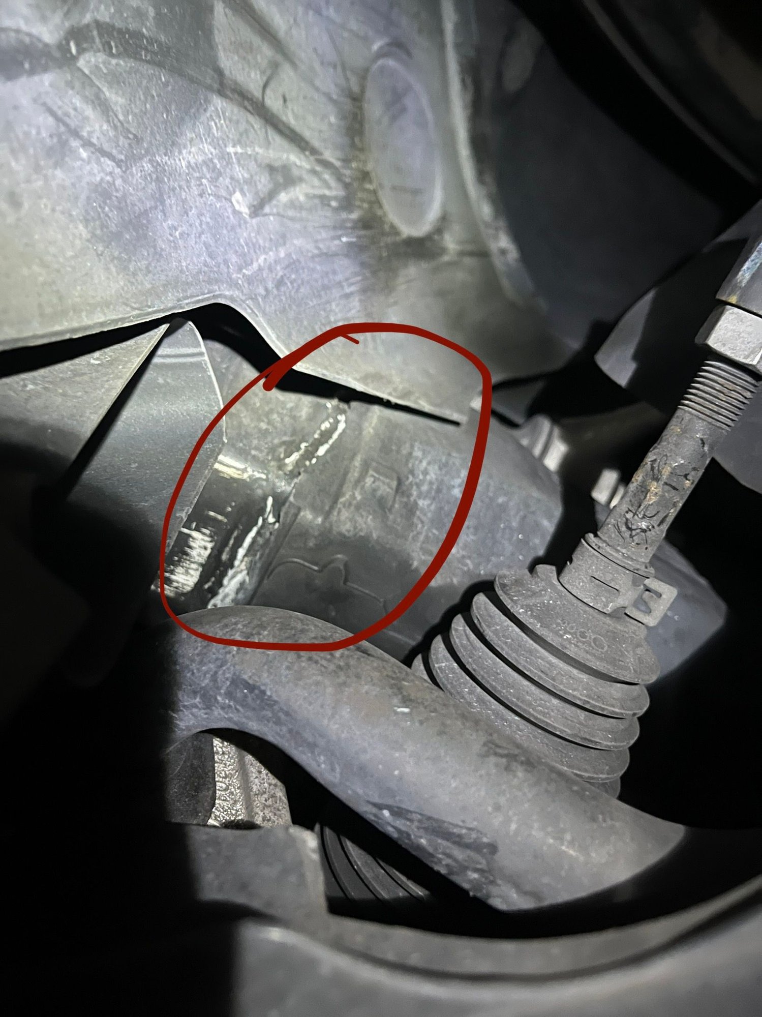

Those front sections of the frame are repairable and also replaceable. However, one picture (#5) seems to show one of the fiberglass panels that hold the fender to the frame is cracked just above the frame. That panel should be replaced as well.
Here is a link to a YouTube channel where a couple of brothers rebuilt a wrecked Z06 about 4 years ago. They talk about the front frame rails being cracked at about the 11-minute mark and in a later video they show how they fixed the problem.
As you can see fixing those problems isn't a big deal as GM designed the frame to be repaired and an experienced body person shouldn't have too much of a challenge doing the repairs.

Ditto this, man I'm so sorry. What a way to destroy a dream. I hope you are able to get a return, the pictures show clearly unrepaired frame and other accident damage. If they represented the car as "repaired" they clearly misrepresented it. It is still badly damaged.

the front of the frame rails are frame horns. they are designed to break so the actual frame doesn't get damaged in a hard collision. heres a few pics of the frame horns being replaced and welded back in. once they are tacked into place its put on a frame jig of square then welded and rechecked for square

I own a body shop. With my on track experience let’s say we have become expert at repairing the C7. Your frame is not broken. It simply broke a weld at a place it is designed to do that. It probably doesn’t need any more than that. Much of what is shown is a broken inner fender which is not structural. This is an easy repair and will be good as new. The seller should pay for it but there is likely nothing malicious. The car will be just fine when this is done.

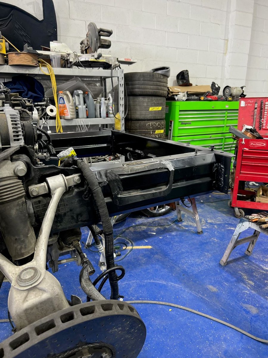

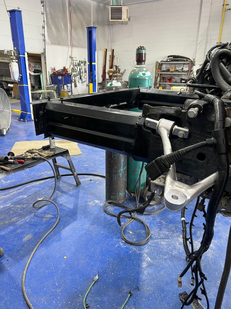

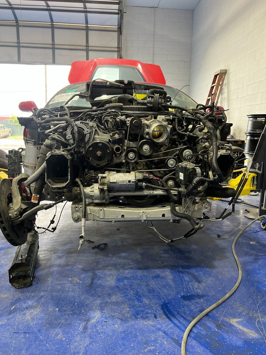

i have an appointment at a corvette auto body to have it looked at and repaired. I’ve taken the bumper fender hood etc off and as shitty as this is the only damage is what is in those photos.
