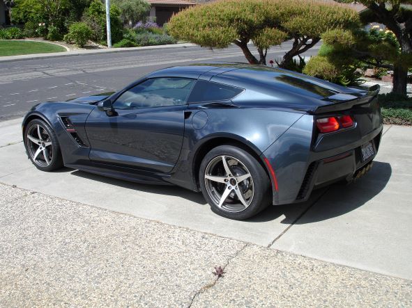

First thing I did was billet wheels.
If you plan on voiding the warranty might as well do it soon as possible.

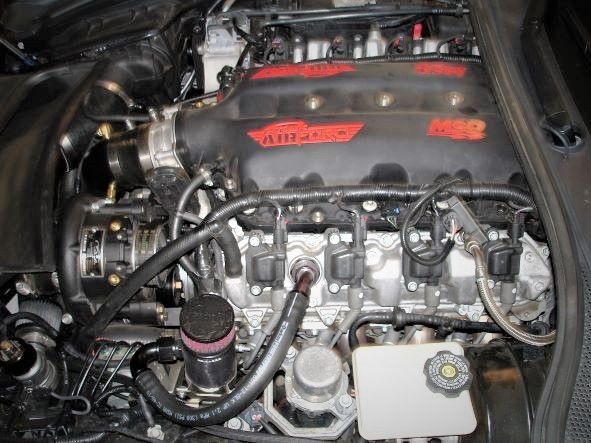

You can just see the blow off valve in the left hand lower corner, just out of the picture is the waste gate. Both set at 7 lbs, dat log shows max of 6 pounds. Engine makes 820+hp/700 at the wheels.
