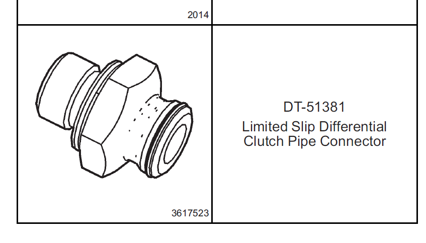

What codes were you seeing? Why do you think the clutch hydraulic circuit needs bleeding? That is where you should be starting. Besides a GM MDI2 scan tool that is used on all GM vehicles the only other tool the needed to bleed the clutch hydraulic circuit is this pipe connector:
DT-51381 ELSD Coupler Release Tool
The air must be bled from the Electronic Limited Slip Differential whenever a component is separated or there is a performance issue. A scan tool operates the ELSD pump motor, but the air bleed must be verified, and the hose connections will not allow fluid to pass unless connected to a mating fitting. DT-51381 allows the pressure hose from the pump to the RDM to pass fluid into an approved container, while the ELSD pump operates to purge air from the system. DT-51381 attaches to the RDM end of the pressure hose, and the pump is run per the published bleeding procedure to verify fluid flow and air purge.
This should have been included in the required tools package the dealer received from GM. If they didn't have it they should be able to borrow it from GM.

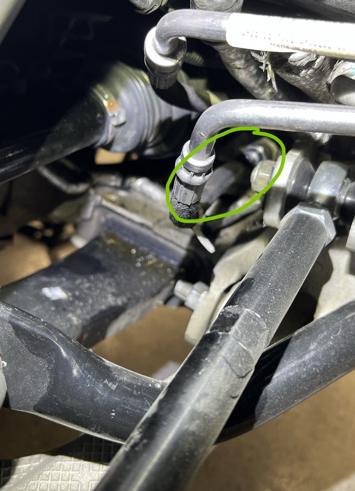

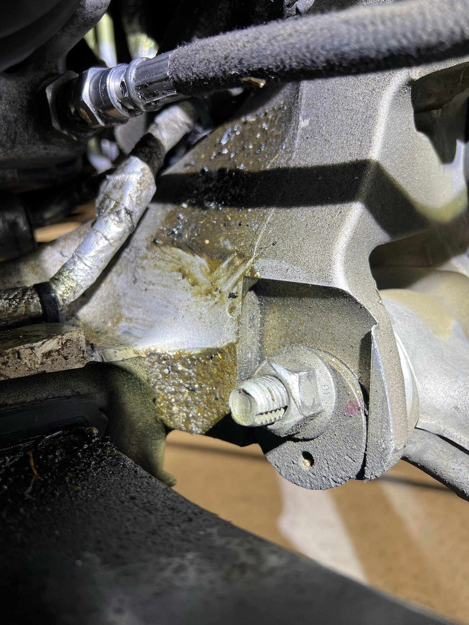

Anyone know how to release the hose connections? I have a hose that's leaking and I want to make sure I understand how it comes apart before doing anything. The pic below is after I wiped the gunk off. It was covered. The axle boot is bone dry, so it's not axle grease.
