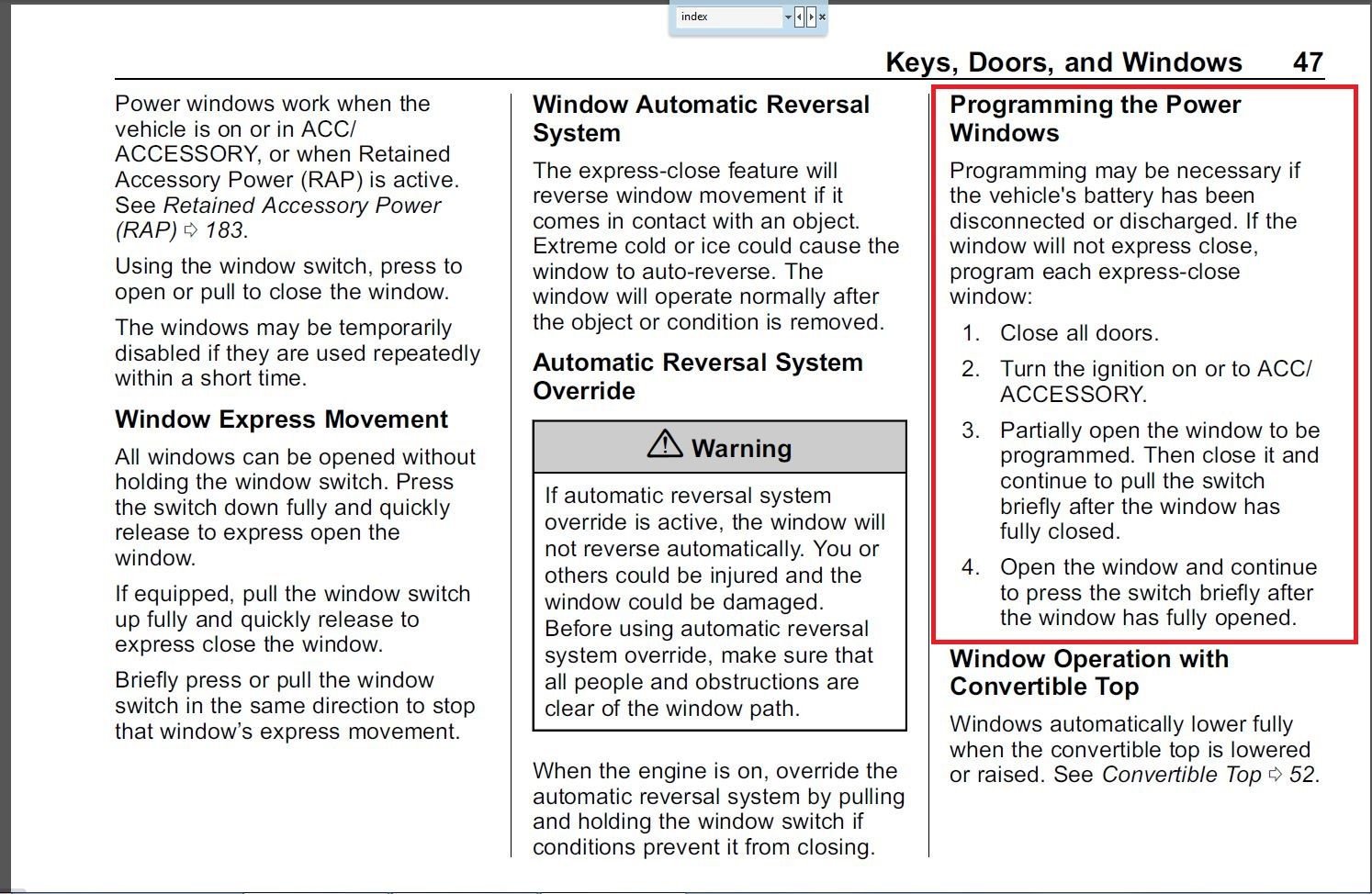

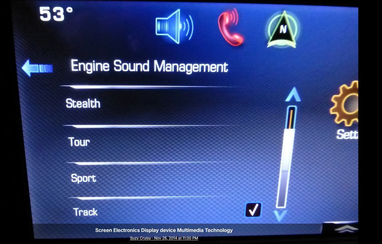

That sounds like you lost 12V power and it wants you to index your windows. Not sure about the menu issues. I set mine to track and never go in there again.
Scroll down for Track.

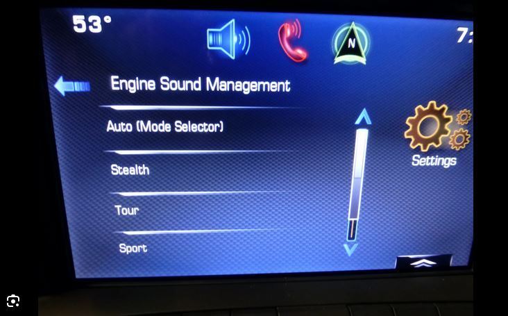

Try deselecting that check box. It might need to be deselected to get to the other menu I showed above. You don't want it to follow the mode selector. You want it always in Track. I set my steering always to Sport. I think that's what you want as well. I included one more screen below. I believe this should appear after you deselect the "Auto (Mode Selector)".
I also found the below thread that says 2014 models only have Auto and Off but I'm not 100% sure about that. I never had a 2014. My 2015 has all the modes available. Apparently the Off setting is the same as Track so maybe try that to see if it works.

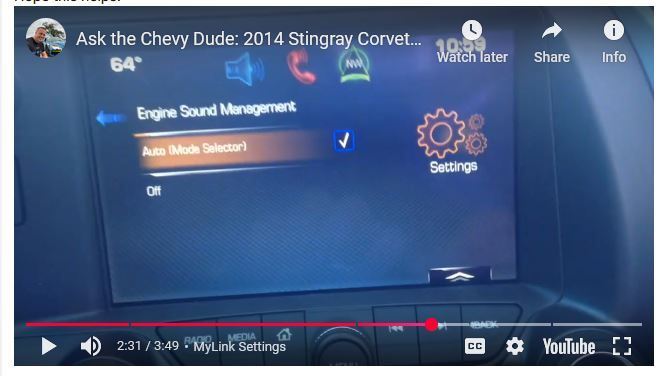

Yes, the 2014 only has Auto and off. At least that’s all mine has.

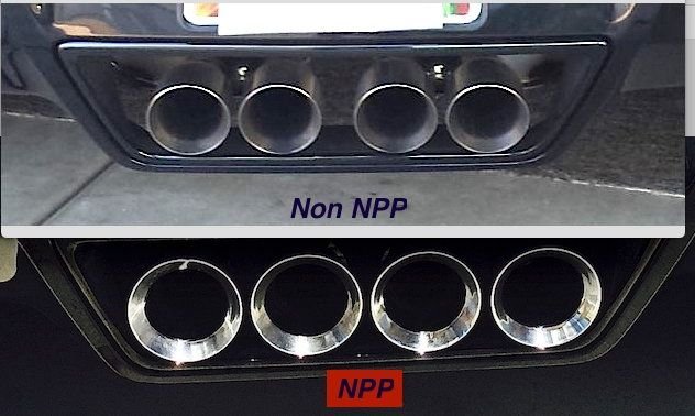

npp was an option in 2014, not all were equipped!!

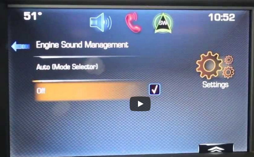

OP, just select "Off" and you'll have Track sound mode. Enjoy.

Damn dude, we already told you. The 2014 model year cars with the NPP exhaust do Not have all the modes. The NPP modes started in Model Year 2015. 2014 basically has on/off. If the car didn't have NPP the exhaust tips would look different and the car would be very quiet all the time.

People make this way too hard. It's "Auto" or it's "Off" in the Engine Sound Management (ESM) menu on the 2014 cars. "Auto" follows the mode selector on the center console. "Off" = Track mode all the time. Starting in 2015 is when Chevy added the modes to the ESM menu.
