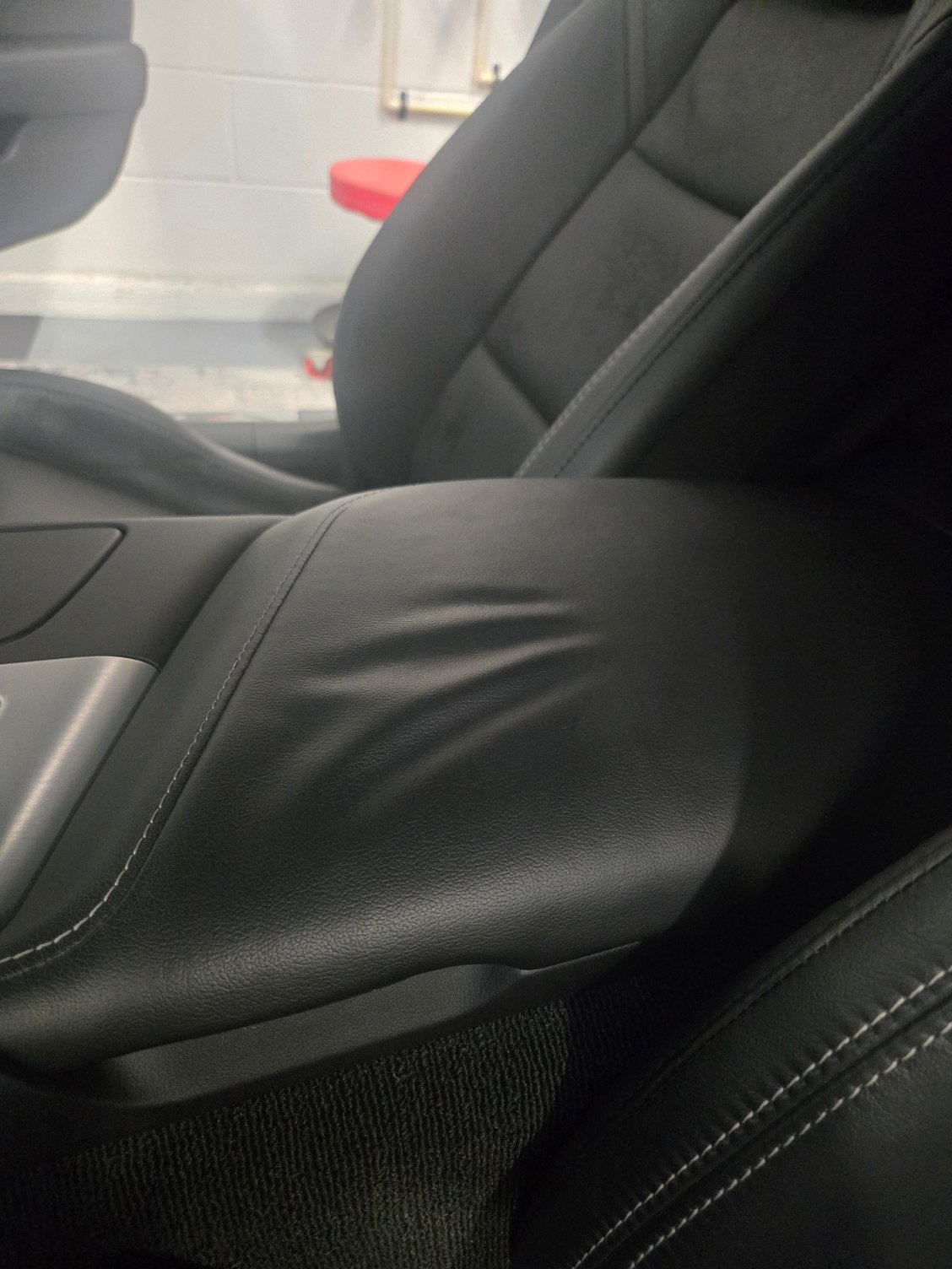

Any ideas on how I can safely take the "stretch" out of my center console?
I have a manual and this happened to me from always having my elbow on the box.
2018 center console
2018 center console

Try a bit of steam gently

That was a warranty issue back in the day, it's what's underneath that fails.. mine did as well but dealer set me up with Z06 logo unit which has not done that. A pro may be able to fix it, or look online for the black console cover with logo. Moving you to C7 General for further discussion

Yup March of 2017 the console lid was redesigned so that very issue would not happen anymore.

The console in my 17 GS did that twice. Both times they were replaced under warranty. The last one been in there over 5 years and is still ok.

remove it and have an auto upholster repair it. Easy fix for them.

I had mine recovered and embroidered at a local custom upholstery shop.. I think I paid $180??? He used high end leather and feels great.

Our 2017 (made in Fall of 2016) developed the wrinkle after a while, the replacement has been flawless for about 4 years. So the fix works on at least some cars.

I replaced mine with one from RPI and it is much better.

My original looked like that. Use a blow dryer and get the material warm/hot first. Then take a wet washcloth soaked in ice water and apply until if fully cools. Do it about three times and should come out "almost" as good as new - not perfect. YMMV
