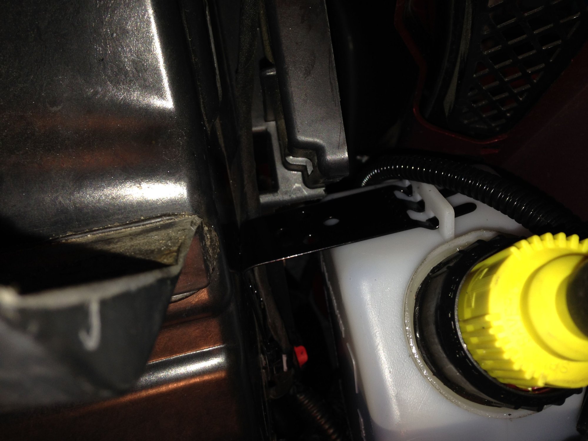

here is the bracket i made, uses existing holes on the inside fender
and this is the fitting from devilsown as installed, wish it had a 90* on it, may modify if leaks

Thanks for the posts and pics guys. I'm using th washer bottle and the pump is inside the driver fender. Fits nicely. Works great to
