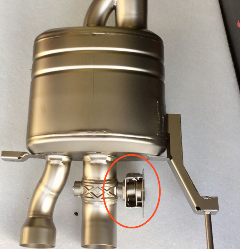

Akrapovic and others make axle-backs that still have the NPP valves. But some don't.
So in short, if you want to keep the exhaust adjustability AND have a cat-back, you need to buy one that has the valves in it. You will likely retain and use the stock activators (motors) but the valves have to be there, you can't fake it or use your old ones.
Here's someone else's picture of an aftermarket cat-back that does have the valve, which I circled.
