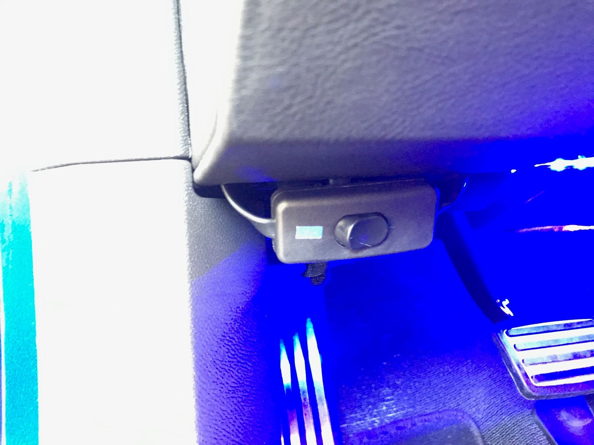

I just installed the latest version 8.2. Got tired of the seemingly constant changing from V8 to V4 mode and change in exhaust note. To me going from V4 to V8 also seems slower response when stepping on the gas. With the AFM Range Disabler it has increased my enjoyment of driving. No issues in the short time I've had this installed. I did use the cable with on/off switch to avoid a dead battery as my car does sit for a week at a time.
Tucked everything up under the dash:
My blue LEDs are lighting up the area. Little piece of tape reminds me what position 'on' is
