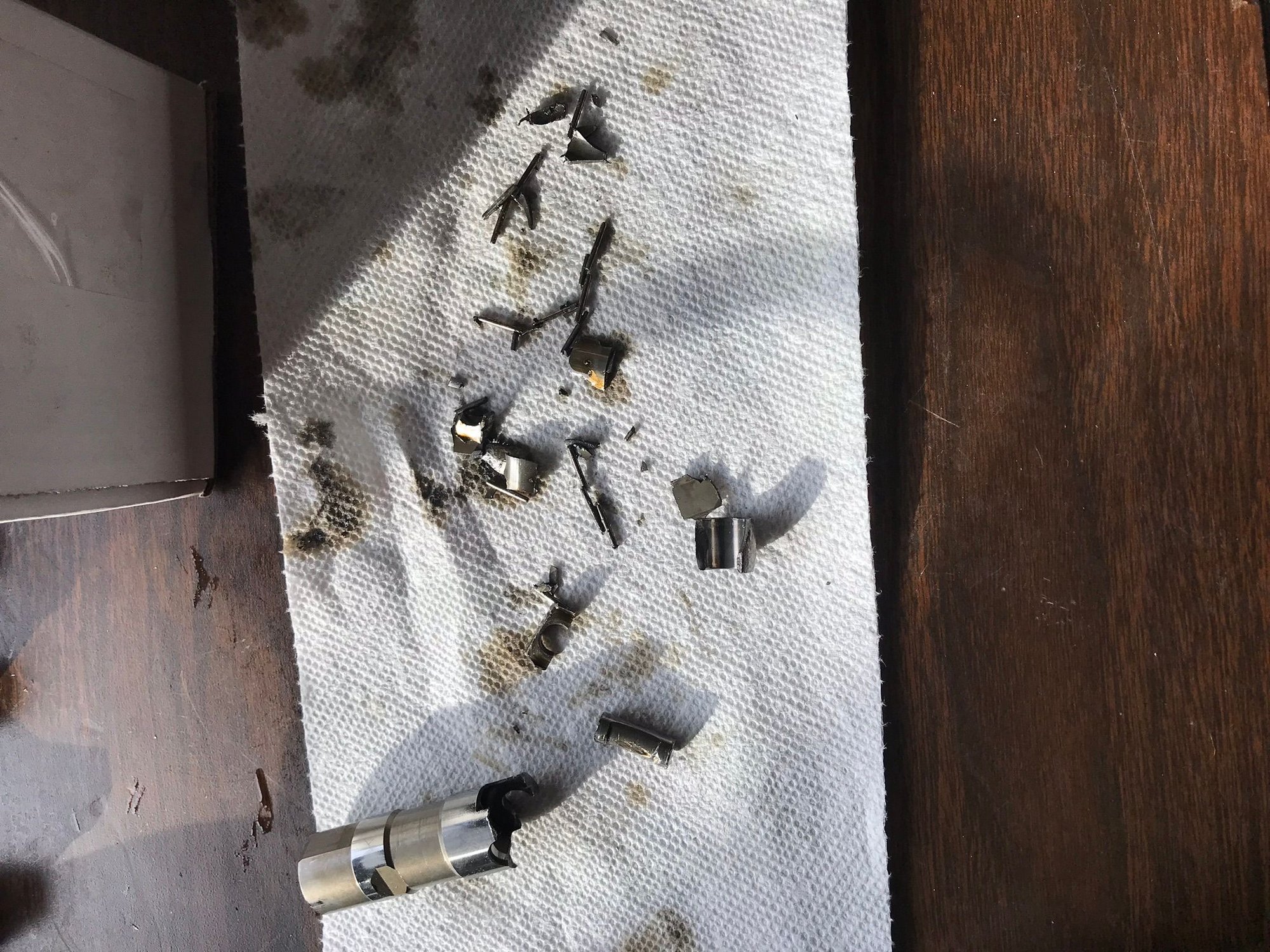

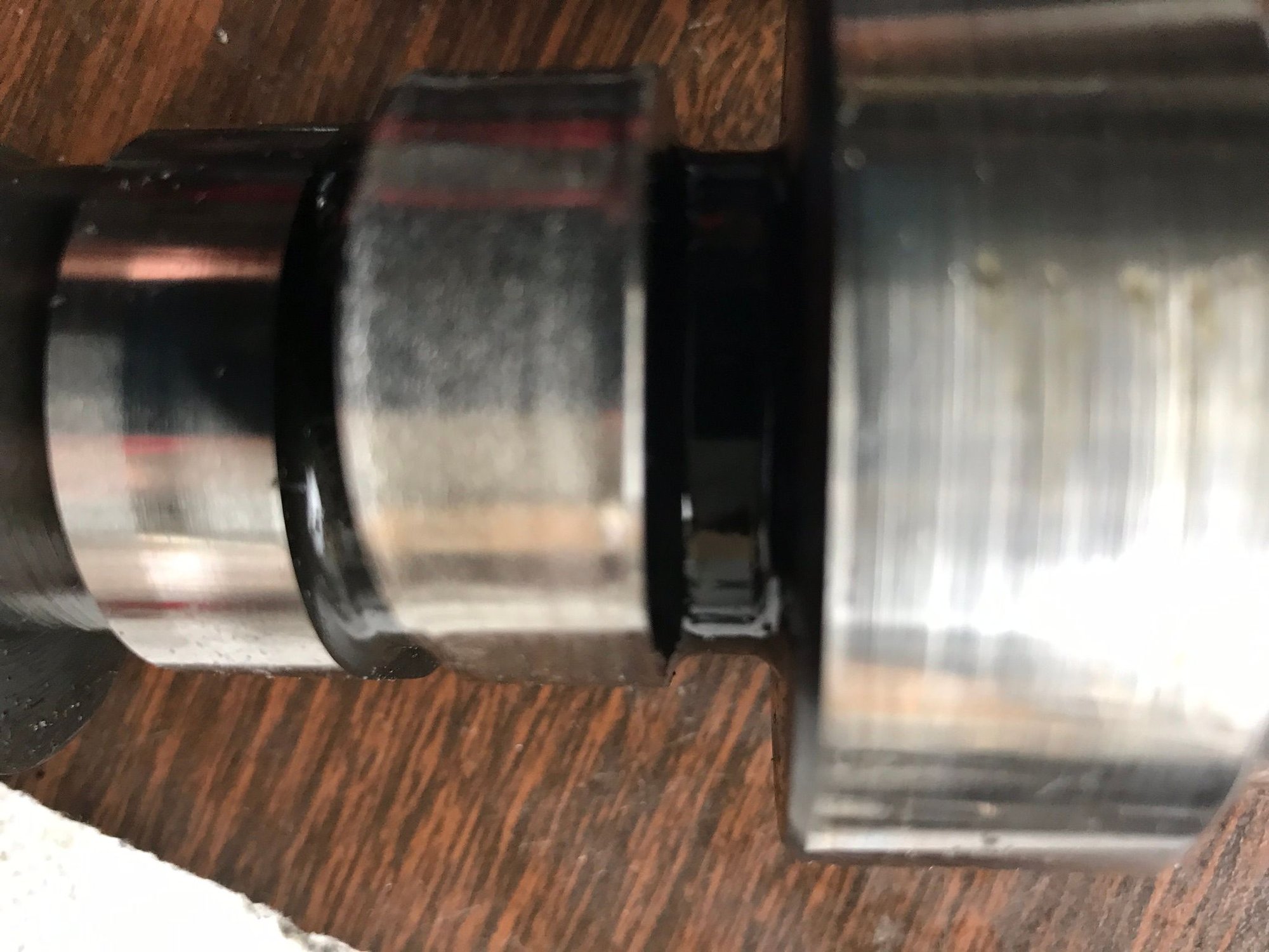

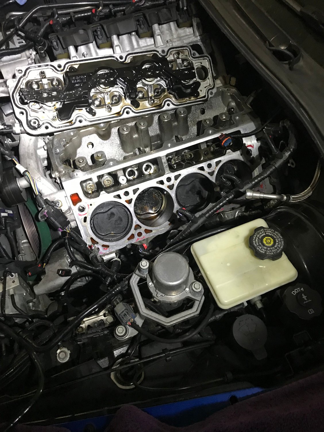

Texas speed 416ci LT4 with 20k miles on it and all the cam lobes look like ****. One lifer axle completely gone, and I am doing this job right now...

I’ll have the cam out tomorrow and post pics...

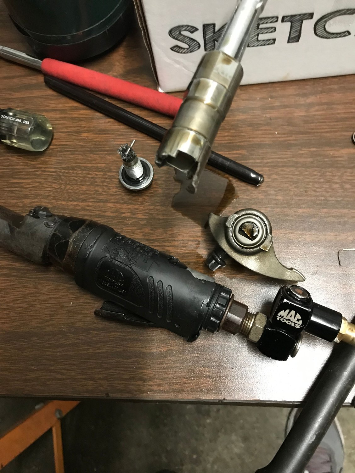

Well, the motor is missing #3 intake valve lash cap, I have not found it yet and until I do, I can’t make an educated guess. It could be anything from accidental over rev loosing lashcap and falling into the lifter roller path all the way to alcohol content.

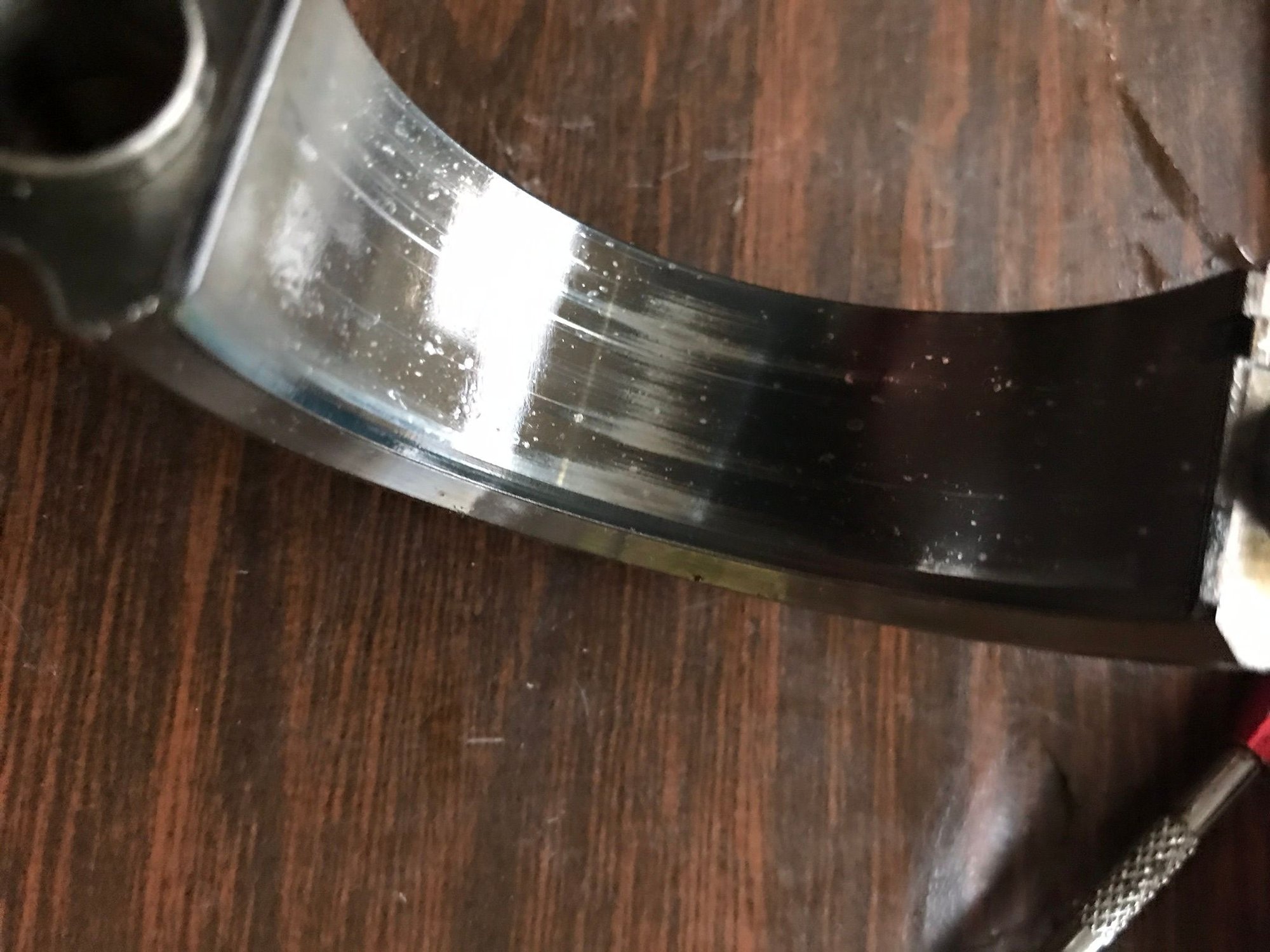

“Good” cam lobe and lifter pieces as well as a lower rod bearing. The cam bearings look like ****...I’ll be pulling this one and I’ll go through it and the complete oiling system.

not in this case, lifter preload is correct. Anything I say at this point would be speculation and potentially pointing fingers at others prematurely. That said, this engine was replaced at 8k miles because it had catastrophic rod failure...and one has to wonder if the sump system was properly cleaned out. The truth is that I’ll never know, but I know it’s going back tight and right and tight this time.

Oil used was Joe Gibbs Driven, not the issue. I’ll have more detailed pics by the weekend...

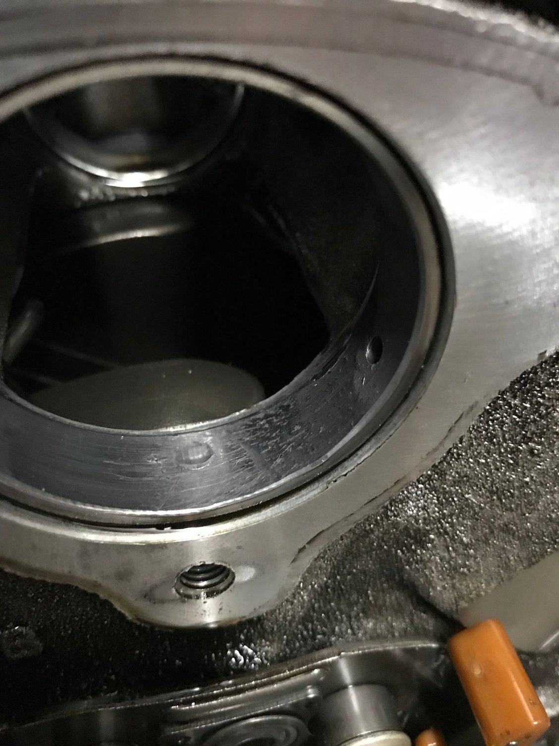

More drama...

Update, block and liner damaged along with piston, and all pistons scuffed pretty damned good. While we can repair this block, I have located another one needing only a sleeve, and will be replacing all the pistons. Looks like lifter roller got caught by a rod on its way down and hit the base of the cylinder.
