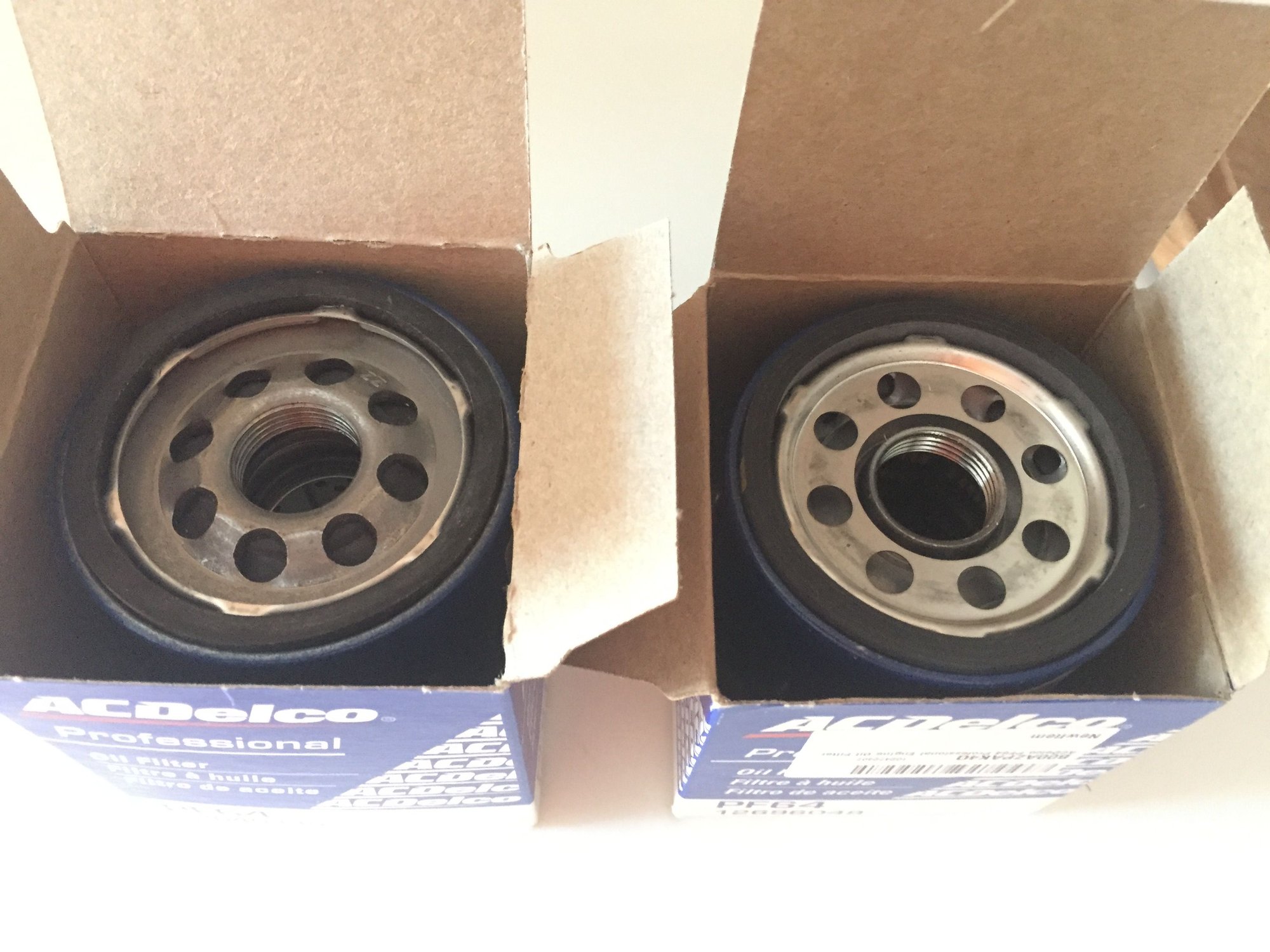

As expected the Amazon order came in with the new PN. I'm not an expert, maybe others can advise?
1. The new filter is shorter. Does this denote less filtering capacity or does the different design allow same filter area in a shorter body?
2. New filter has no anti-drainback and a plastic center core. Would this allow more flow? Anti-drainback isn't needed with our application.
3. New filter threaded bung emanates from the inner metal piece and the top metal with the holes seems very thin. Old filter the bung is part of the top and very thick gauge.
Thinking about returning these and getting Wix? I have 2 more of the old ones so should be good for a year regardless.
The anti drain back valve does more than just hold oil in the oil filter, it also keeps oil in the galleries leading to the filter which can reduce or prevent dry starts. So even filters with the thread end upwards can benefit from an ADBV.
