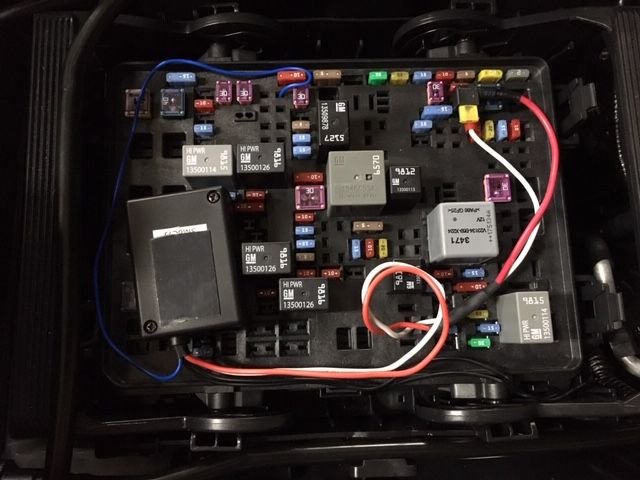

Default Water proof install
I actually mounted mine inside the fuse box. There is enough room on the left side where it fits snug. I combined the 2 black ground wires into one (soldered & shrink tape) then cut a small slot next the the front notch and ran it out to a small black wire conduit to the ground. Put a small dab of silicone where the wire exits.The antenna wire is just wrapped around the inside parameter of the fuse box. Totally concealed and waterproof.

Great Idea! Can you post a photo of your install?

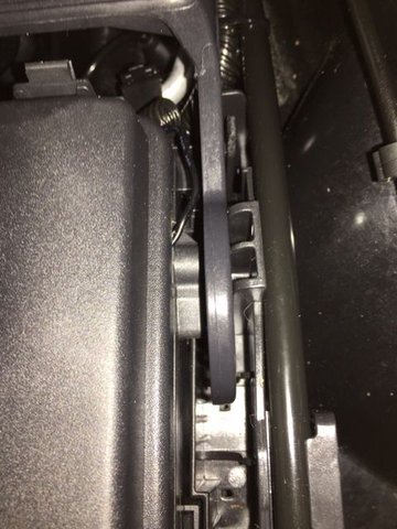

Hope this helps. The controller sits in the fuse box and once you put the top on it stays secure. The larger relays keep it from moving. I opened up the forward notch on the cover to give it enough clearance to allow the wire to pass through. Then I routed the ground through a small plastic conduit (Home Depot) to the ground bolt and wire tied it.
