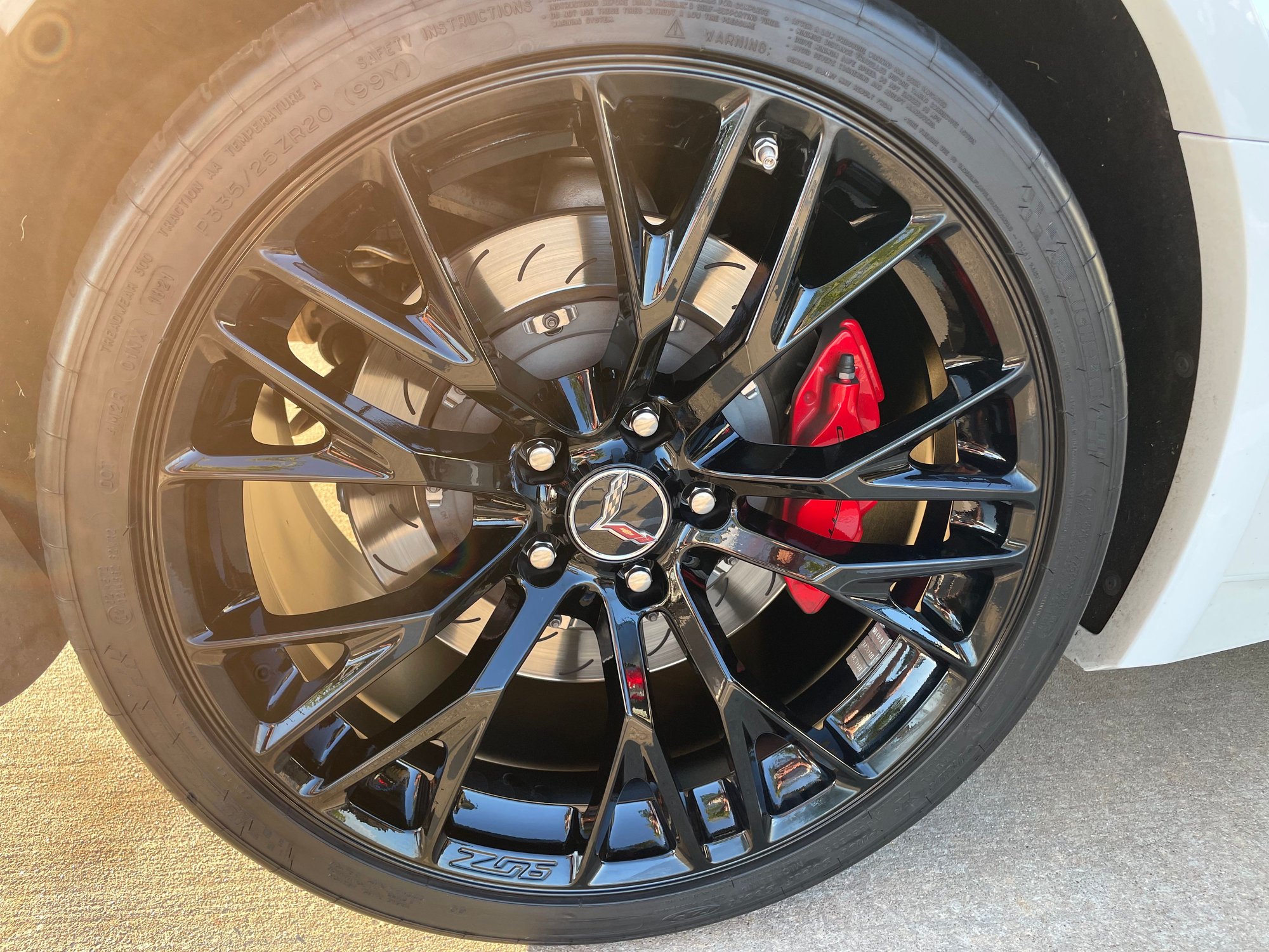

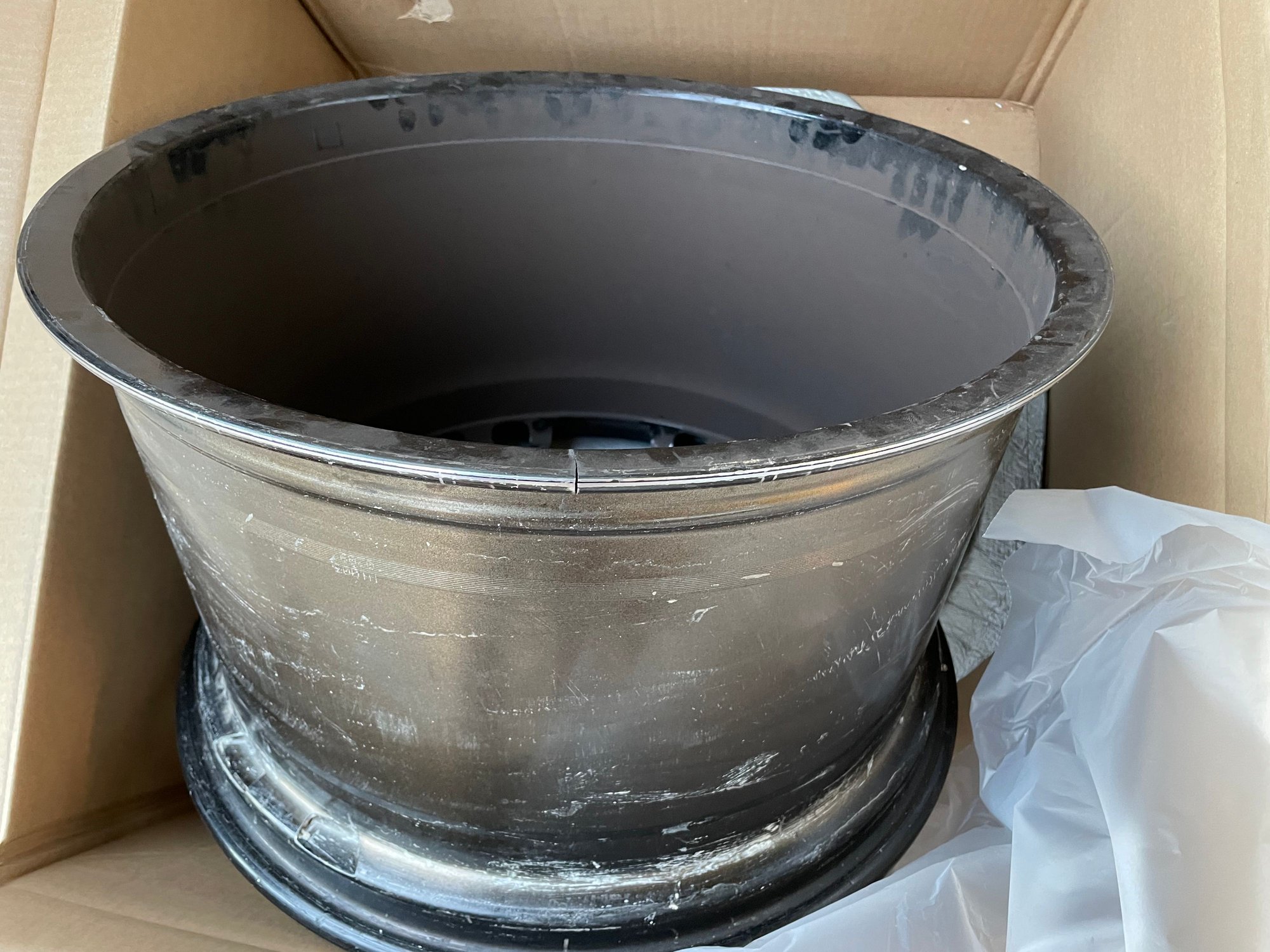

Also know that you can’t get the same stamped ZO6 wheel you paid for when you purchased or ordered new. This is the difference when you look at them abs I’m sure the material is different, but unsure at this point.
See how the “ZO6” stamp is in completely different location.

Which ones are the originals? Mine has the stamp on the lip like in your 2nd picture.
The original which came on ZO6 from factory is in first picture…the only GM replacement they have for it is one in second picture which has ZO6 stamp more on the side of rim and more viewable like whitewall rim on side of tire.
