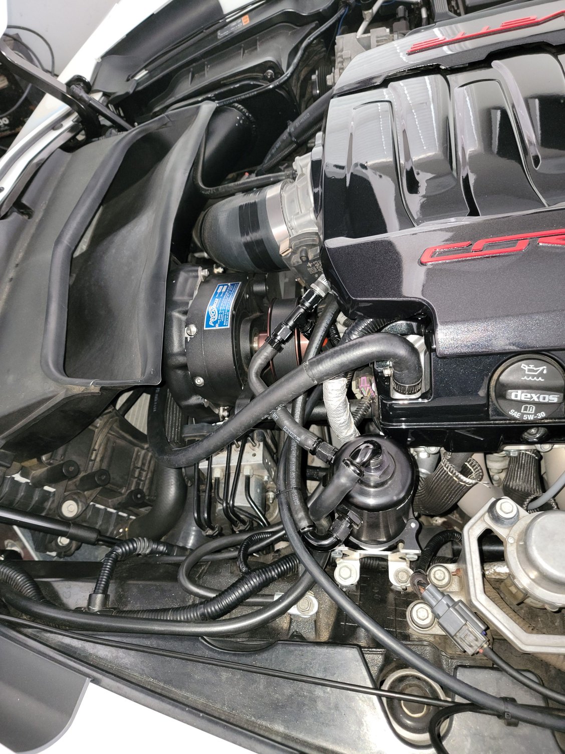

Install was easy on my A&A kit I did last weekend.Hardest part was trimming the stupid plastic for the horizontal mount intercooler lol.
