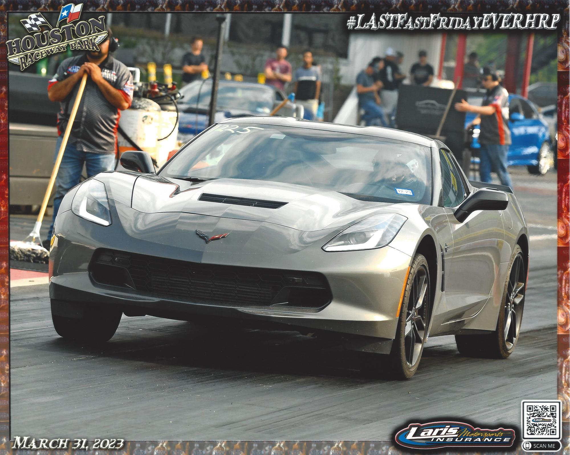

Running stock Z51 wheels and tires on my 800ish 2016. Leaving TC on I can still squeeze out a 10.04 quarter mile leaving in 2nd gear on my A8. I’ve never even considered turning off TC since my build except for a burnout at the track. I was able to break a stock axle with stock tires so I’m really not looking for additional traction at this time. Differentials are expensive.
At freeway speeds on dry concrete I can definitely tell this thing wants to blaze the tires. TC and Stabilitrac FTW.
When I’m ready to stress test the diff I’ll probably try an 18 or 19 inch setup.
