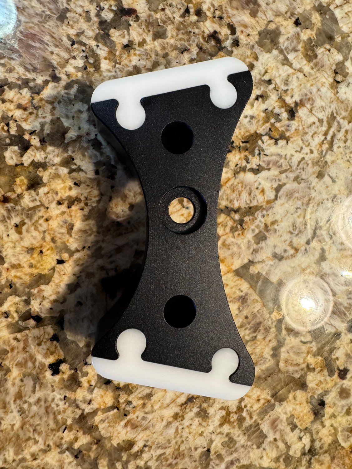

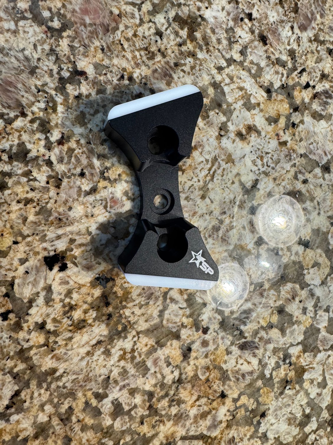

finally doing the cam vvt delete and dod delete. new springs cam lifters pushrods and full vvt delete . couple yrs ago I snatched up a katech vvt delete and had it sitting on the shelf. during the install I opted for the new katech tensioner which is a poly phenolic material in the shape of the oem which is prone to breaking. 49$ over the billet lme unit which was 223$ and I wasnt a fan of the chain slapping against aluminum just seems like a bad idea and noisy. (wear from the metal chain I feel will always win over the aluminum so wear goes in to the oil. ) just my .02. after the install I read from a shop who installed the katech unit I had and it lasted 10 miles before breaking!! now im paranoid and debating what to do when I come across this Texas speed unit. looks similar to the lme billet unit BUT has phonetic ends on it! this is what the chain runs against. in my porsche days this type of material is what Porsche uses for their tensioners and they use 2 timing chains very little noise long life. at 100$ I felt this was a great alternative to all of the other options ie: oem lme or katech. install was simple fitment seems really nice and I love having the non metal material against the chain.
I guess time will tell. degree the cam this weekend ad the other parts and hopefully setting up port injection next week. but heres some pics of the Texas speed timing chain tensioner

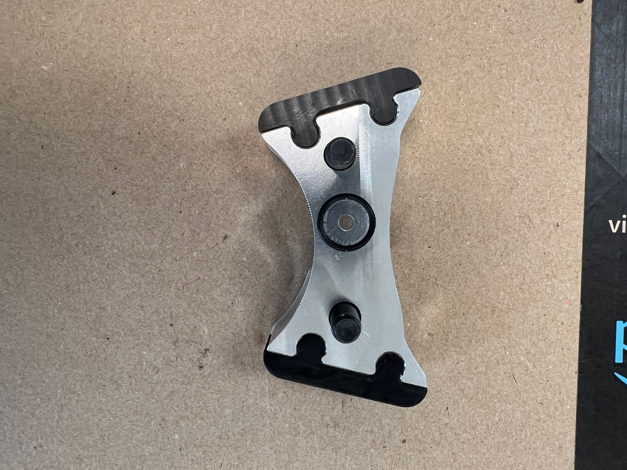

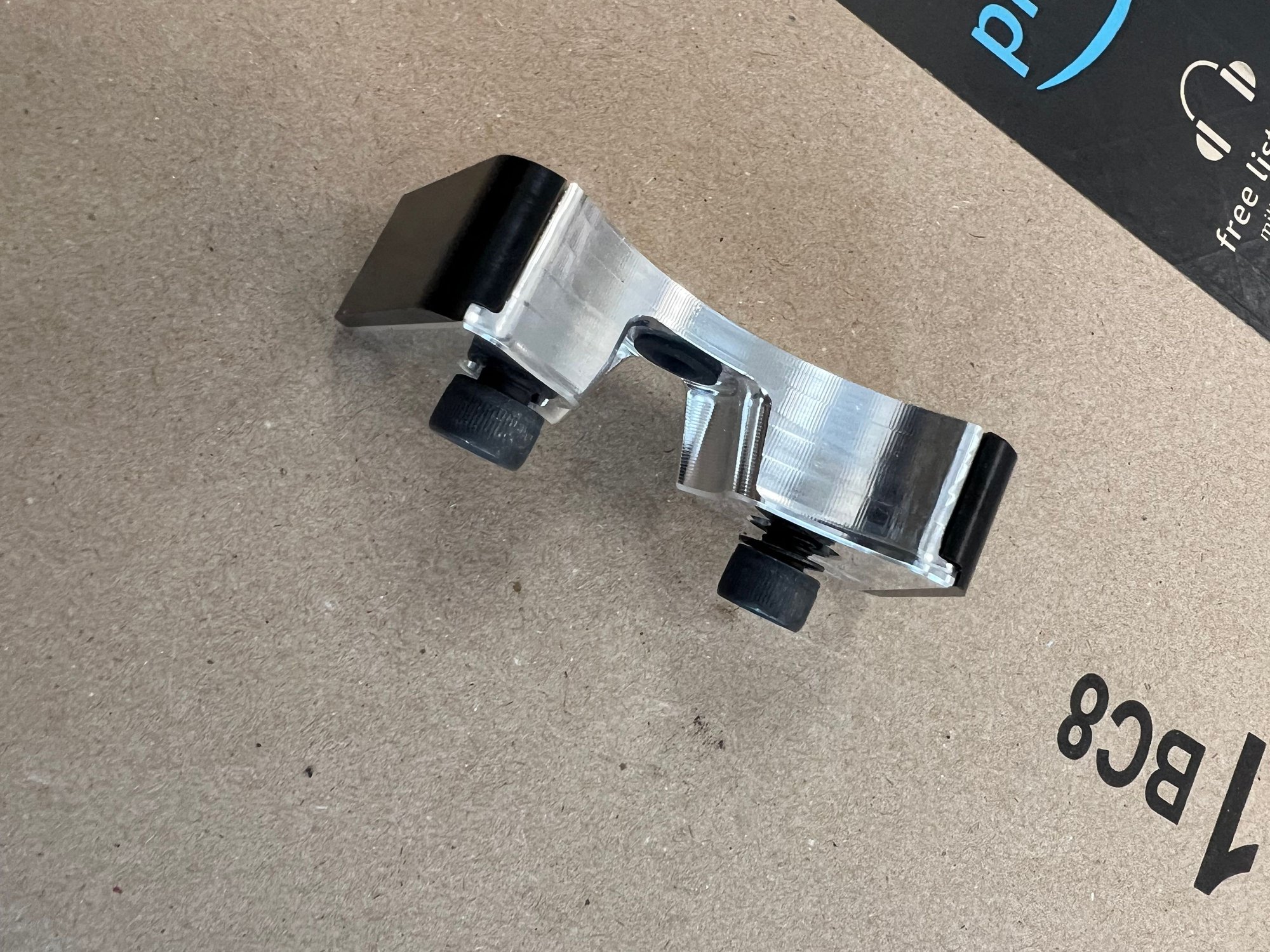

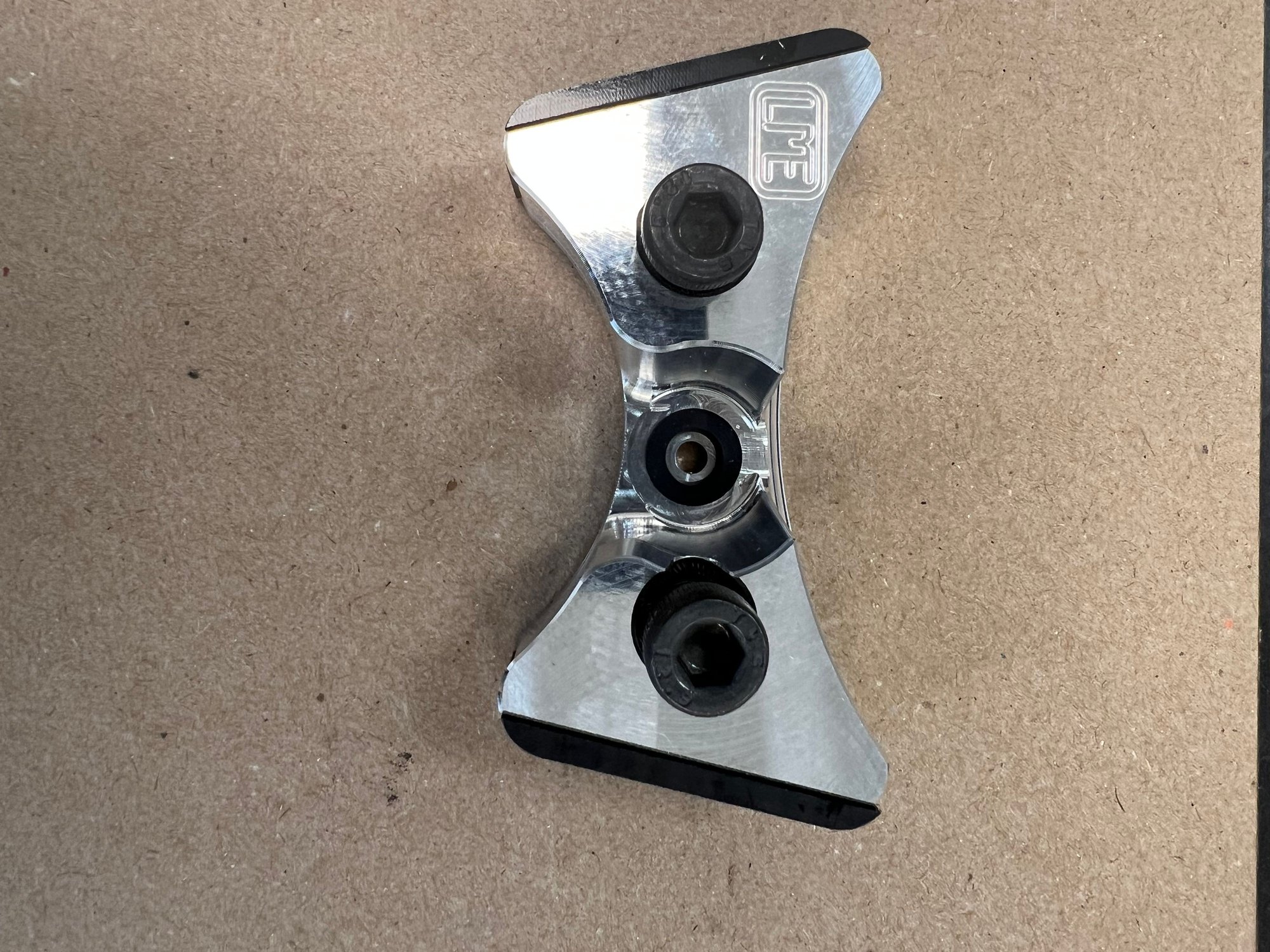

It uses the good piece of the OEM part and replaces the spring that breaks.
The LME billet piece has the wear pads on the ends. It is not just aluminum. To your point, that’ll trash the engine. I had one that came with my LME front cover and modified LS3 cam gear but sold it.
If someone had the Katech piece and it failed in 10 miles, that’s a mechanic problem.

I wasnt aware the came tensioner had phonetic material on the ends never saw one in person pics look like bare aluminum that's good to know

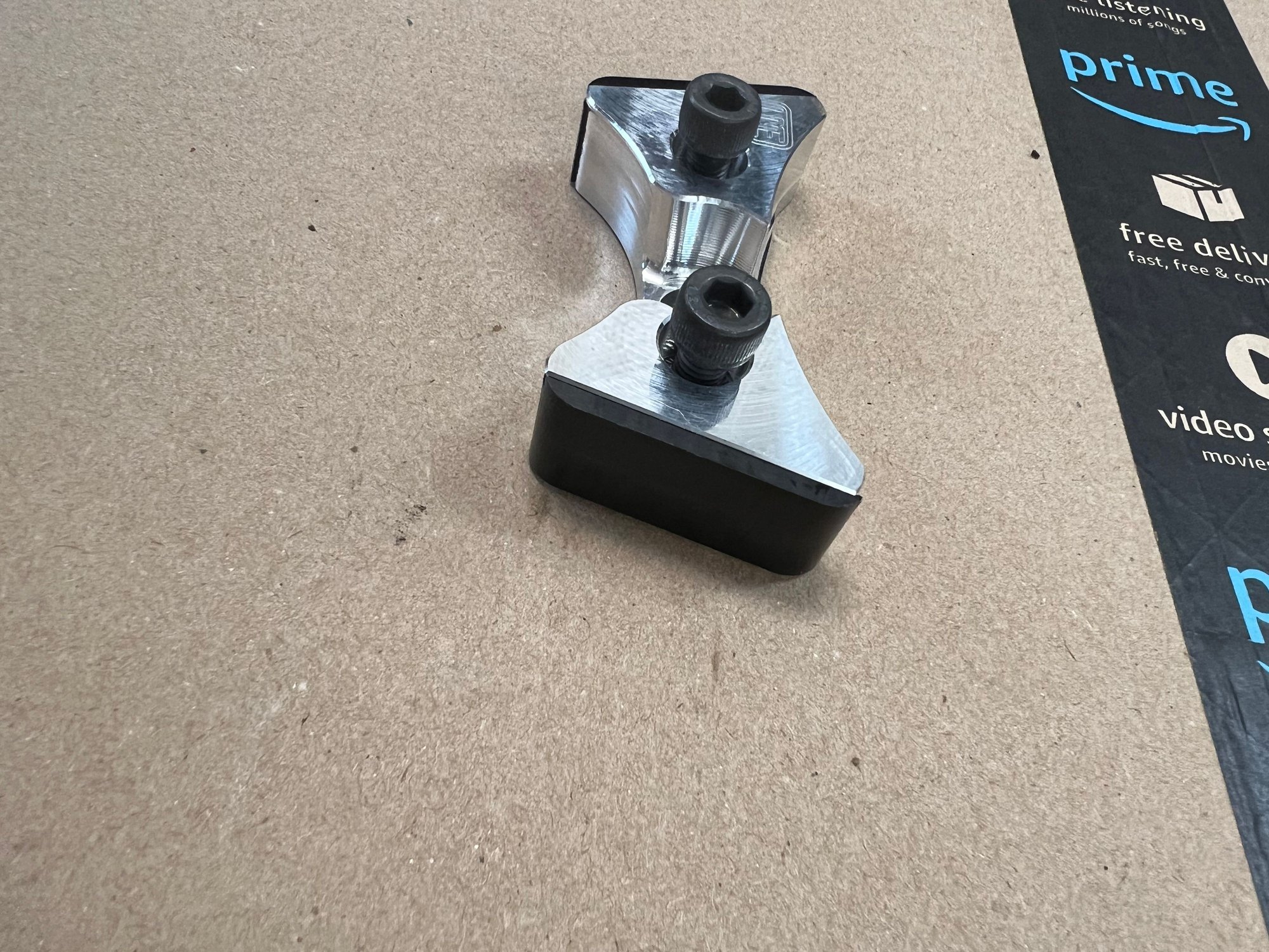

LME part
To timing chain tensioner
