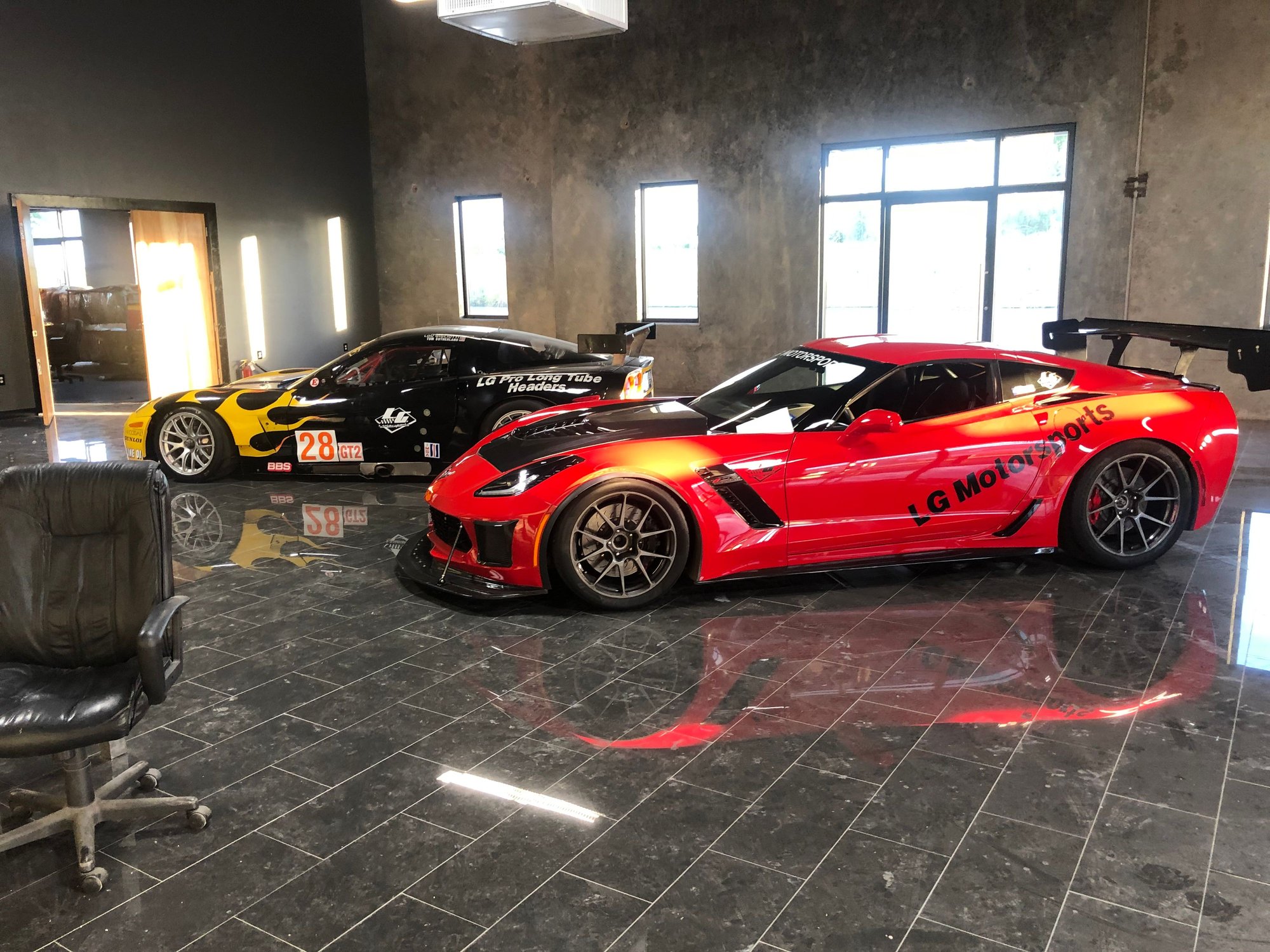

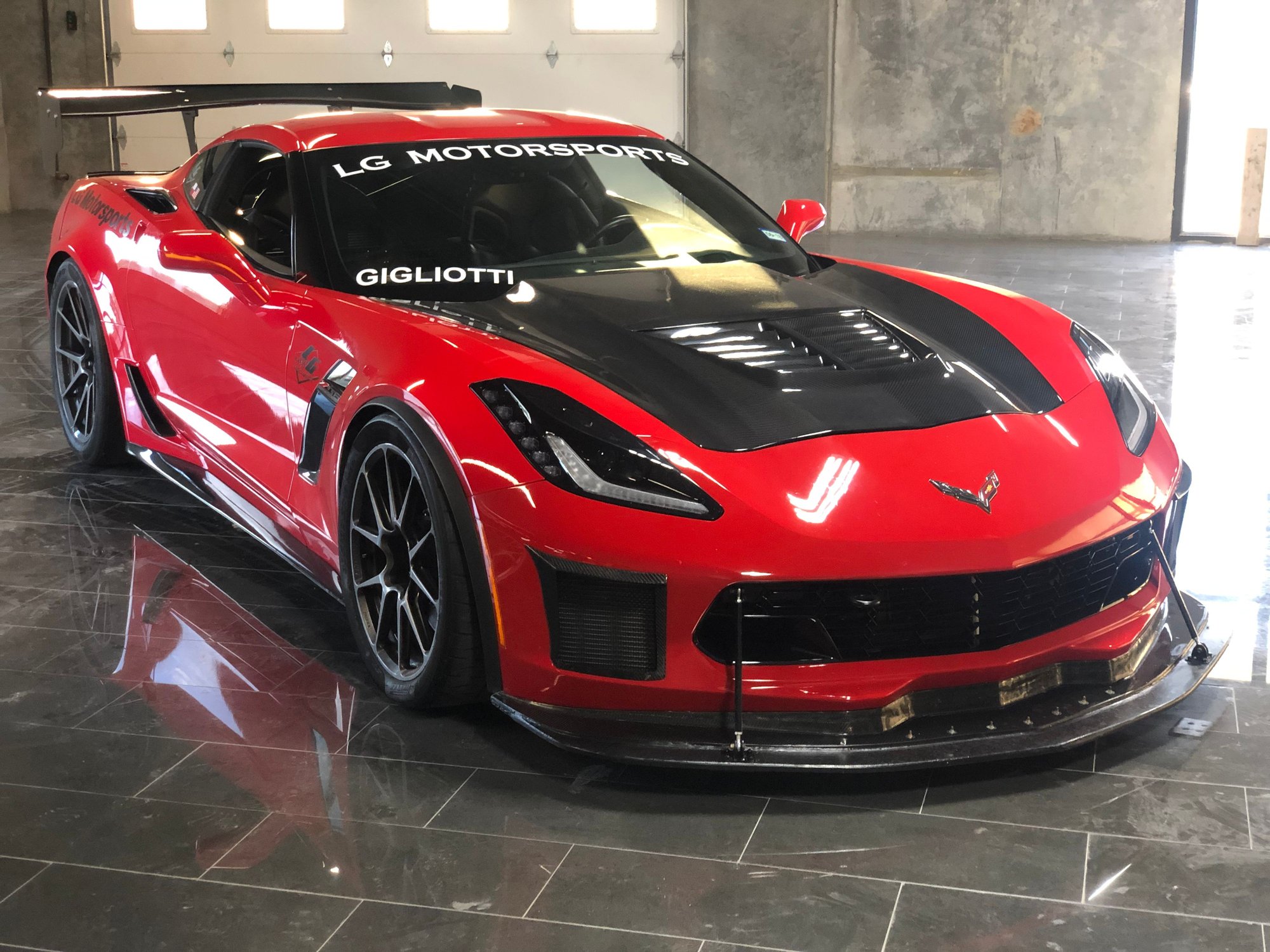

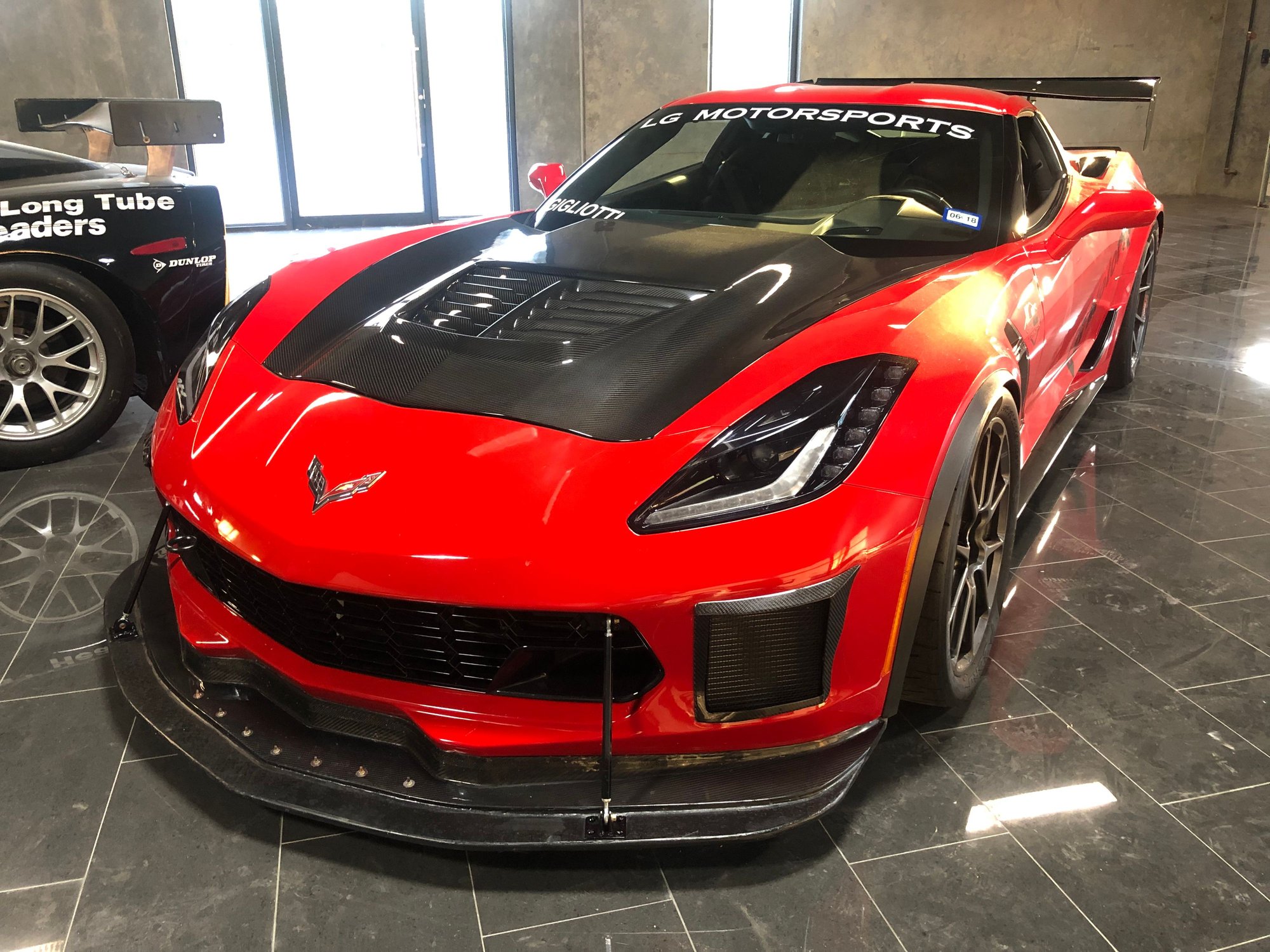

Default You cannot cool without air in and air out.
Originally Posted by Thomasmoto View Post
The only way to fix the problem for sure is too add the additional coolers and additional openings in the front bumper cover. Anything short of that isn't going to work under hot conditions. There are quality kits and shops that can handle what you need. There is a reason the 19 ZR1 front end looks like it does. That's what it takes.
Correct. This car has the LG dual inter coolers And the arrowhead to suck the air out and reduce lift.
Track time with this package is a no brainer
