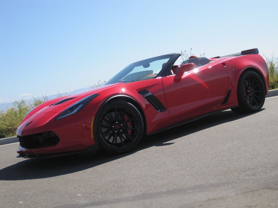

Came across an Instagram Z07 owner and asked him what he's lowered on. Said he's on Eibach and his buddy also. They have 8-10k miles with no issues. It's also not turned to the lowest setting and the stance looks like how I want mine.
Anyone else use these? I hear the stories about the WCC rubber bushing ripping apart within few months to a year and also heard of the pfadt bolts breaking at the joint.
Here's a pic of his stance
View this post on Instagram
I don't see a listing for 2015+ Z06 but all the other aftermarket bolts say the same C6 bolts fit all C6 and c7 models so these should work, correct?
