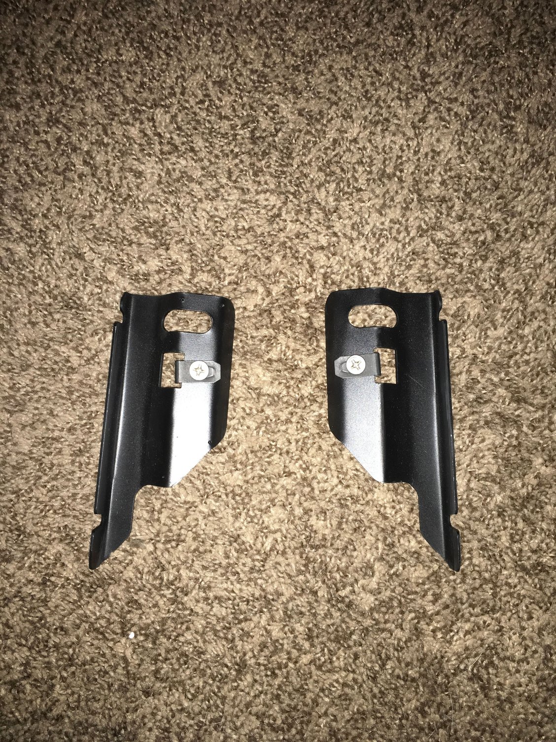

Hi Protekt I just received my Stage 2/3 splitter protector. I know it is pretty straight forward install except for these 2 metal brackets? Where do they mount? Quick YouTube video would be awesome.

It came with 2 small metal brackets and 2 stainless screws that screw the brackets to something? I will take a pic of them.

Maybe it's for the stage 3 winglets?

Yes they are for the stage 3 winglets, can't help you as where they fit as mine will not be here until tomorrow, Mitch allowed me to return their first kit and replaced it with this for stage 3.
See this link to show new bracket

Those brackets fit inside the wider, ZO7 option winglets.
They install using the factory winglet bolts, and are meant to help hold the ends of the plates up tighter against the bottom of the winglet
Here is a pic of one of the prototype brackets installed in a test car.
(By the way, those bolts are a PITA to get to!!)
If you are running the stage 2/3 Aero kit, but the narrower winglet setup, you need the regular Stage 2/3 kit, instead of this one.
