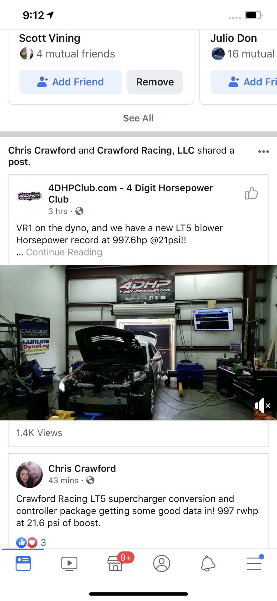

997.6 whp at 21 lbs, some cooling down... it made 1k whp. This is no low side fuel and stock motor with cam only. This is a game changer!! I canít wait for my numbers on a LME 416, Crawford Racing Port Fuel with Fore Triple and porter blower and maybe 102mm throttle body. Shooting for 24-25 psi
