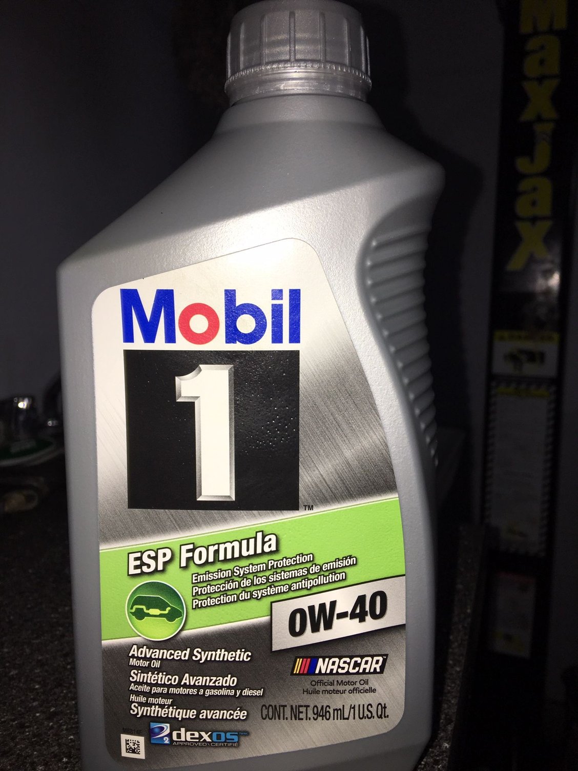

People keep making the same mistake. That isn't the same 0W40 oil that comes in the 2019 Cars from the factory. At this time It isn't available at Costco or any other retailer other than GM and one or two eBay suppliers. This is what the new oil looks like in the one quart containers you can get from the dealer:
Note the ESP which stands for Emissions System Protection and the 2dexos which is just a backwards Dexos 2. The difference between the other Mobil 1 0W40 is the amount of ZDDP in the oil which causes issues with the catalytic converter lifetime which would increase GM Emission warranty costs during its 8 year/80K mile duration. I have this in my 15Z now. The dealer installed it when I did the required one oil change per year. It is still OK to use the 5W30 but the 0W40 works on track as well and eliminates the need to switch to 15W50 Mobil 1 for track usage. I think the price per quart at the dealership came to about $11.

I am wrong. The Blue Logo that says 2 in the lower left is the ESP 0-40 and is what GM is now calling Dexos2. Apparently different than the old Dexos 2 which was primarily a Diesel spec. The Green Label for Dexos is now Dexos 1 Gen 2 which covers the recommended 5-30 Mobil 1 we have been using for years. Dexos2 is a trademark. Dexos 2 is a word group as Dexos 1 is a word group. I have sent them an email asking for an explanation of the difference in the specs.
And there are two separate licenses for Mobil 1 ESP. First is: Mobil 1 ESPExxonMobil Oil Corp.dexos2™0W-40GB1A0917015Global
Second is:Mobil 1 ESP FormulaExxonMobil Oil Corp.dexos2™0W-40D20679HJ015Global
One is ESP with a license number from GM of GB1A0917015 and the other is ESP Formula with a GM license number of D20679HJ015. Both with 0-40 viscosity, Both from Mobil 1.
