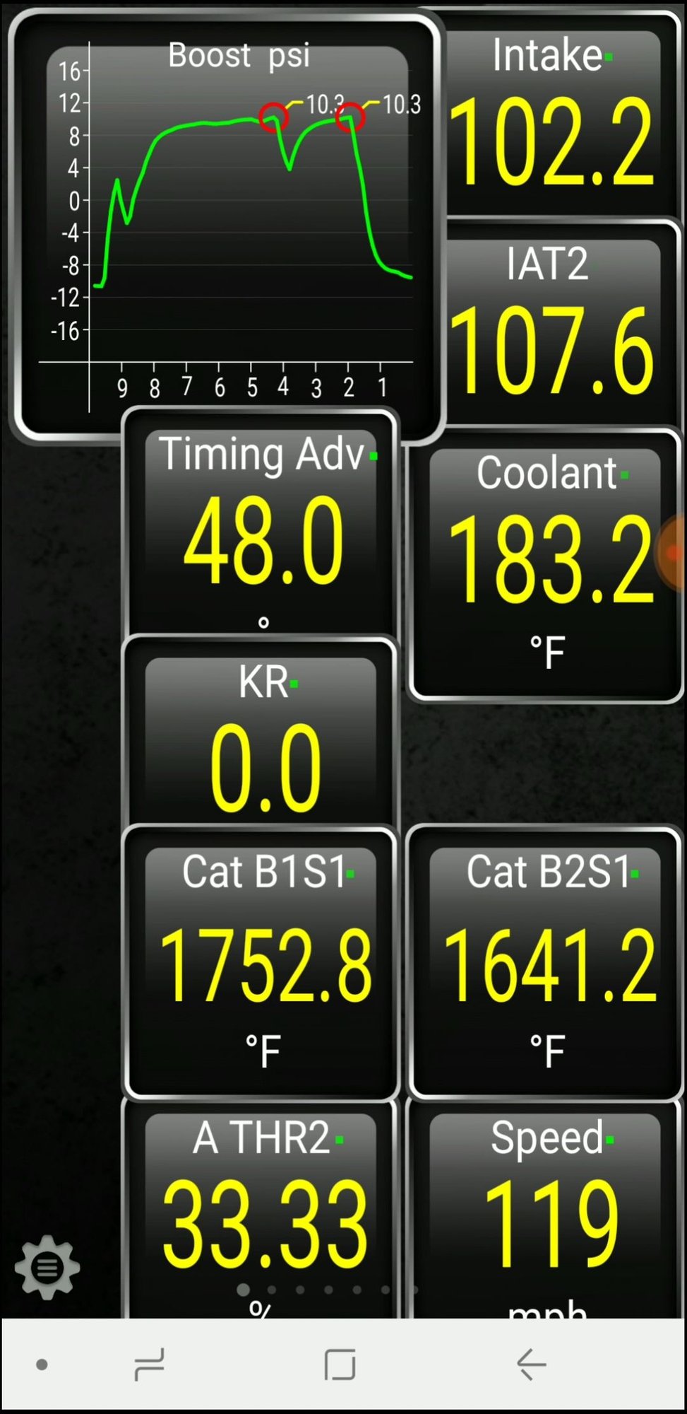

Whats stock boost? 9.5? I just verified in 90 degree ambient my car with Corsa X and halltech only. No tune. Hits 10.3 psi in 3rd and 4th (didn't wring out 4th all the way). I did cut out the fender hole above the filter inlet bigger.

9.5 seems to be the norm. Halltech always claimed an increase in boost which seems to be true time and time again. Which is where most of that large hp gain comes from that most don’t understand.

Indeed. If I push 4th to redline I could maybe gain another 0.5 lbs.
Halltech claims 10.4 psi with intake only which makes sense as I was right there. Sadly PDR boost reading is completely useless.
Here's the short pull graph. 4th gear boost was still increasing.
