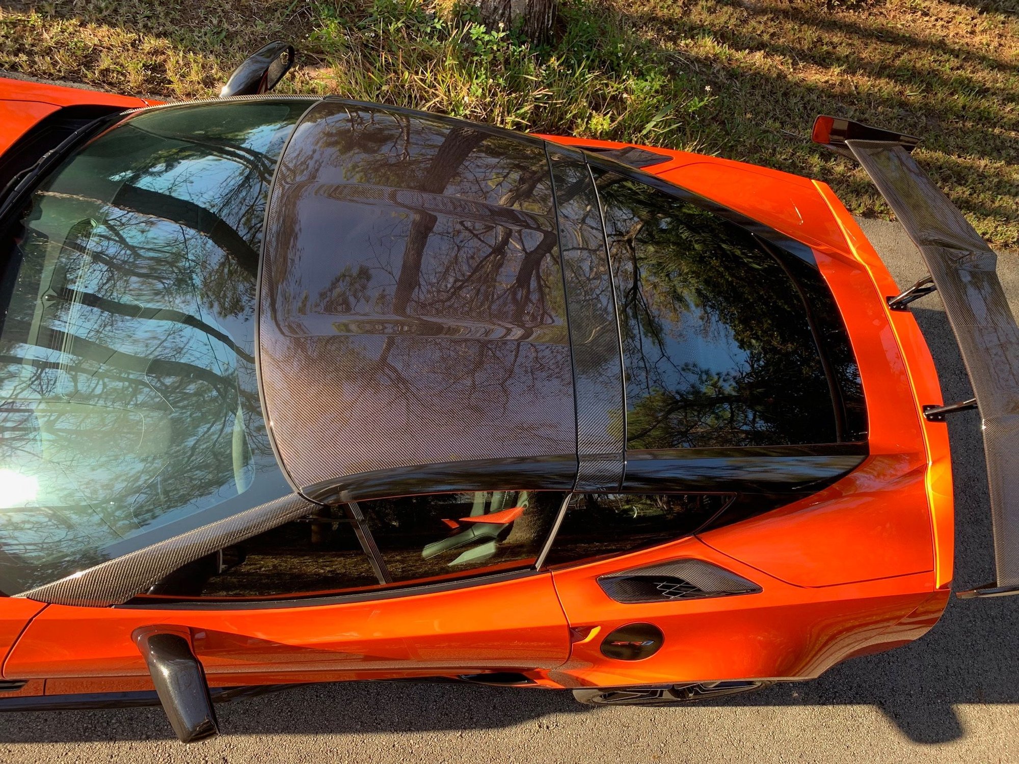

Thanks for posting, but I wish he had shown before/after with the roof back on. Any pics of this?

Which vendor did you get this from? Is it the lighting or does the carbon fiber halo piece (color) not exactly match up with the top?

The ZR1 targa has an orangeish tint to it in the carbon fiber twill. Same with the supercharger air cover under hood.
mine is same color

The reason the GM exterior CF panels don't match the aftermarket ones is that GM is using an anti-HEV tint to protect the resin against the inevitable damage cause by light exposure.That the aftermarket pieces do not share this tint means that they are not protecting against HEV, and their resins will fail sooner than if they had protection. In the mean time they will not cosmetically match the OEM CF. Personally I suspect that re-clearing them with the right tinted clear would not be a very difficult process for an aftermarket manufacturer to figure out. I know I could, if I had the time and facilities.

Well done...the Carbon Fiber halo fits in perfectly with the rest of the ZR1.

Doesn't quite match
