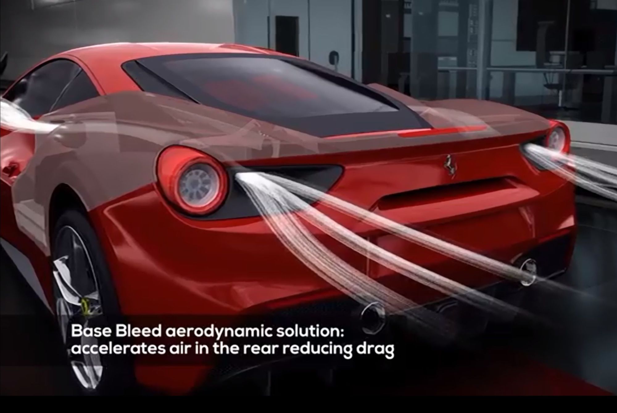

There is a high probability that the ME will introduce an air bleed aero system similar to the Ferrari 488. Why? Because it is effective at reducing drag. The ME’s trapezoidal ducts below the taillights have three times the venting area of the ducts located outside of the taillights on a C7 — for these larger ME ducts will have at least two air system ducting components, e.g., exhausting hot air from the heat exchangers, and also exhausting air from the air bleed aero system (air that intitally came from laminar flow along the side of the car, then went into the large rear fender intake duct, and finally exiting from the trapezoidal rear fascia vents). By thus being at least partially serve as an air bleed aero component, as noted below, that would result in reduced drag compared to the C7, specifically by moving the air wake further behind the car — as is noted below on the comparable Ferrari 488 GTB aero air bleed system.

The Ferrari base bleed air intakes on the car’s sides are divided by a central flap. The flow over the upper part of the flap, which is also used for the engine air intake, is deflected and exits from the tail area to reduce the drag caused by the low-pressure wake directly behind the car.
The effect is created by the airflow exiting under pressure at the rear which energizes the wake that forms at the end of the car’s tail, moving it further from the tail where it thus interferes less with the car’s aerodynamics.

The scalloped side air intakes are a homage to those found on the 308 GTB, and are divided by a central partition. Air entering the top intake is partially directed into the turbocharger compressor intake, while the rest is directed through the rear of the car and exits alongside the rear lights, increasing air pressure behind the car in order to reduce aerodynamic drag.

The bleed or bypass air must be quite variable depending on the engine demands. Just an aero component!

Who ever produced that video hasn't a clue. If you continue to reproduce this nonsense, the reflection is upon you.

In order to reduce drag, the air has to be accelerated, to be accelerated it has to pick up significant heat. It picks up that heat by flowing through the intercoolers, and possibly oil and transmission coolers.
