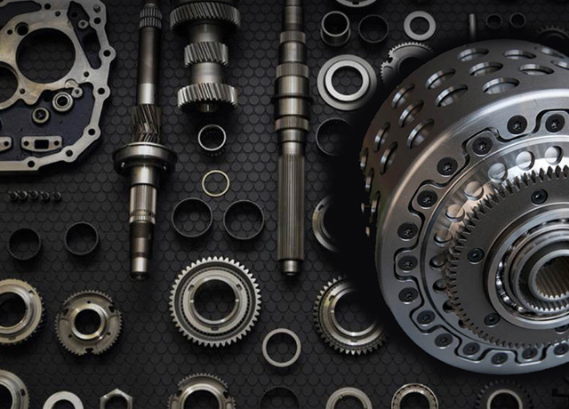

Here is a clutch pack from the DCT along with all of the gears and shafts. Anyone familiar with the parts in a manual transmission will recognize the DCT's parts and see they are very similar.

Most people who swear by sticks like virtually all my track buddies have never driven a car with a DCT on track, so they don't really know the benefits or drawbacks (can't think of any). But a few of them who have ridden with me on track said, "I guess all that shifting stuff is for the birds". One of those guys is the one who just ordered a P car with a PDK for the track. They are often most amazed by how the transmission can up-shift mid-corner so seamlessly it does not upset the car. That's something I could never do on track with a manual. Just one of the factors that makes a DCT tranny faster on track.
Here is another picture, a cut-way of an AWD DCT showing the input shaft/flange inline with the dual clutch-pack at the front and then the gear-sets behind. The two clutch packs are located inline one behind the other, as shown in the cut-away. Shift forks are under the gear-sets in this picture so you can't see them. You can clearly see the gold colored synchro-rings just as found in any manual transmission. This is a rear-mounted trans-axle like a C7 with the diff in the back of the transmission. As it is AWD, there is a separate output shaft driven by a gear via a multi-plate clutch pack you can see in the cut-away.
Here is a video of a ZF transmission as used by Porsche with a similar but different design for a DCT.
Another benefit of a DCT people often do not realize is that you can never mis-shift it, as when you want to upshift to 4th gear from 3rd under full acceleration but mistakenly put it into 2nd gear, and over-rev and destroy your engine unless you are fast with the clutch. In a DCT, the computer just won't ever let you do that. Gives you the option of full manual shifting but eliminates engine destroying mis-shifts.
