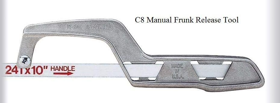

My frunk won‘t open either. What disturbs me most is the way the manual release is configured. Thankfully it works but for an old guy like me, it’s almost literally beyond reach. You can hook it with the end of this guy; works like a charm.
Fortunately = I have a 30 year old agile Son!
