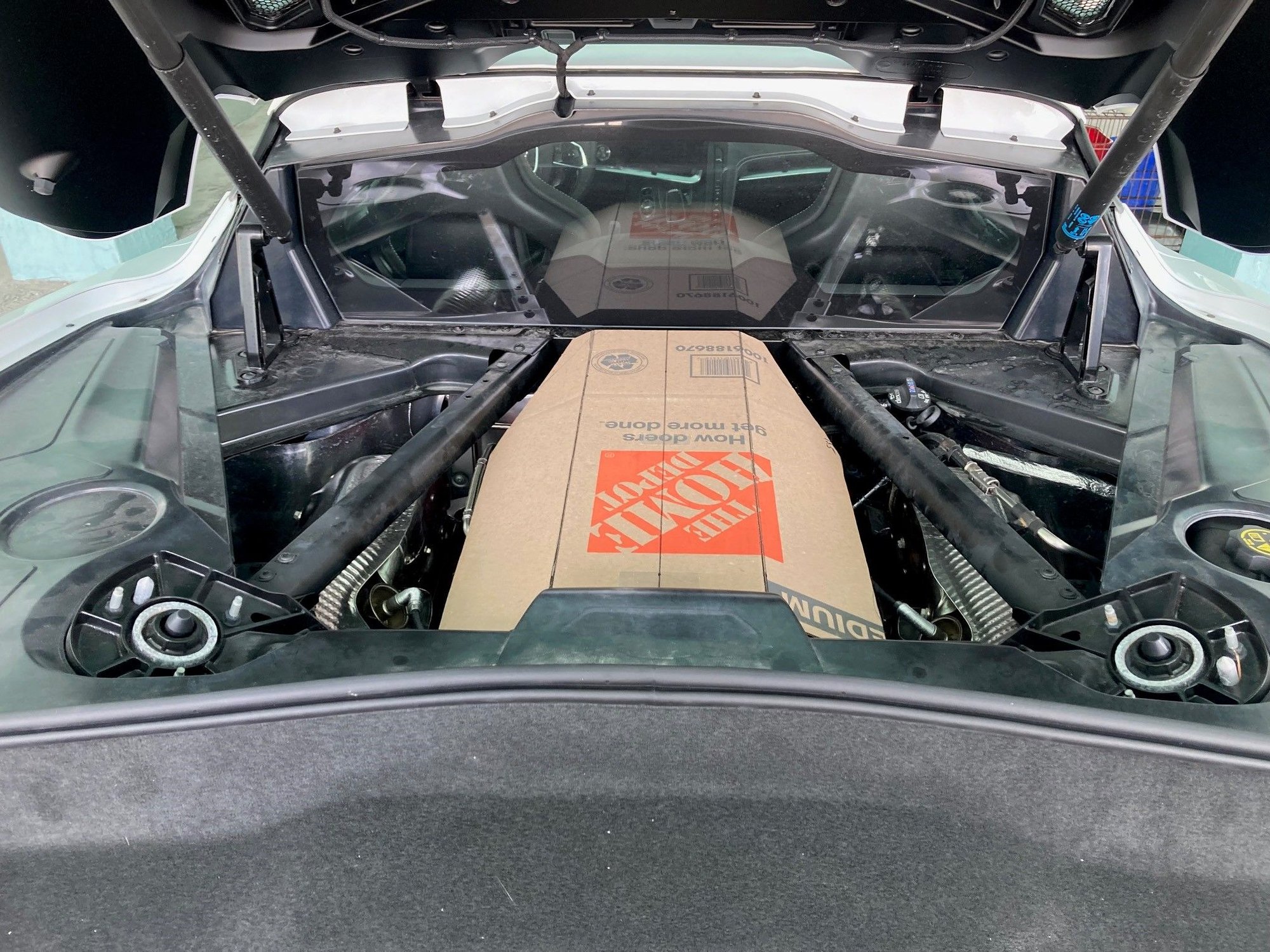

I need a small project, so I started thinking about an CF engine cover. I've made one for a different car with another ugly intake manifold and it came out pretty good. It's fiberglass mat over a male mold, then a CF overlay with surfboard resin. For the C8, I'd do the same. It'd end up pretty big, 24" x 20" and cover a good portion of the center opening. I'm thinking some polished corvette emblems for the top but that's still up in the air as decals of some sort are still in the running. It'd be attached to the existing OEM cover with some small spacers raising is some.
What do you think, yay or nay?

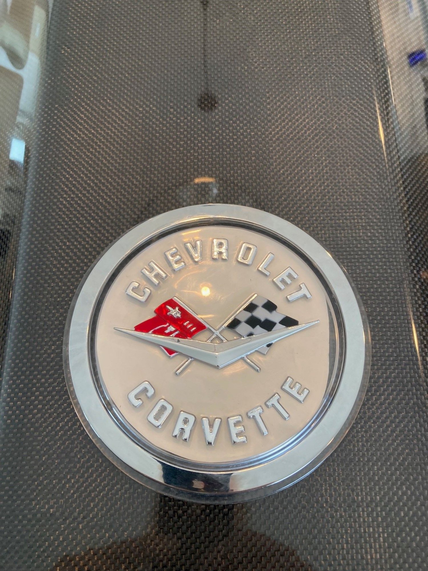

Yes, I agree. I've ordered a round emblem from a 1960 Corvette. I'll install it recessed, well at least that's the plan. Not exactly sure what the diameter is yet, but I'd say at least 4-5" so it's a big piece. I like the juxtaposition of the carbon with a trim piece as old as I am LOL. I've also found a place that does custom stainless trim pieces. Not 100% sure about those as of yet though.
On a different note, male mold is built, and resin came in last night. First layers of glass go on today.
This emblem will have a trim ring around it. Car is Artic White.

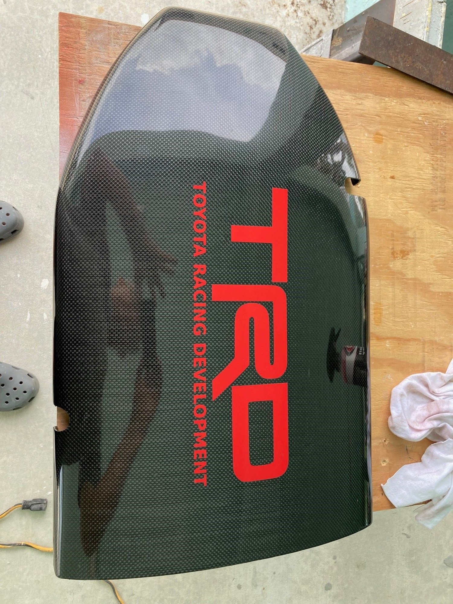

Couldn't agree more. The plastic milk crate look leaves a lot to be desired. This was the previous motor I built one for. GM 3.6L LFX.

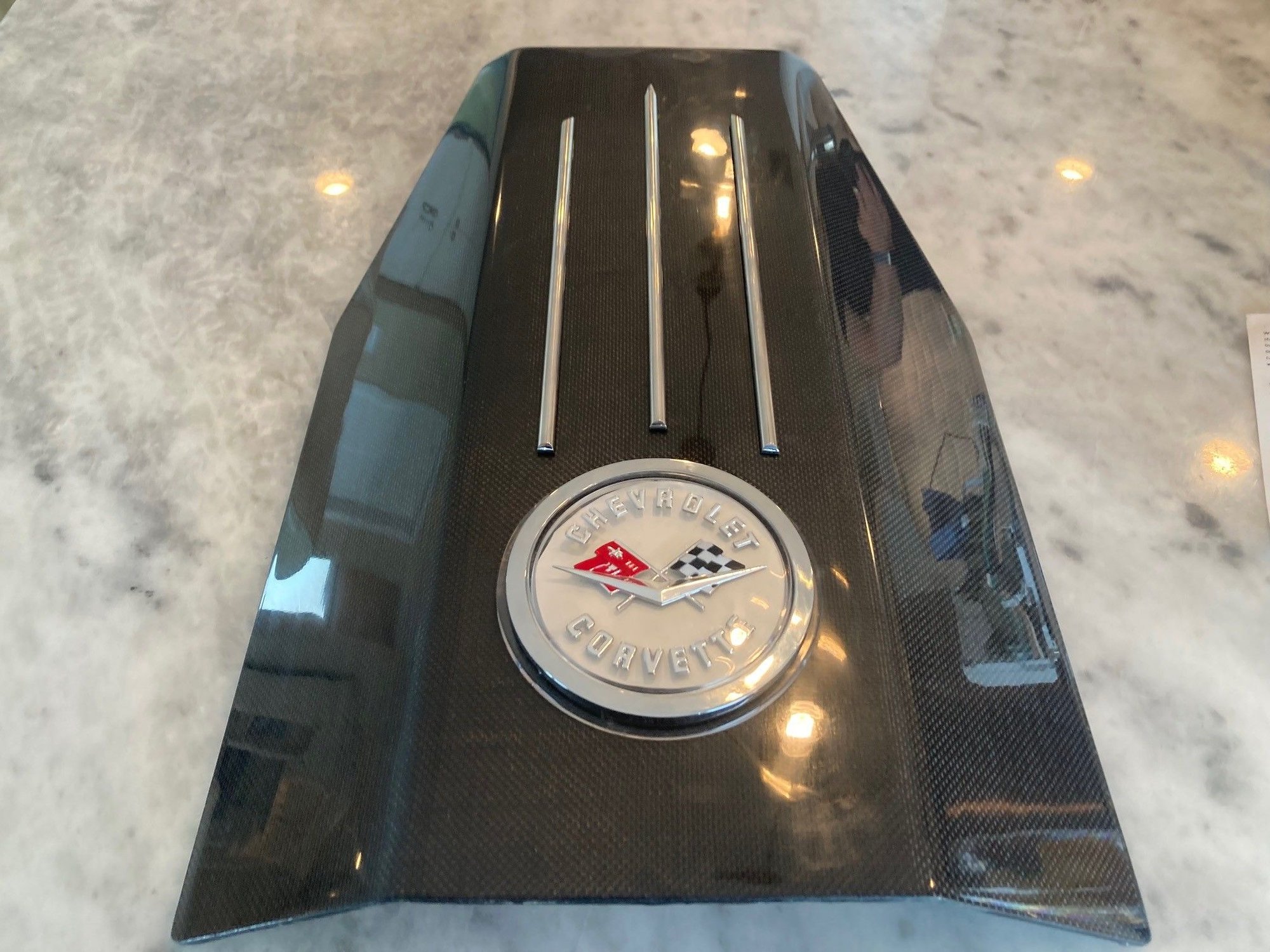

Work is progressing, Multiple layers of glass and carbon as a base and a final layer of carbon. This is first coat of resin over the final carbon layer so a bit rough. I did get the emblem in today. The good news is the size is perfect, the bad news is it's clear which doesn't really work. What you see is a piece of white construction paper behind it to give the contrast. I'm going to need to paint the backside white. Lots of sanding and more resin coming.

This coat of resin doesn't want to dry fully, it's been quite a few days and still smears a bit when I sand, and it needs to be block sanded before the next coat. This piece may be headed to the trash. I did order more supplies. Like my father used to say, 'nothing money won't fix' LOL.

I was able to save that piece as I ground off that last coat and installed another. A few more coats of surfboard resin, a lot of sanding and we're good. Stainless strips are on the way. Just need to figure out how to mount it.

Stainless strips came in today,,,, only a little clean up and mounting left.
