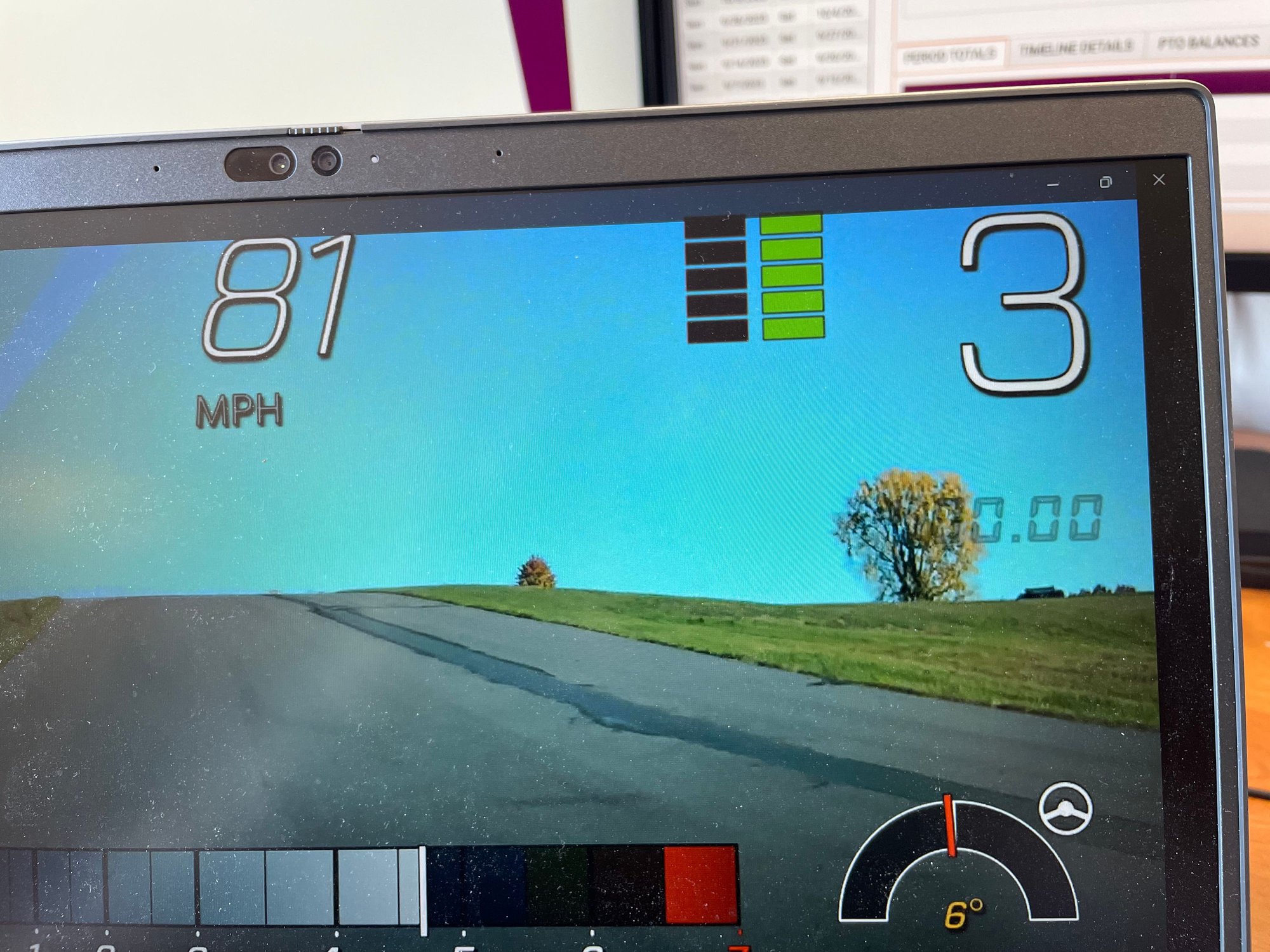

In track display on the right side of the display below the gear that I am in, there appears some kind of a timer option 00.00. Does anybody know what this is or how to activate it?
Secondly, I have had some issues where after few runs in autocross I try to turn on the PDR and get a black screen. Sometimes after a few seconds it turns on, other times it doesn't. I have had this happen several times and it is always on a later run. It doesn't seem like this should be heat issue, but I am wondering if anybody else has experienced this/ if this is known issue. Thanks!

I've had the black screen show up at the track a few times. Randomly. Leaving the car off and the door open for at least 90 seconds has on occasion resolved the issue. The "clock" under the gear indication is the timer that will show up when on the track and you've scrolled to the performance tab on the DIC. You'll need to establish a start/finish. The owners manual and Youtube will help you out.

And lap delta also shows up
I think you need to have the track map file

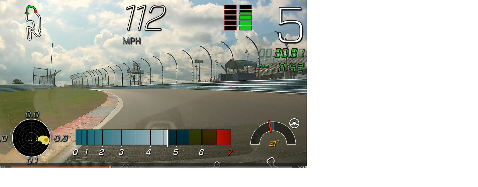

You mentioned autocross. You have to be on a closed loop "circuit" for the lap time and delta time information to show up. On an open layout such as an autocross (no single distinct start line) you won't get any data there.

The Delta only shows on Closed loop track. BUT when you have a autocross/ open loop saved (different starting and finishing lines) I saved some of my favorite roads like that. it will give you a time when you cross the finishing mark. You can actually see the wording change on the PDR when you cross the starting line, it says something like "in progress" under the track name you selected. then when you cross finishing line, it shows you the time on right. I have never tried doing the same road again. will save one in my hood and do it a second time and see.,

We are not the same at autocross then. I get 3 runs for a National level course and I'm not giving a run away to hit the button at the start and finish. Here's a typical large event course... no way I'm touching the screen as I launch or as I'm accelerating through the finish. (Yes, I know I ran on the rev limiter a LOT but I had tried shifting 2-3-2 on the course and it wasn't quicker as it screwed up entry to the next corner each time)
