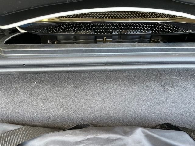

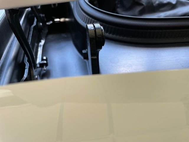

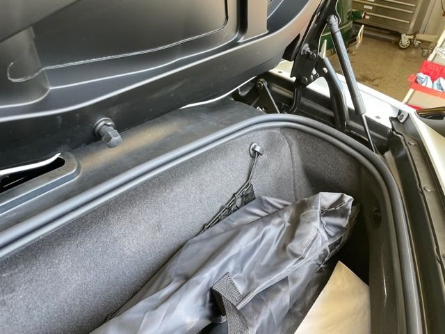

Is the trunk airtight? Seems to me that in general, trunks, or any enclosed space that is in the sun can get not just to ambient air temperature, but hotter than ambient temperature, just from the infrared component of sunlight that is absorbed by the surface (or passes through glass) of the enclosure then transmitted to the interior space (like your attic space for example). Lots of surfaces will get much, much hotter than ambient air temperature in sunlight. The surrounding heat from the exhaust on the sides or below the trunk enclosure just contributes to that both from convection of hot air around the trunk, as well as the infrared heating much like sunlight on the trunk lid. White will reflect some back. A black trunk or car with a black top will get extra hot. Doesnt the shiny part of the insulation reflect the IR heat back some? A good way to alleviate the heating for enclosed spaces (like your attic) is to allow a little airflow. Visibly, the trunk looks well sealed but there may be an opening through where the latch is. I any case, I attached some photos showing how heat (or air) from the engine vent on the HTC could be circulating around the top of the trunk, around the seal. I am not saying it goes into the trunk, and I am not saying whether or not is airflow would add to the heat, or carry some away - just noting that this airflow is possible. You can see in the first photo that the rear landau cover vent is open to that space around the trunk. This is also where water will enter between the landau cover and the trunk lid. The water flows around the said, as you can see in the second photo, then down toward where the trunk pneumatic cylinders attach and out the rear vent (apparently). Since the landau vent opens to that space, it possible that both air (hot air?) and water will flow around the gasket on the trunk top. I was trying to see if there is already existing ventilation in the actual trunk but so far I did not see that.
It appears that the vent opens in the space that surrounds the trunk gasket. Water will also come in here, though the gap between the landau cover and the trunk lid.
Water and air can flow along to the left and right sides of the trunk/trunk gasket, and down in to the space where the pneumatic cylinder attaches.
You see daylight toward the back of the car - this looking past the pneumatic cylinder hinge and out through the rear vent of the car. I think this is the path for water flow but will also allow air to flow out as well.

I think the trunk must be vented in some way. Otherwise it would be hard to close. In the same way the cabin is vented so the doors close without popping our ears, or flexing the side windows.
