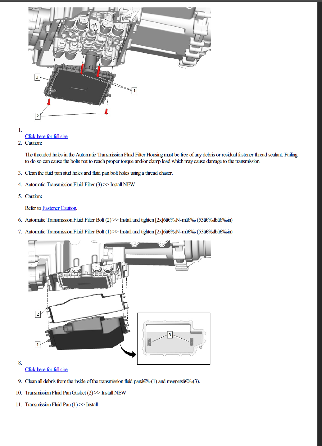

That's right - the Owner's Manual does not explicitly say anything about that internal filter. But it does call for a transmission fluid filter change at 3 years or 45000 miles or when the life monitor says so. The procedure I found in the Service Manual appears to include removing and cleaning the pan (there are two magnets in it), and removing and replacing the internal filter. The procedure is also actually listed as a Maintenance Item in the Service Manual. And that is the reason I am wondering what the service department actually does.
As for the internal filter being "lifetime" - as far as I know, that was a statement made in an automotive review article of some kind. I can't find that right now - but I think RKCRLR found it and posted a link to it. But I don't find it in the 2020 Service Manual, and in fact it has a procedure for changing it. I'm not really insisting that it is supposed to be changed - I am asking what is actually done when folks take the car in for a routine Transmission Fluid change. Edit: See post 10 - the "fill procedure" actually includes both drain and fill, and does not call for removal of the pan, nor replacement of the filter.

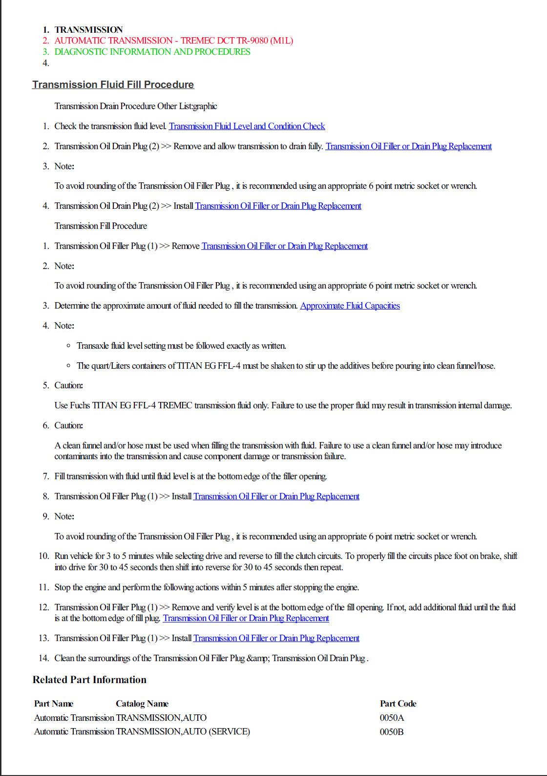

Here is the normal fill procedure, from the 2020 Service Manual. That part about shaking the fluid to stir up the additives is interesting. It does call for running the engine and rechecking the level. Edit: I should also add, although this procedure is call "fill procedure", it actually includes both draining and filling - and that suggests that it is done without removing the pan and replacing the internal filter.
Perfect. Thank you!
