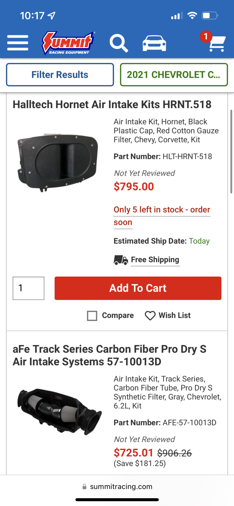

Pretty good price on the AWE track dry intake right now. I was going to go Halltech but this price makes it tough. Stinks it’s two weeks out or more tho. Best price I’ve seen on the Awe shipped for less then $800 with tax.
