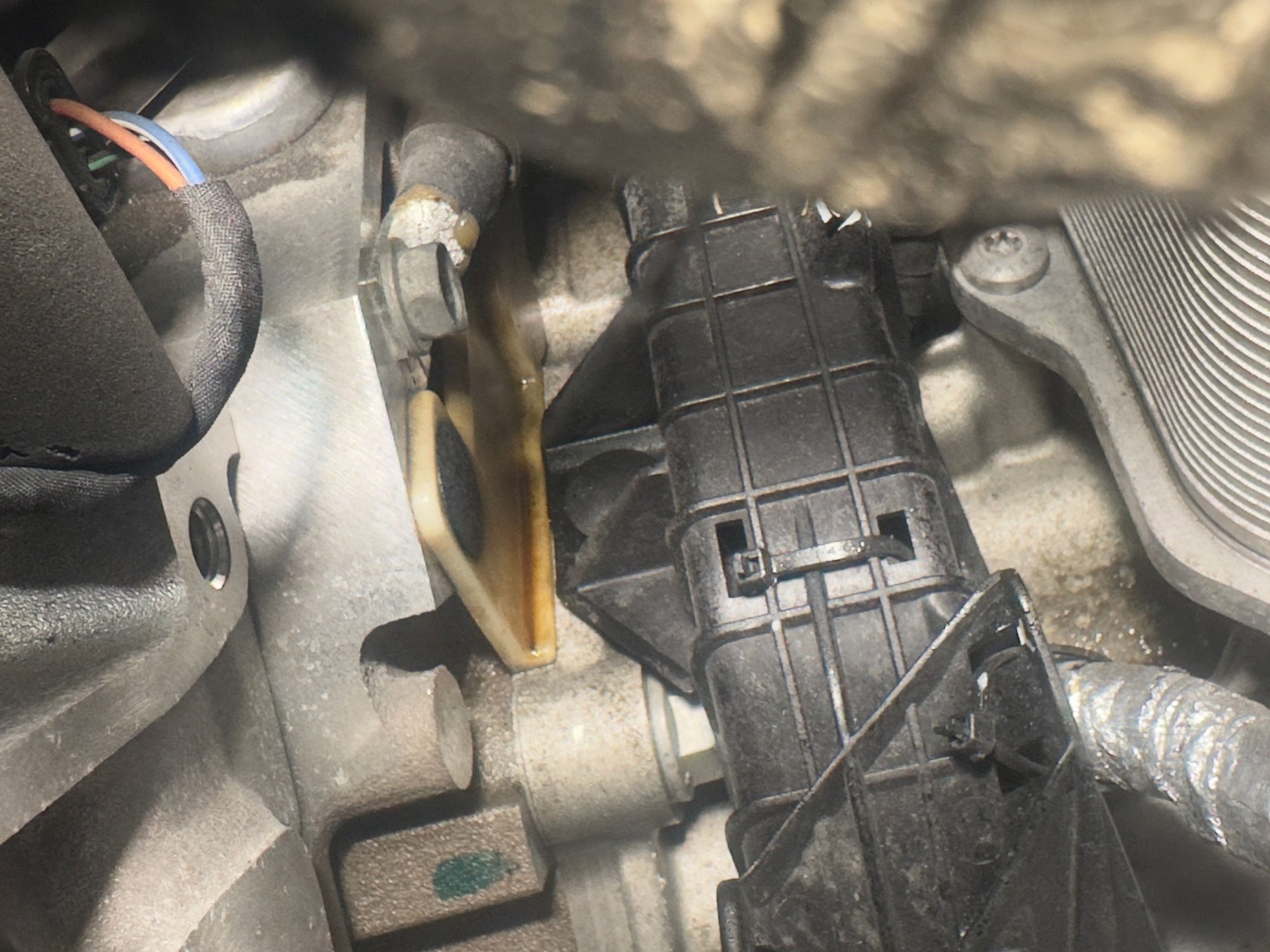

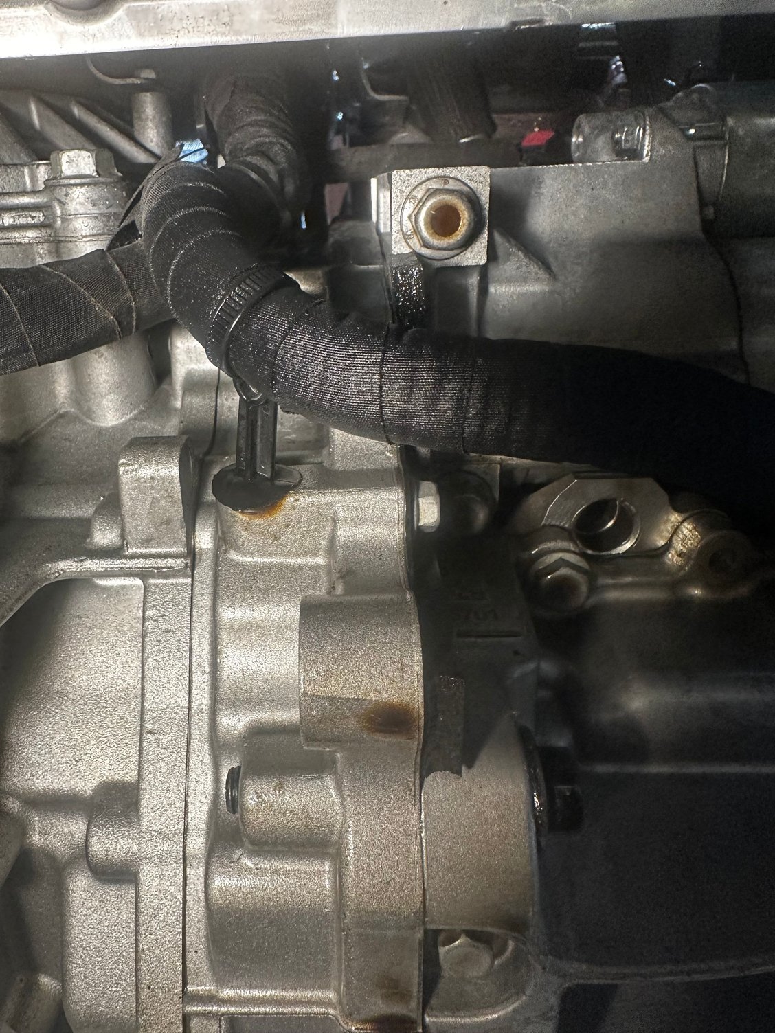

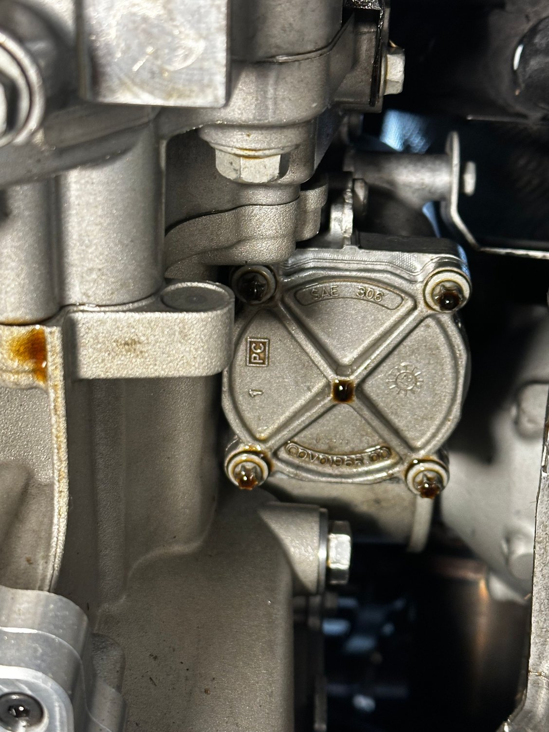

Thank you guys for the suggestions. Car still fires up for unloading and oil pressure is great. Doesn’t seem to be any obvious leaks when running under no load.Here’s some picture. Curious if it isn’t a rear engine seal based on what seems like the point of origin front the first picture. But there’s oil on top side seen below. I assume that would still be the problem for it has to sling or forced out in multiple areas. I have seen a few cases on the C8 where this has happen and curious if it isn’t high crankcase pressure or just a simple failure.
Below you see oil on the left all over that white plastic portion and then some puddled right next to the right side of the wiring harness and DCT cooler
