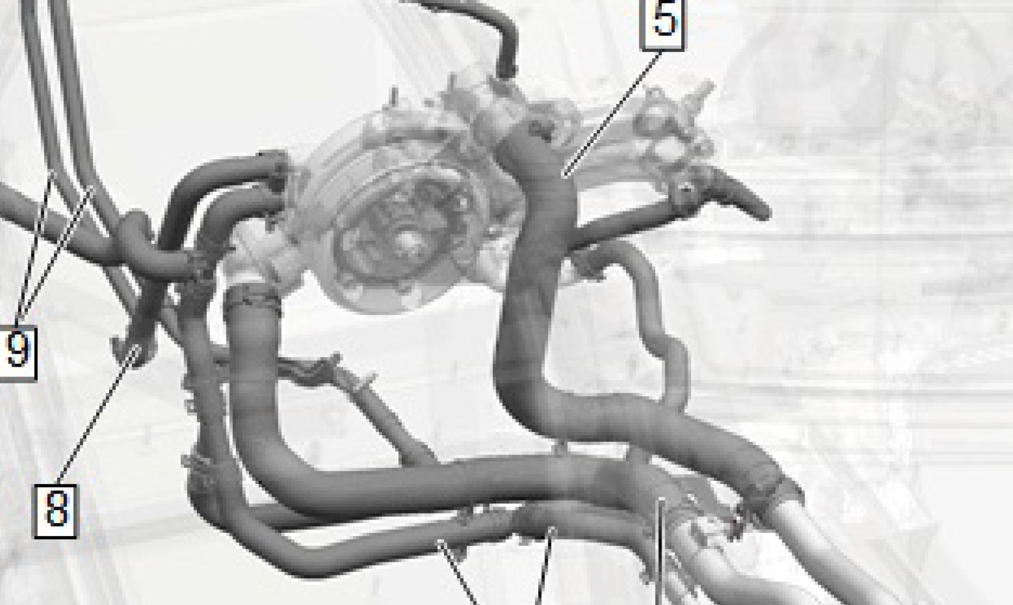

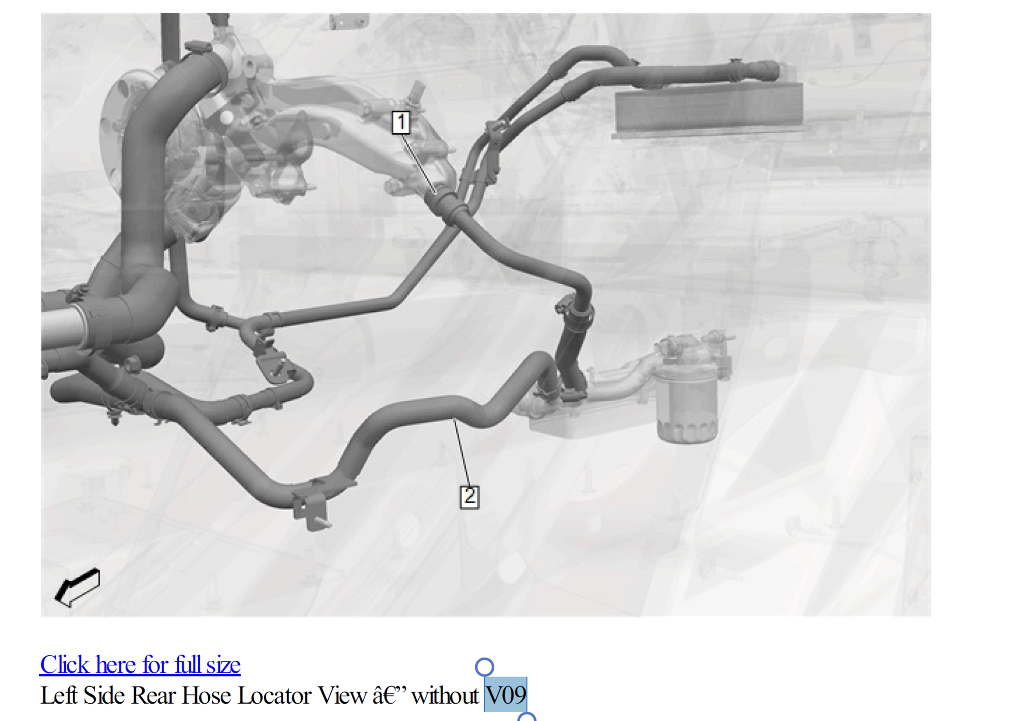

This is very interesting, and enlightening. The water pump would be a logical place, if it weren't completely blocked by the oil tank. Not being a mechanic, I can't help but wonder why it couldn't be placed near the radiator, since all the coolant passes through there, or in one of the lines leading to or from there. Sometimes it seems like things are placed in a position without much thought given to future maintenance.

Earlier I said its located in the "normal place". But that was ambiguous - since normal is subject to interpretation. Its located on water pump, just above what is called the water pump outlet pipe that is pushing water to the engine oil cooler. I think I mentioned before there could be one more if you have Z51, and a third one if you have the overseas V09 option. But I think the one of interest here is the one on the water pump.
So...in a earlier conventional engine, vintage engine like the Chevy 283, the temperature sensor is located in the water jacket on the cast iron intake manifold on top of the engine. It would be nice if they could have mounted the temperature sensor on the C8 intake plenum, but unfortunately they can't. The intake plenum for the C8 Stingray is plastic (or composite actually). I don't think there is a water jacket there - looking at images in the Service Manual I don't see evidence of that. So, the temperature sensor can't to there. Instead they put it on water pump, which might have been accessible, except the oil tank completely covers it. The engine obviously has a water jacket, but I'm not sure where they could have put it that would be accessible without removal of the engine. The other two sensors, when they are present, are in the coolant lines and I think are accessible without engine removal.
SBC [350 etc ] had the unit in the left side head too but all in all wrenching for 55 years on many things the sending units were not that common on any car going bad . .....bottom line is lets make a sacrifice to the fire gods gm isn't sitting on a batch of these lil time bombs .....like their 60's motor mounts . Hey andy is the belt correct on your 283 pulley ,photo shows it deep in the groove

...... Not being a mechanic, I can't help but wonder why it couldn't be placed near the radiator, since all the coolant passes through there, or in one of the lines leading to or from there. ........
I can only speculate about that. But, little or no coolant flows through the radiator until the thermostat opens. I think they want to measure temperature in or near the block. I do not understand the coolant flow paths in this beast. They are complex with multiple lines and and thermostats. And blow up of the water pump manifold also looks like that may be internally complex. I think (this is the speculation part) that there might be some coolant flow in the area where the sensor is located before the thermostat(s) open. That does not mean it couldn't have been put in a more accessible location.
