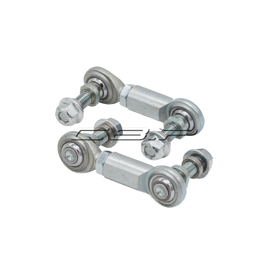

I've just ran into these, and they look much more compact than Eibach endlinks! I ordered a set and next time when I set the heights, I'll give them a shot:
https://c8performance.com/products/s...endlinks-front
Old May 30, 2026 | 03:28 PM
  #537
mikegr's Avatar
mikegr
Joined: Jul 2023
Posts: 856
Likes: 423
From: Ma
Those are perfect! no more clearance issues with the JRI coilovers....

Agreed! They look like OEMs, but adjustable; excellent!

Sway bar: I also moved the sway bar setting to 40% stiffer from 70% stiffer. My test with the stiffer setting was inconclusive at the track, which was further complicated with traffic and tires running out of steam. That said, I have a feeling that it might have gotten a bit too much with these strong shocks, so I decided to dialit back and retry.
Overall handling: I think I'm getting close to an ideal setup. As such, in the next few events, instead of lap time vs. shock settings tuning, I will concentrate on my lines with the current available traction, which I think might unlock a few seconds since I've been used to staying conservative on some of the turns since the OEM shock was not giving me confidence in those turns, and I need to probe them again.

The hole you see the bolt on is the stiffer setting (70% stiffer than Z51) since it's closer to the bar, with less leverage on it. I moved it to the next hole, which is 40% stiffer than Z51.
