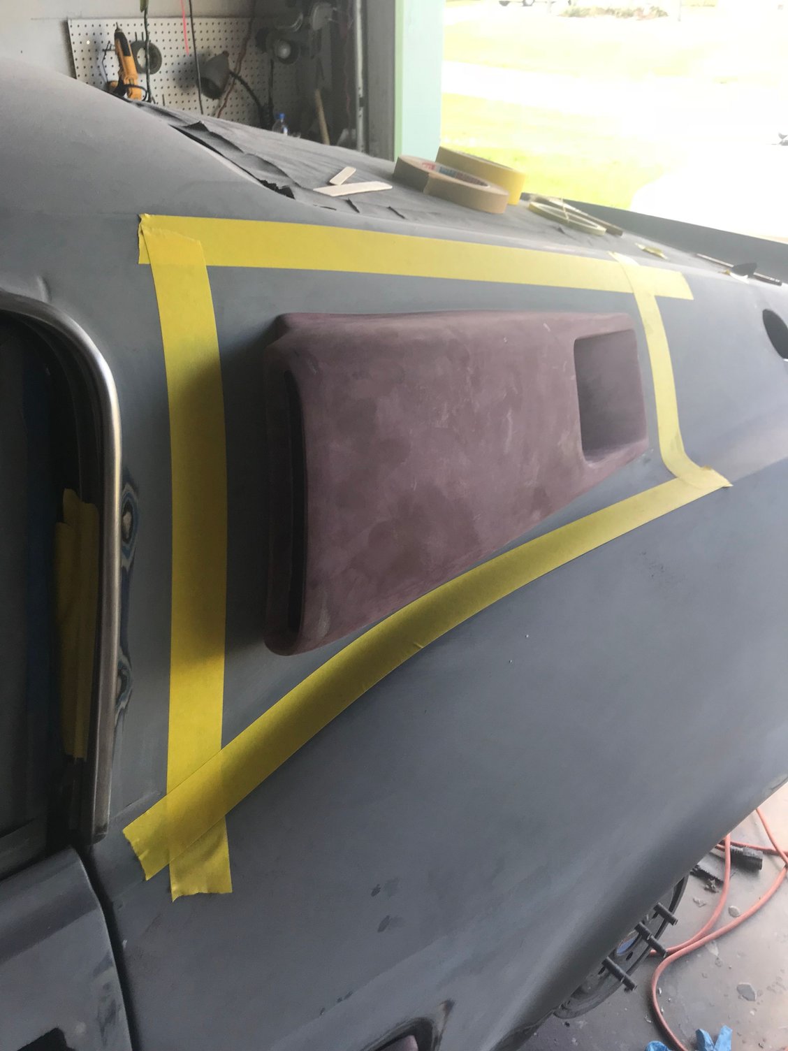

I laminated the side scoops on too, with epoxy and carbon fiber
When this cured, I made my own epoxy putty with epoxy resin, aerosil and micro balloons.

So if this was a fiberglass hood, and you wanted to install a fiberglass hood scoop, would laminating it on with epoxy and carbon fiber be appropriate? Please think outside the box here, I have a 1968 corvette that I will be working on after this. I’m sorry, but I don’t have the time right now to post long posts like you do, and that’s great, you are a great part of this community and love seeing what everyone is using to restore their vettes, I am open to any questions from anyone, and an sorry I don’t have the time right now to engage in toutorial, but again questions are welcome.

To get to your question about using carbon fiber. cloth No I would not due to it is major overfill and I do not use any cloth on the exterior surface...regardless what will cover it ( if anything) in the next step...and that also includes if you vacuum bagged your lamination
Also I doubt I would use and 2 part cartridge type epoxy adhesive also. I would use VPA and then do whatever laminating I needed after that on the outside and underside. You might think I am crazy but I have my reasons for not wanting to use the 2 part type adhesives in THAT specific area and type of custom job being performed.

Any laminate I do I use peel ply over top of it, it leaves a smooth keyed surface ready for primer. And I’m not sure what you are talking about cartridge adheasives? I took my epoxy resin and added micro. And Aerosil to make a fairing putty.

None of which apply in a side scoop or quarter panel extension, but I’m glad you brought this up. My c4 needs the floor board repaired, I would never do this with carbon fiber, one downside to carbon fiber, when it fails, it fails, and usually breaks apart in sharp pieces. The reason I used carbon in this case was to keep thickness buildup to a minimum, and avoid reshaping the whole side because the laminate was too high. I like to use peel ply on all my laminates also, and squeegee any excess epoxy.

That stuff you posted looks convenient, I have seen two part fairing epoxy putty’s that same mixing process. I would not personally use those, I am very picky when it comes to mixing epoxys, and just don’t trust those mixing nozzles to mix my epoxy.

Regardless if you buy SEM, LORD FUSOR, 3M, ASHLAND CHEMICALS 'Pliogrip' or DURAMIX. The intermix tubes work great and I have been using them for a very very long time and NO failure at all. I generally pup out about the length of the mix tube with the product once it starts to come out to make sure it is consistent...then begin to use it where I need it.
I can understand your concern but these companies have got it figured out and when having to deal with an approved adhesive....it is ONLY in their best interests to make sure they do have it right.
Anyway...the adhesives I mentioned are not wise to allow to be exposed so they would need to be covered due to solvent sensitivity.
So using them to bond on your 1/4 extensions and side scoop is quite 'do-able'. But the 'trick' is covering the seam in a product that will not telegraph that seam in time due to the steel and fiberglass extension are going to expand and contract at different rates and that seam can show up..

Another thing I like about making my own epoxy puttys/filler whatever you want to call it, is I already have some epoxy mixed for lamination, then can just pour a little epoxy in another cup to make the putty/filler. Any “structural adhesive” I use is methacrylate, usually just in places that can’t be prepped, this stuff will eat the grease off fiberglass and chemically etch. I rarely use it, but have had a few times it was the only option without taking the whole car apart.

The thickness on those scoops are a joke, and relying on the surface area of the edge to bond them would not be that strong, and I wasn’t going to add an inside flange to those parts just to get more surface area out of them. I did use a putty using aerosil and milled fiber to bond them, laminating right over the putty to avoid unnecessary sanding.
