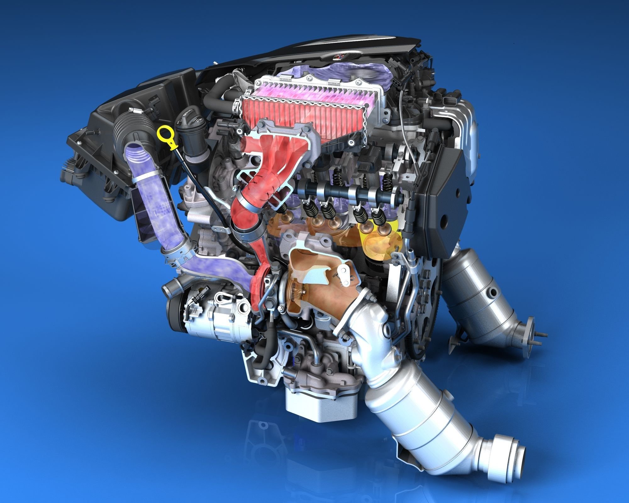

Not sure how new this information is, but was just reading about the new Cadillac CT6-V bi-turbo V8 engine and thought this might be a really nice offering in the C8. Very similar design to the Mercedes AMG 4.0 bi-turbo V8 in my C63S. Lightweight. Great torque. Hot-intake design with the turbos placed in the intake V area makes it super responsive.

No reason for a hot-V motor in a mid-engine. The responsiveness issue is not a factor of the Hot-V config, as the charge is still sent forward, through intercooler(s), and then intake. Piping can be done same length on a proper design turbo car with turbos right off side exhaust manifolds. All aids in cooling in a mid engine design, as it is harder to get the air moving above the motor, just behind the firewall.

And, the beauty of a Hot-V design in a mid-engine car is packaging, great airflow to/over the turbochargers (although they have water jackets for cooling) and everything is in close proximity to the intercoolers.

The mid-engine CAD drawings show a engine/transaxle cradle designed for a wide engine with the turbo's located on each side of the engine, not a HOT-V with the turbos located in the valley between the heads. In fact another CAD drawing actually shows a wide V8 with the turbo's located on each side of the engine on that engine/transaxle cradle.
