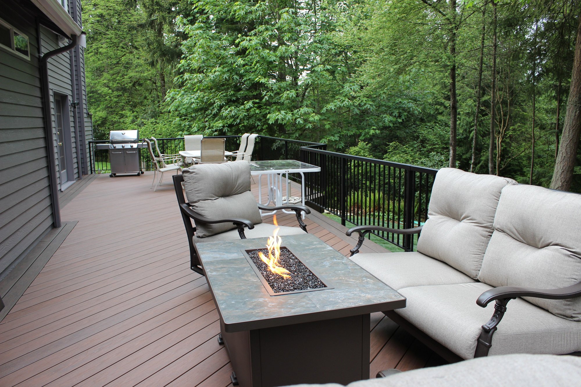

Phil .....Here is my deck just finished last week (well still working on on the skirting but otherwise done)
AZEK Decking (100% PVC but looks has very realistic wood look to it). Very low maintenance especially with the outside mount aluminum railing
Picture framed in darker color and decking run at 45 degrees. Framing is 12" OC. all hidden fasteners so no nail or screws showing!
