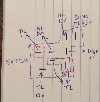

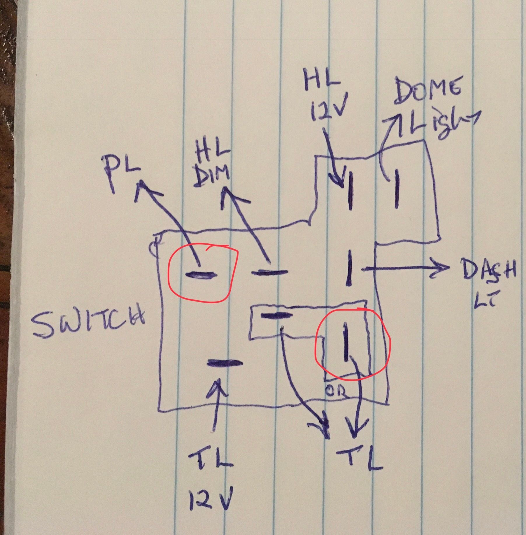

I just did this in my ‘64 when I was troubleshooting a tail light issue that required me to replace the headlight switch. I also installed relays to prevent the entire headlight load from going through the headlight switch.
