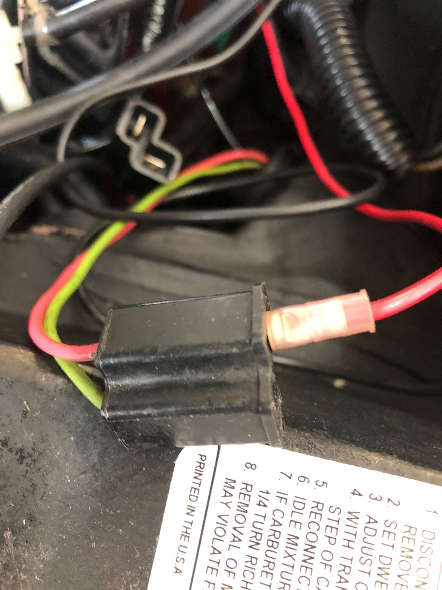

The small plug at the top of the picture is coming from the switch. The wire from the switch will reach the female plug, unless Bubba cut the wires. The plug provides 12 volts and ground when the ignition is on. That why my car had the electric choke connected to the plug.
